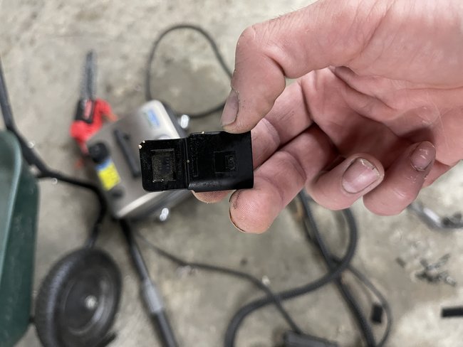

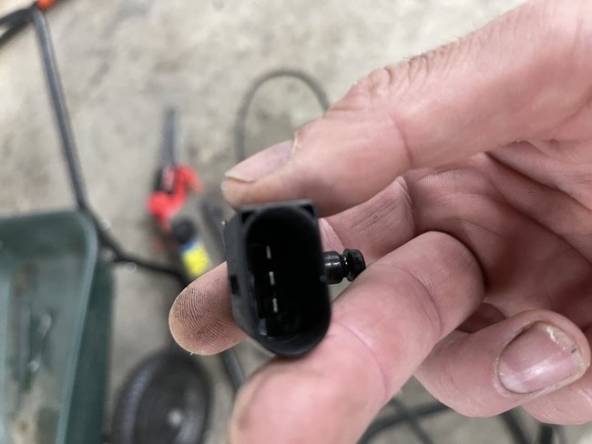

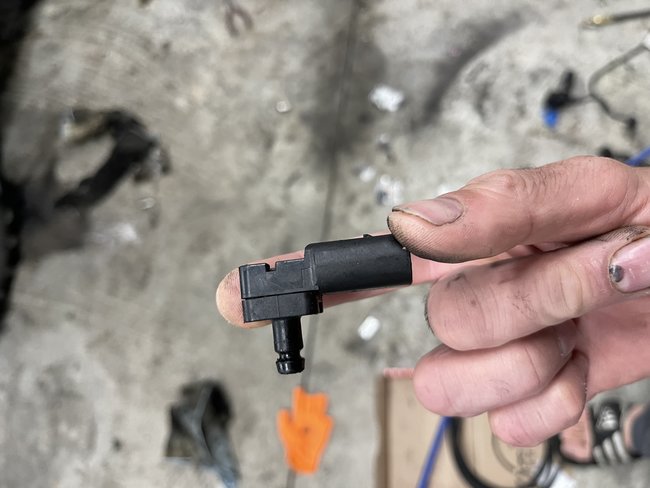

About to reinstall the intake manifold. There is a sensor on the top right of the intake that pops into a grommet which i have lost and i want to try to buy the grommet. Do you know what this sensor is? Temperature sensor maybe? This is a 335d diesel,

This is the Manifold Absolute Pressure Sensor (MAP).
The MAP sensor sends data to the ECM for it to control air fuel mixture.
You might have to purchase a new sensor as most of the time the grommet is not available by itself.

What does it do? If i just leave it hanging and start the car for now would i get a rough idle? I found the rubber piece online.

The MAP signals the ECM to help determine how much fuel to provide. So, it will likely run rough and trigger the check engine light.
