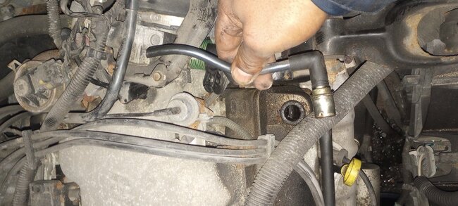

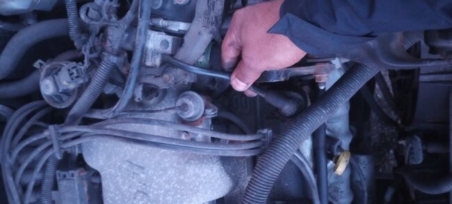

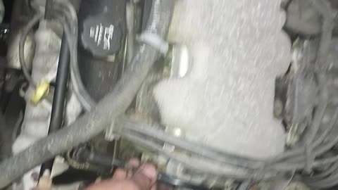

I broke this while trying to get to the coolant temperature sensor, what is it please so i can replace and repair? If so give me some tips on how to fix it, please hope it's easy?
Apr 6, 2023 at 5:37 PM
  • 110,194 POSTS
That is the PCV valve hose. Chances are it was brittle from heat and broke easily.
The vehicle will not run properly with that broken. It creates a large vacuum leak. It will idle rough or not at all.

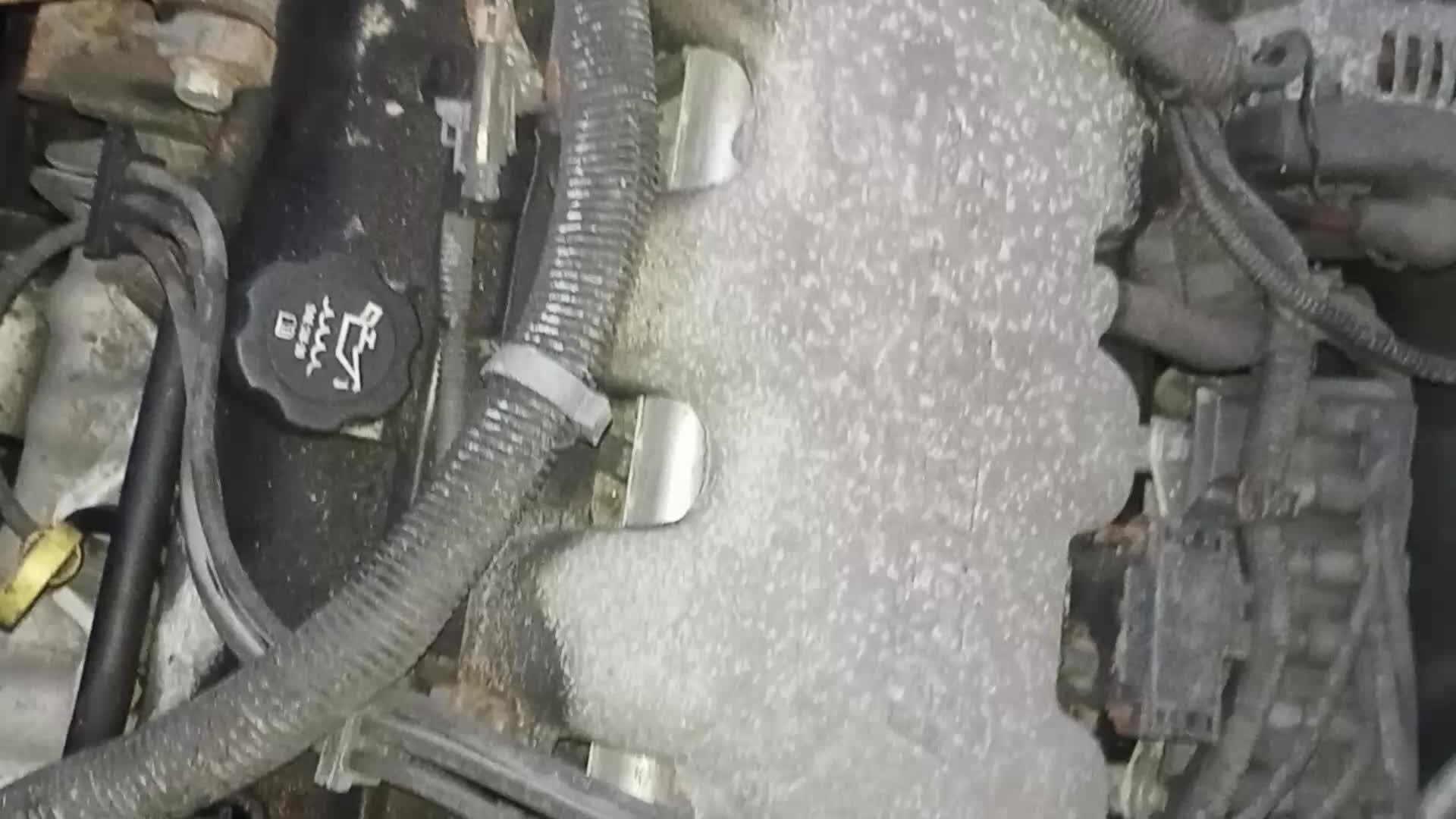

So, on the engine side where it broke, is there any hose left?

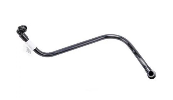

I attached a pic below of what I believe it is. I need confirmation of the engine size. It is a 3.1L V6?
Let me know. Also, does the pic I attached below appear to be the same part?
I will watch for your reply.
joe
See pic below.
Apr 6, 2023 at 11:33 PM
CP313
  • 19 POSTS
Yes, that is the piece, so it's the pc valve hose, is this easy to fix myself? I looked for the part online and what I found has bad reviews of people saying it lasts a month and then melts off and has to get replaced again. So, should I try and find one at the junkyard off another Buick or any suggestions? And yes, it's a 3.1.

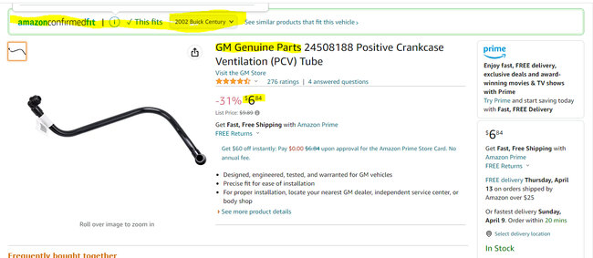

  • 110,194 POSTS

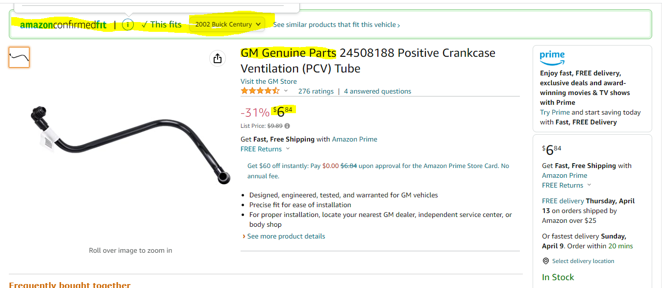

I wouldn't get a used one. They become very brittle. I'm not sure which you have looked at, but I found a factory OEM one, new, for under 7 dollars on Amazon.
I attached a pic below. Go to Amazon and look up the part. That is the one I would get. It appeared to have good reviews.
Let me know if this helps.
Take care and Happy Easter,
See pic below.

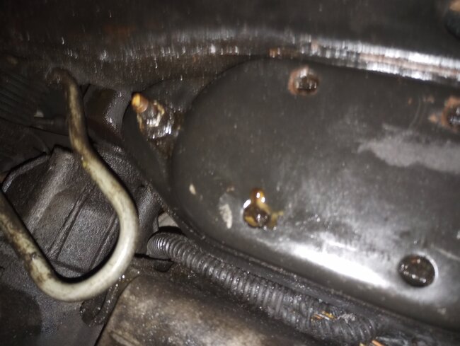

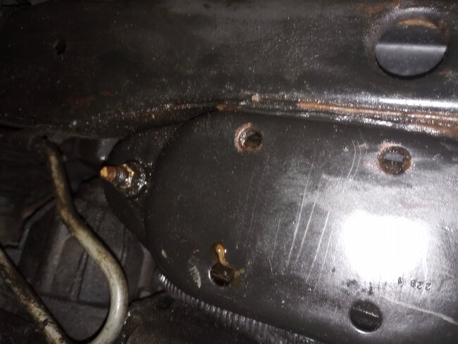

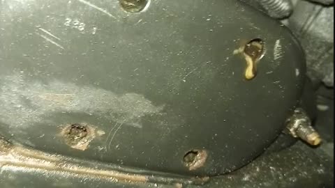

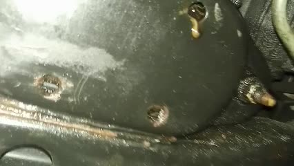

Lol, no, I was not looking at the washer fluid, I flushed all the blue coolant out and used a universal yellow and I bled it, heats working great now my question is do you know what this is leaking from under the car? Looks like oil. If you have any ideas if greatly appreciate it.
Apr 11, 2023 at 1:22 PM
  • 110,194 POSTS
That looks like oil mixed with coolant. Do you have oil leaking as well? Also, there are no coolant leaks, correct?
