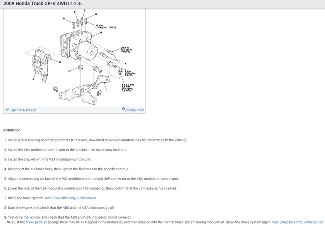

I have a part that is beginning to rust in my vehicle listed above and I do not know what it is to replace it.
May 31, 2022 at 2:18 AM
SQM
  • 6,383 POSTS

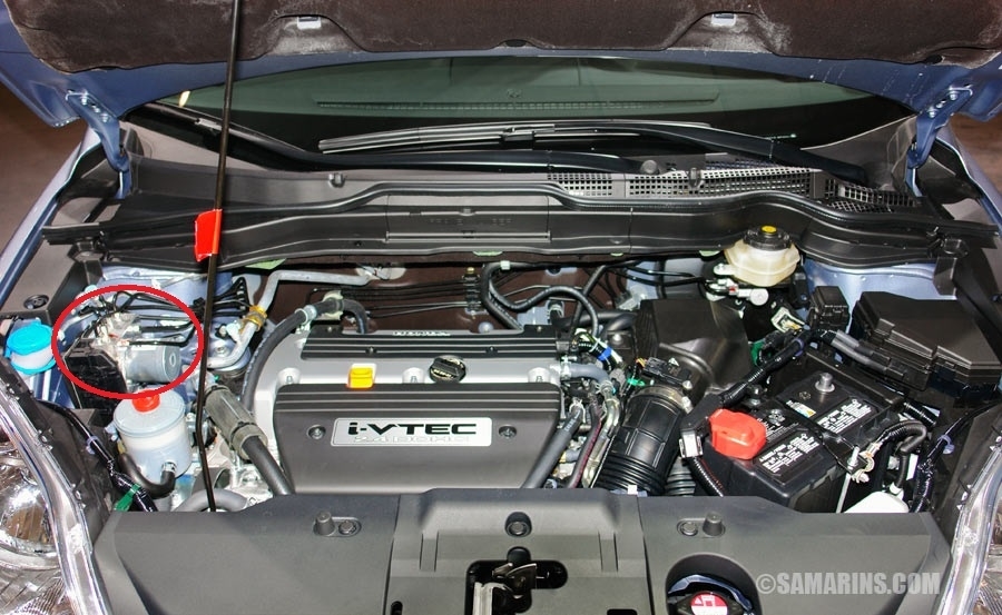

That is the hydraulic control assembly for the ABS system.
It is likely just surface corrosion.
If you would upload a close-up picture of the item so we can see the extent of the corrosion.

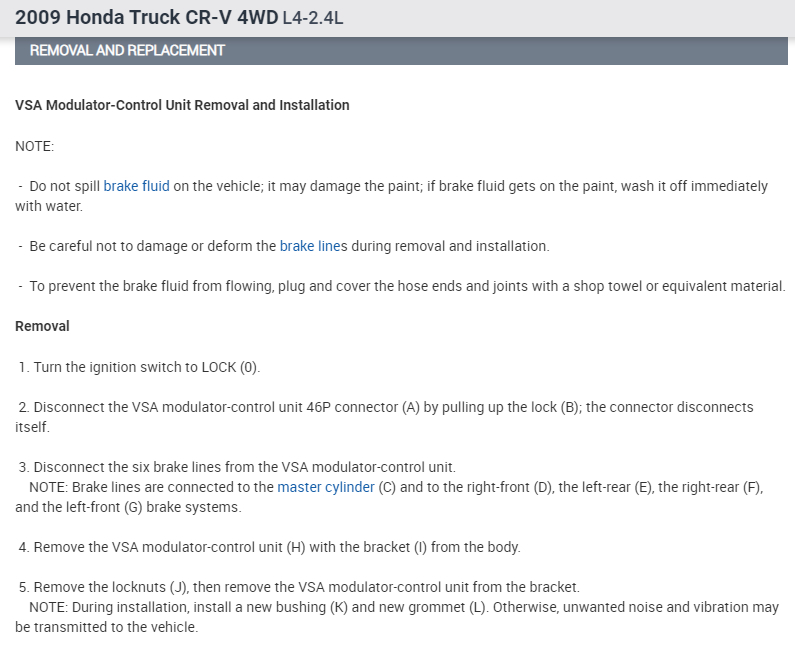

That module does not get replaced unless there is an issue with the ABS system, or it is leaking fluid.

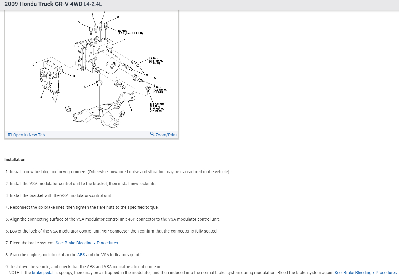

I have attached diagrams below for your reference.
Let me know of any questions.
