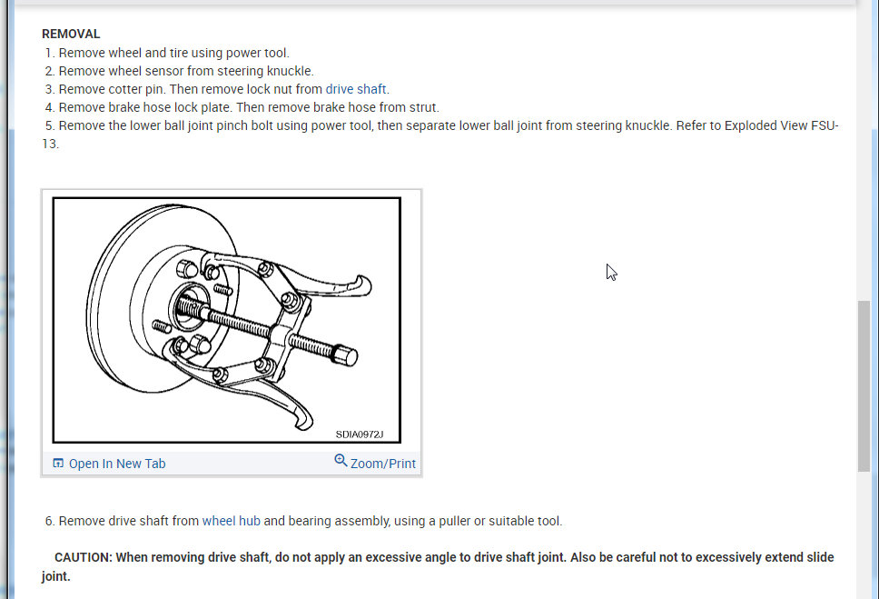

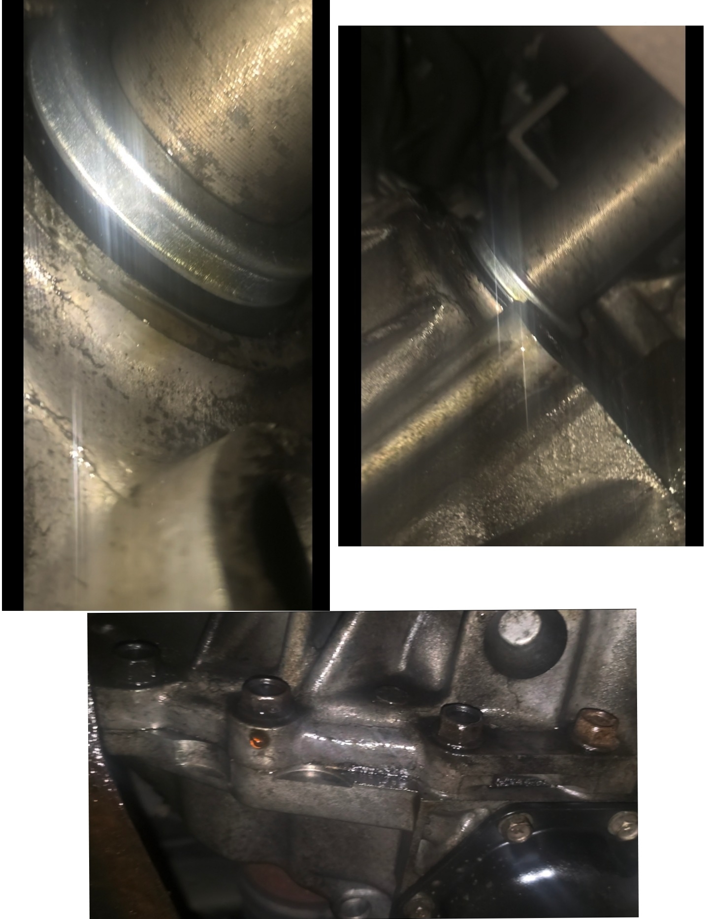

I need to replace the transmission CV seal and I want to do it myself can you help me please?
Mar 7, 2021 at 8:14 AM
DUWHOP31
  • 153 POSTS
I only asked because my car (listed above) is leaking transmission fluid and i thought it was coming from that plate, but i actually think its coming from where the front axle connects to the transmission. What can I do to make it stop leaking?
Mar 9, 2021 at 9:19 AM

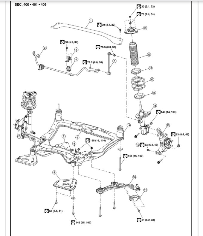

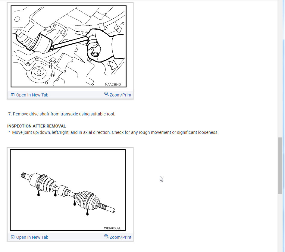

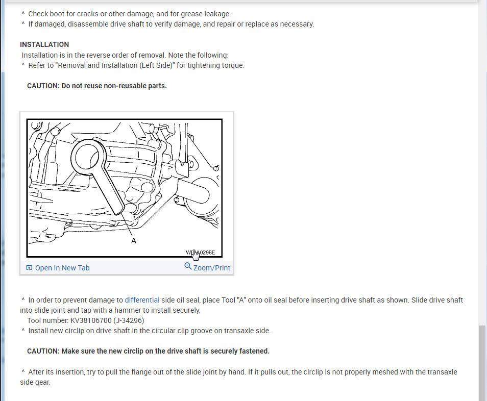

Yep. I agree that is looks like that is the leak. The only way to stop an axle seal is to replace it. That looks like the left side (driver) so I attached the process for replacing it. Let us know how you make out. Thanks
