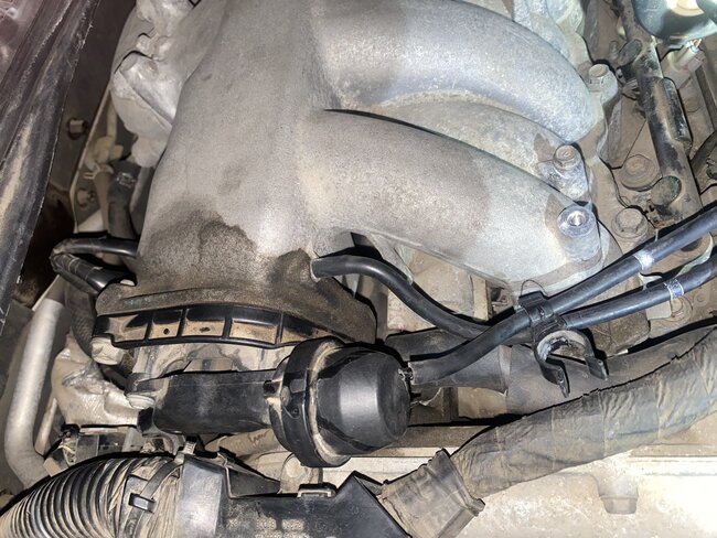

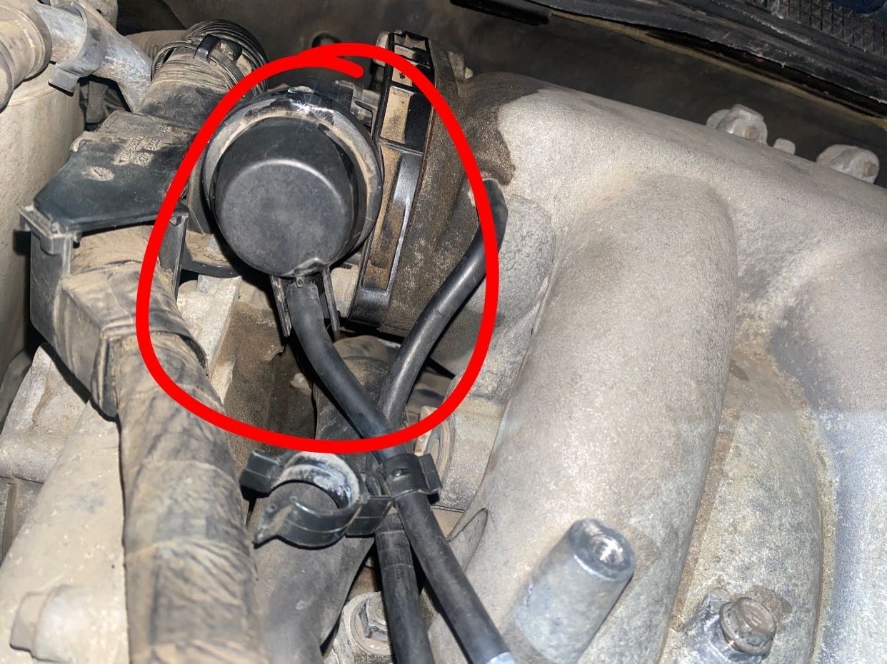

Hello, I have the car listed above SL model. As I’m changing the spark plugs, I noticed a little hose/tube broke off and I’m wondering what is it? Can I drive with this broken? It’s connected to something on the side of the intake manifold.

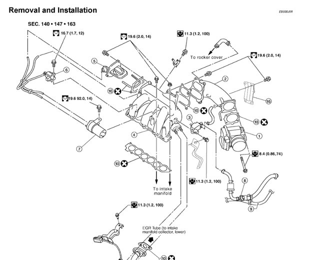

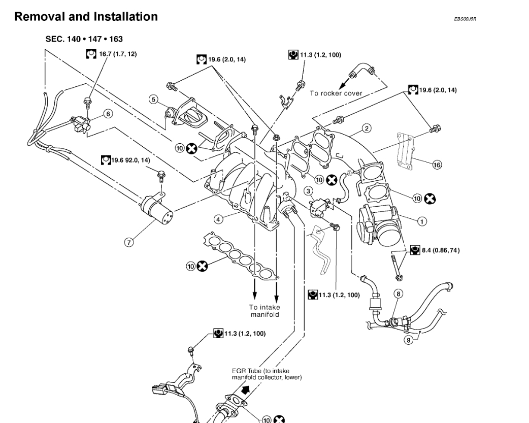

That part is used for the active intake runner controls. It is best to replace the part even though the engine will run it is not optimal. I have included how to change it out in the images below. Please let us know if you need anything else to get the problem fixed.

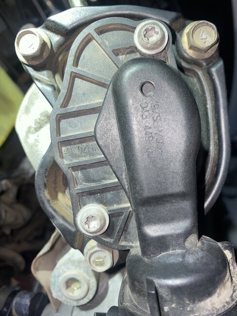

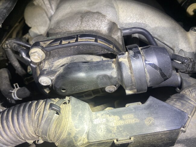

Here is a picture of what it broke off of, I tried to search up the numbers that are on this part. however, I still can’t find it anywhere.
May 10, 2023 at 6:24 AM
  • 55,740 POSTS
This part is dealer only, you must call the parts department for a replacement.
