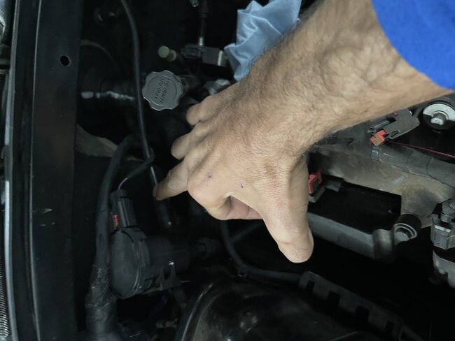

What is this hose connector on intake called?
2013 CHRYSLER 300
125,000 MILES • V8 • 2WD • AUTOMATIC
BHAMDOC1973
  • 2,007 POSTS

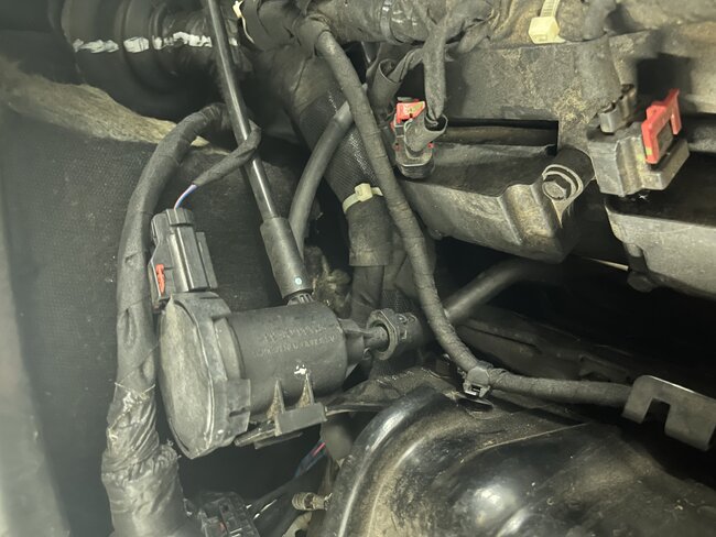

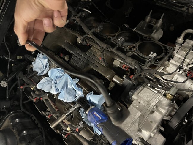

Broke while removing it, goes on top of intake and routes to this piece where my finger is pointing. Made off of plastic
Nov 10, 2022 at 7:01 AM
  • 55,433 POSTS
It looks like the crankcase breather tube or an EVAP line. It is tough to tell, do the lines from the valve head to the rear of the car?
Nov 11, 2022 at 2:11 AM
BHAMDOC1973
  • 2,007 POSTS
It's from top of the intake to the piece I am pointing to.
Nov 11, 2022 at 2:13 AM
BHAMDOC1973
  • 2,007 POSTS

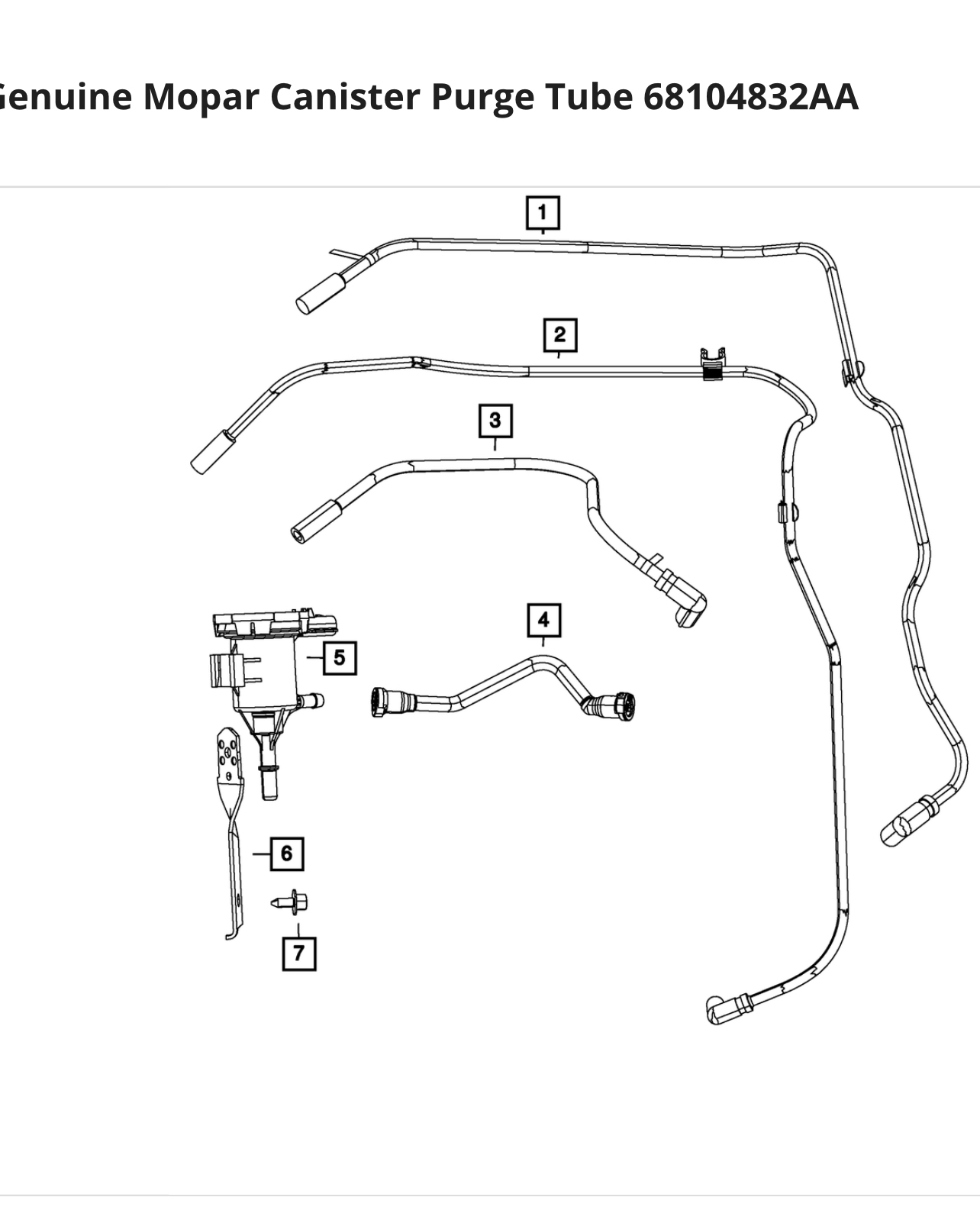

Purge line?
Nov 11, 2022 at 2:26 AM
BHAMDOC1973
  • 2,007 POSTS
#2 in diagram.
Nov 11, 2022 at 2:28 AM
  • 55,433 POSTS
Yep, that is a purge line for the EVAP system.
