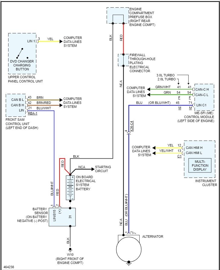

That error usually means that there is a problem in the charging system. That could be a bad battery, bad alternator, bad regulator or a problem in the control system. To find the actual problem you will want a scan tool to read the code(s) that should be stored relating to the charging system. That is because of the way that charging system operates using the various modules. You can start with a simple alternator test using a meter.

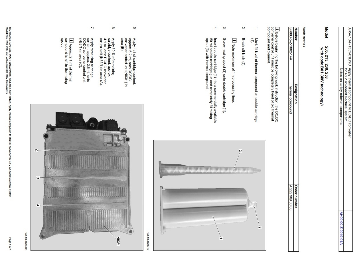

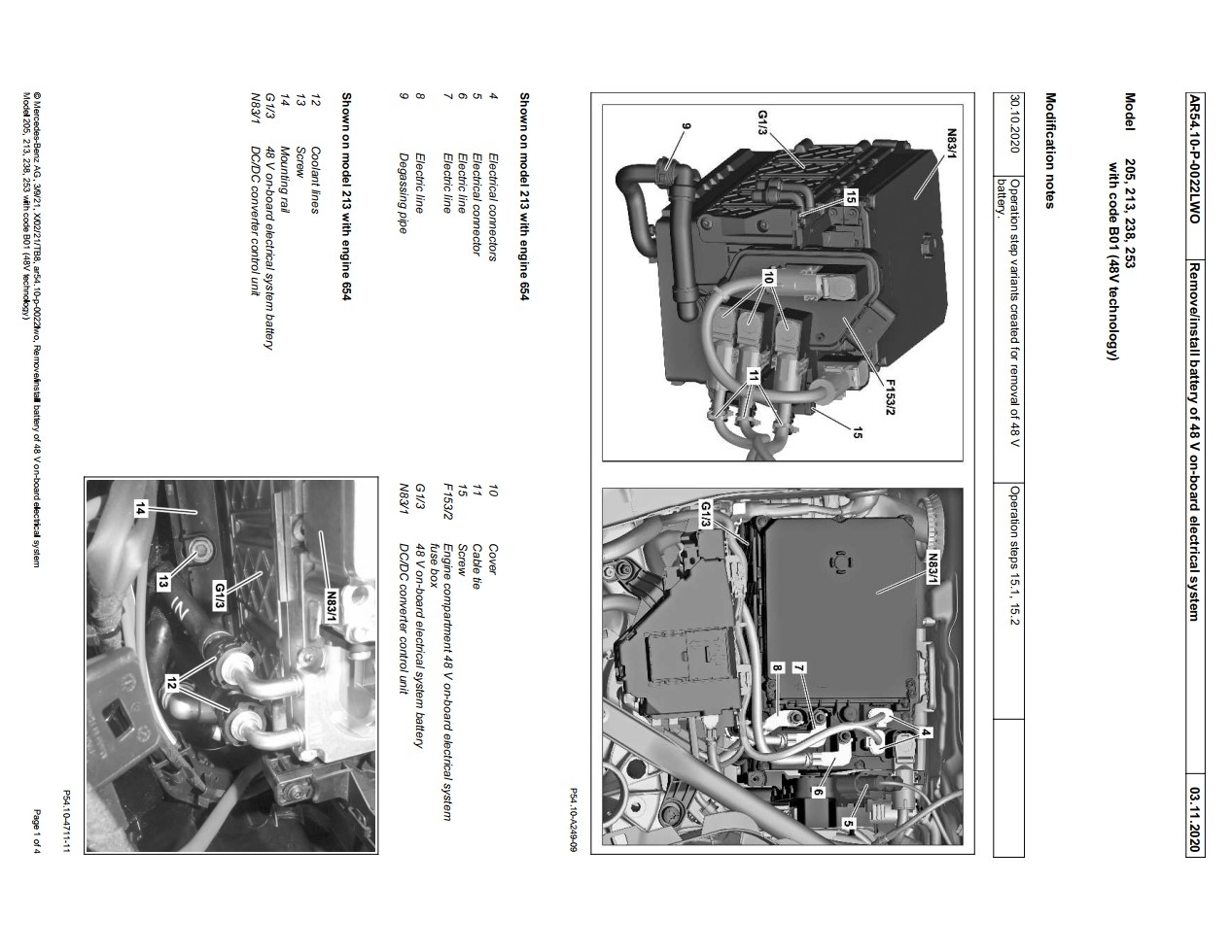

Yes, the aux 48-volt battery could do that if it is failing or its converter is going bad. These are the OE instructions for its replacement. The battery first and the converter that also gets removed second. Depending on the scan tool you might be able to read the voltage and the converter state using it, but many cannot read that data. Please let us know what happens.
