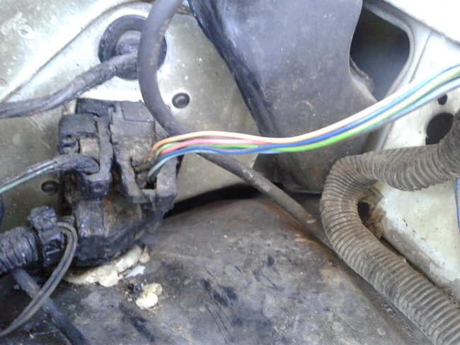

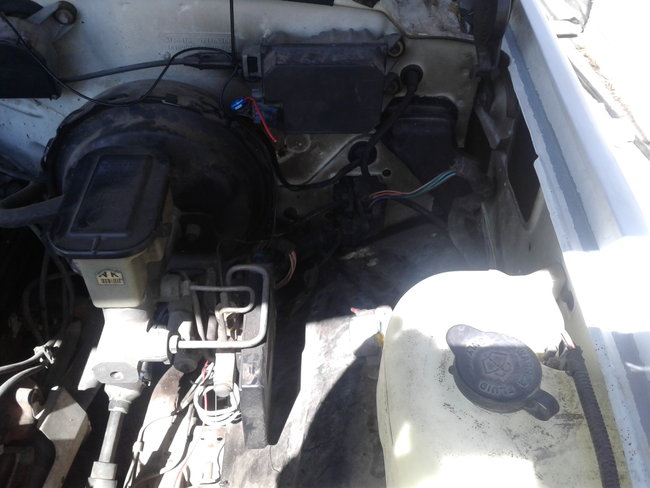

What is this black box on the firewall to the right of the master cylinder just above the wheel well?
1992 GMC TRUCK
200,000 MILES • 5.7L • V8 • 4WD • AUTOMATIC
CLIFF KEIPPER

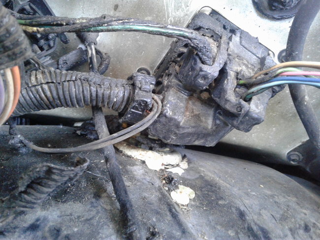

I have burnt wires all the way around it and the engine will not start.
Thanks for any help on this.
Jun 12, 2018 at 3:10 PM
Good afternoon.
It looks like a junction box of some sort. Can you post a couple more pictures closer and possibly open up the box? It looks like the ne nut may be the cover bolt.

There is no way I can see to open the box.

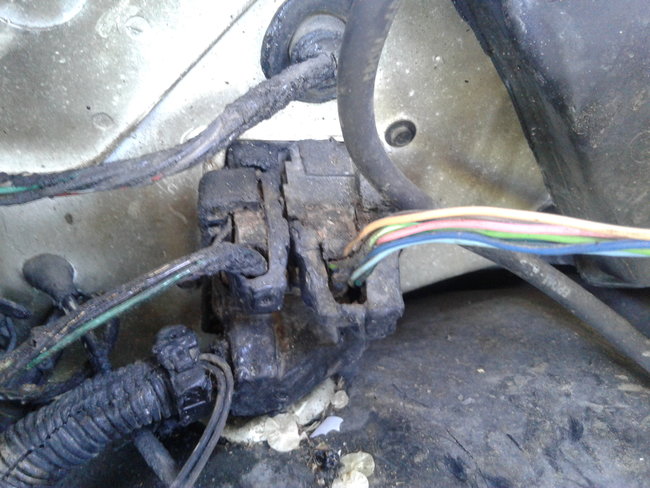

Thanks, much better.
That is the junction block that connects all the under-hood wiring to the interior. You need to remove the one bolt in the center. That will release the connector. It will pull out.
What happens is there may be bad connections that have caused high resistance and heat is the result and wires gt damaged. Remove the bulk head connector and inspect all the wire inside and the part from inside as well.

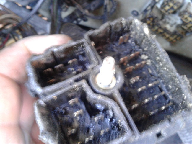

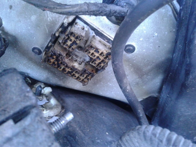

CLIFF KEIPPER
This is after taking the nut off.
Jun 12, 2018 at 3:51 PM
Yep, you have a real mess there. It looks like the junction block needs to be replaced.
You can go to a GM dealership parts and see if they still list the junction block parts. Ask them to check new old stock as well. That will check all over the country.
If not, then you will need to find a used one at a junk yard and change it.
That looks so bad that you cannot even replace just the pins. You need the connector.

Thanks for your help, it is sure appreciated. I think it is headed to the salvage yard.
