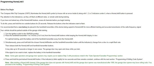

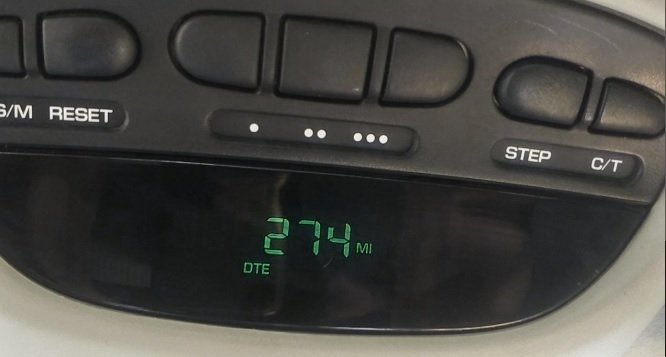

What are all these for? 1. US/M Reset 3. 4. 5. 6 Step 7 CT.
Tuesday, November 12th, 2019 AT 6:24 AM
3 Replies
MASTERWRENCH
  • 258 POSTS

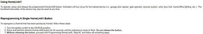

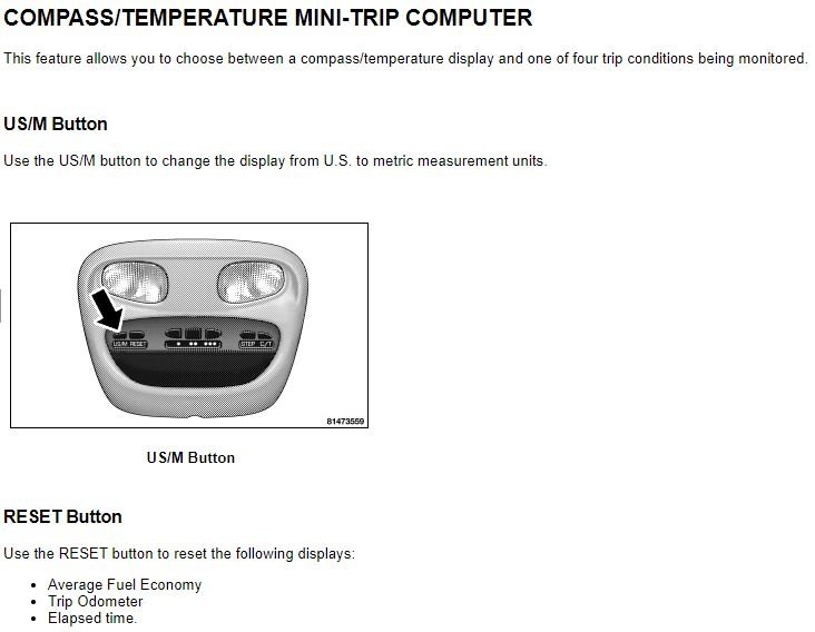

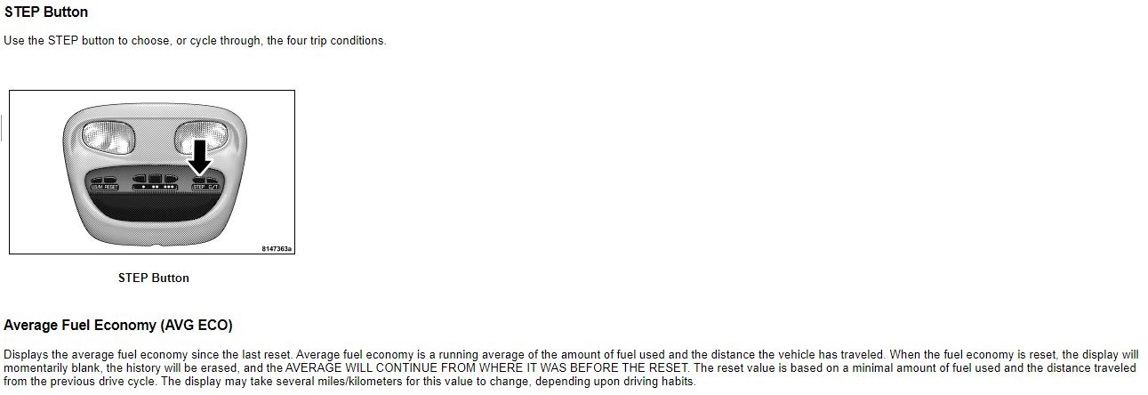

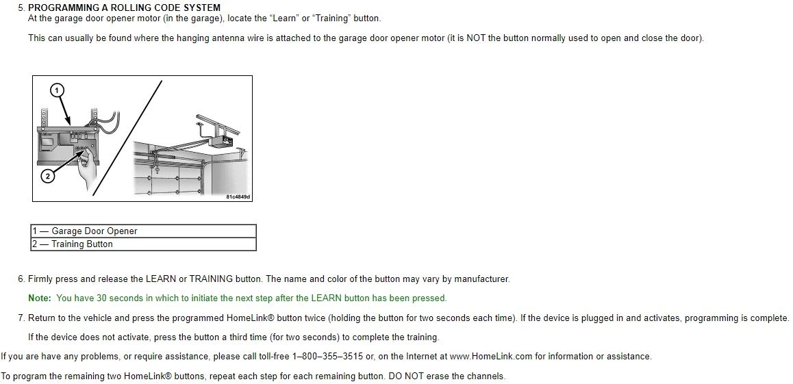

The US/M, Reset, Step and C/T buttons are used for controlling the display in the Mini Trip Computer. The three buttons in the center can be programmed to operate the garage door opener at you house. This system is referred to as HomeLink. See the attachments below for specific instructions on using these features.
