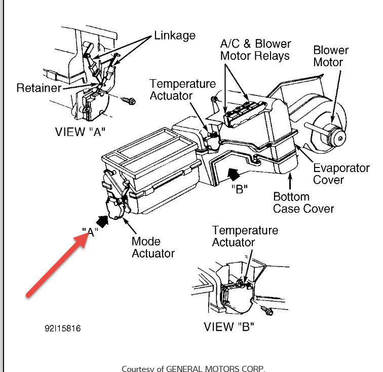

What would be causing my heater control panel not switching directions of flow? It was just working and I got it back from the shop and does not work.
Feb 15, 2017 at 10:56 PM
HMAC300
  • 48,601 POSTS
pull heater fuse inside truck with key on for sixty seconds it may reset the actuator. see picture. it is on driver's side by gas pedal. also, check maybe it is unplugged. See picture.
