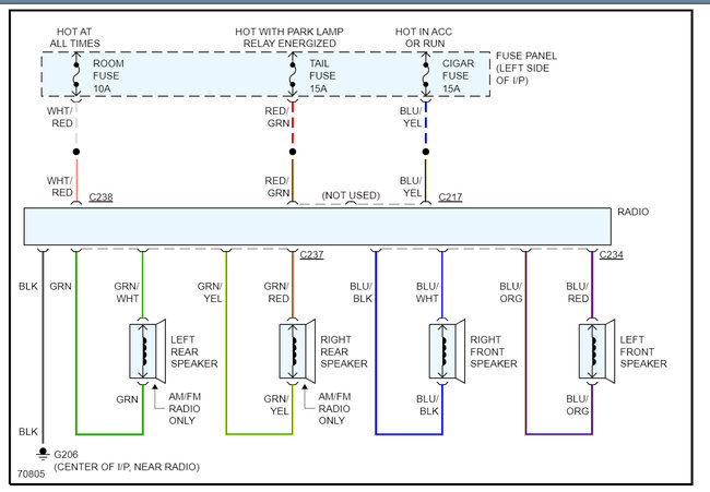

I don't know what colors go to what from the car to the car stereo I don't know which colors to connect together.

Here is the radio wiring diagram you requested, and I have included a guide to help test the connections.

Which is+ and which is -?

Negative is black, and positive is Wht/red, Red/grn and Blu/yel.
