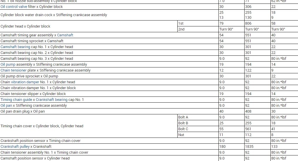

what is the torque for the camshaft bearing cap bolts?
2009 TOYOTA CAMRY
180,000 MILES • 2.4L • 4 CYL • 2WD • AUTOMATIC
ANGIE BENTLEY
i can't find out the right torque for the camshaft bearing cap bolts?
Nov 30, 2020 at 2:48 PM
BMDOUBLE
  • 1,139 POSTS
Here is what I found, along with a few other specs. Let us know if there is more info needed. Check out the diagrams (Below). Please let us know if you need anything else to get the problem fixed.
