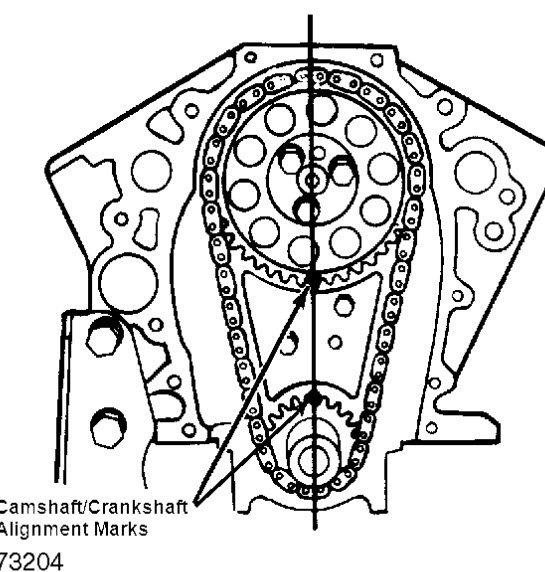

Bought the car the man thought the engine was locked up, but the timing chain had broken. What are the timing marks and will this motor bend a value if chain breaks?

no, it wont bend a valve. see picture for timing marks.
