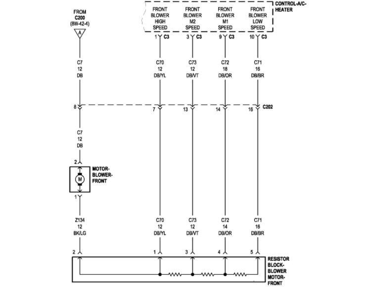

the AC is not blowing out air out air, the compressor magnets and the AC comes on but will not bring out air.

Do you mean the blower is not blowing any air through the vents?

Yes Sir, the blower not bringing any air from the vents.

okay, I am posting a wiring diagram for you. you need to check the fuse for the blower motor for power on both sides of the fuse.
check fuse 42 in the fuse block under the hood. that feeds the blower motor with the key on. check the dark blue wire at the blower for power with the key on.

Sorry was out of town just got back yesterday, tried the blue wire And fuss as advised still not working..

OK, does the blue wire have power with the key on???

Yes Sir
Mar 29, 2018 at 8:04 PM
OK, good
Check the other wire on the blower motor with it hooked up for power as well. if it has power the blower resistor is the issue.
If it does not have power, then the blower motor is bad.
