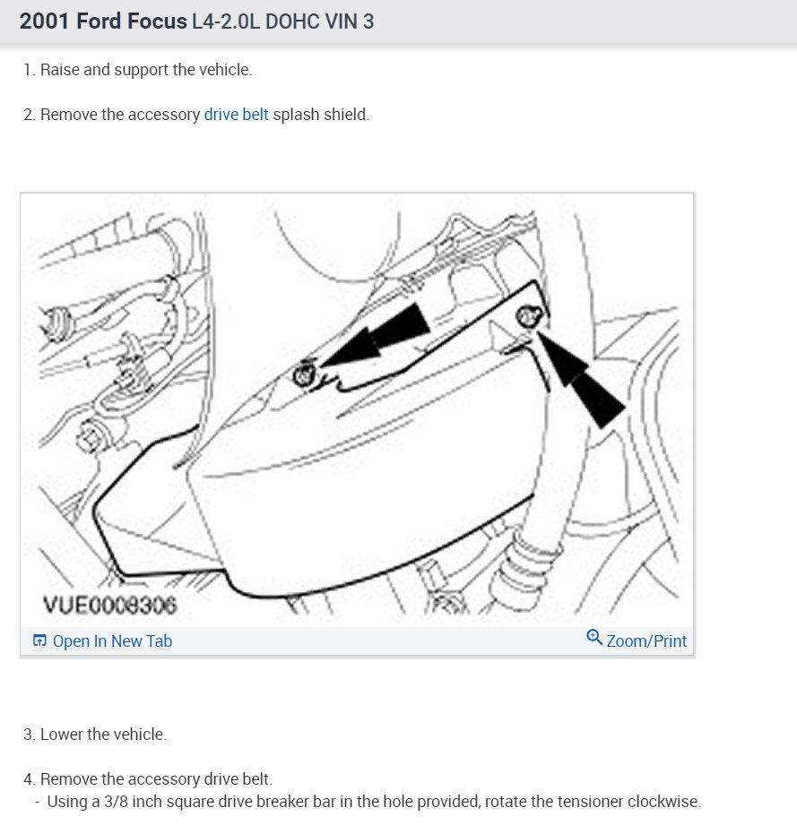

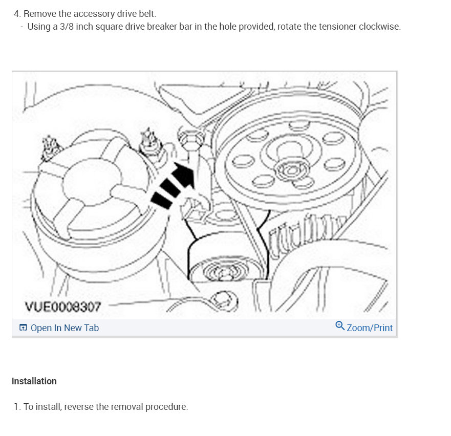

I don't know the appropriate number for the belt.
Sep 26, 2022 at 1:55 AM
  • 55,845 POSTS
Here is the part number for the belt and how to install it in the images below.
Serpentine Belt - F8RZ8620CE $49.11
This generic guide can help you with the steps as well:
This video can help as well:
https://youtu.be/AaSBaKQaYZs
Check out the images (below). Please let us know if you need anything else to get the problem fixed.
