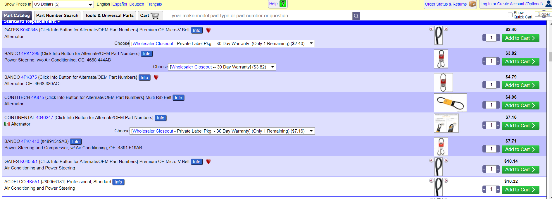

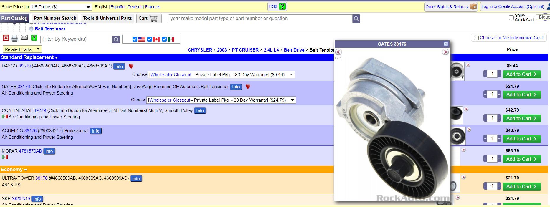

Good afternoon,
I attached the part number for the belt and tensioner from Rock Auto for you.

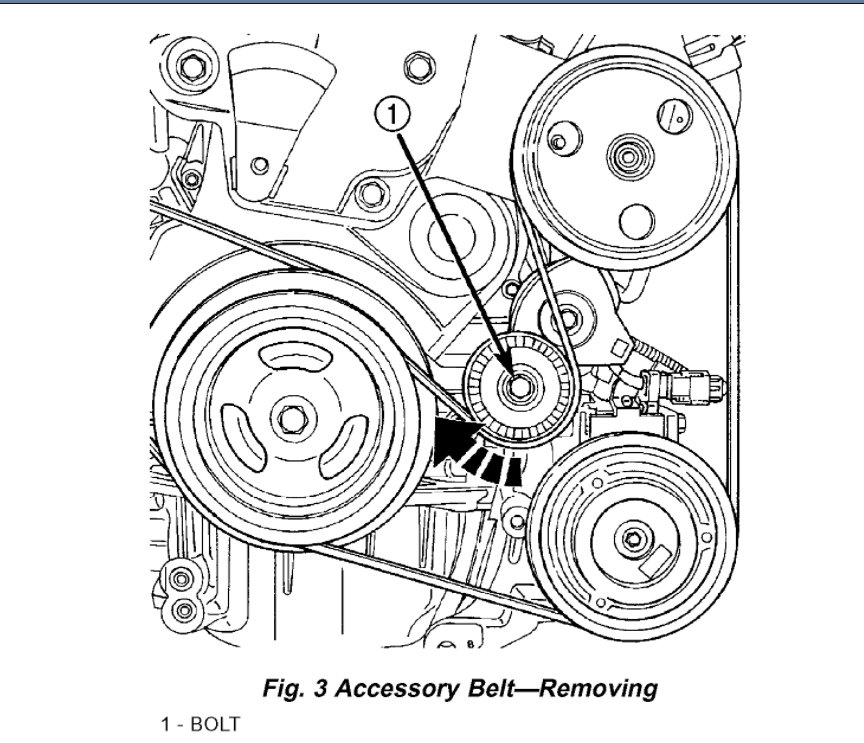

1. Remove belt splash shield (Fig. 2).
ImageOpen In New TabZoom/Print
2. Using a wrench, rotate belt tensioner clockwise (Fig. 3) until belt can be removed from power steering pump pulley. Gently, release spring tension on tensioner.
3. Remove belt (Fig. 4).

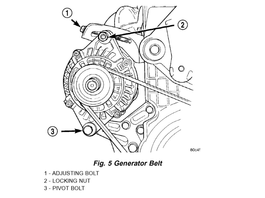

GENERATOR BELT
1. Remove power steering pump/air conditioning compressor drive belt.
2. Loosen pivot bolt, then locking nut and adjusting bolt (Fig. 5).
3. Remove generator belt.

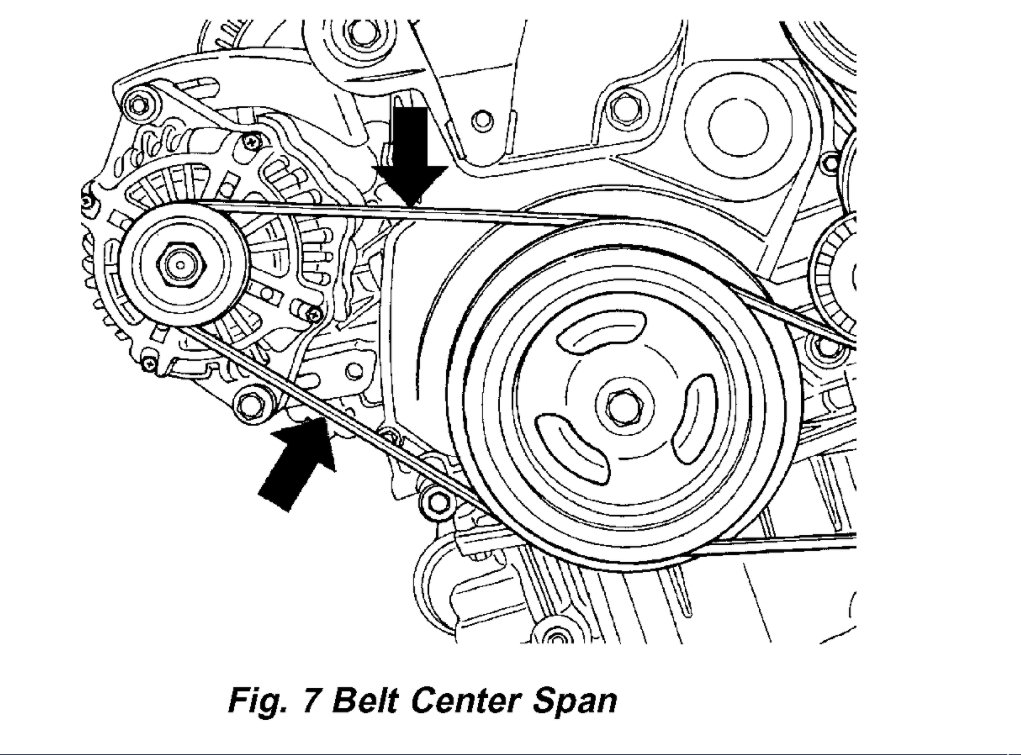

2. Check belt tension using Special Tool 8371 - Belt Tension Gauge Adapter, and the DRBIII using the following procedures:
WARNING: DO NOT CHECK BELT TENSION WITH ENGINE RUNNING.
A. Connect 8371 to the DRBIII following the instructions provided in tool kit.
b. Place end of microphone probe approximately 2.54 cm (1 inch) from belt at one of the belt center span locations shown in (Fig. 7).
C. Pluck the belt a minimum of 3 times. (Use your finger or other suitable object)
d. The frequency of the belt in Hertz (Hz) will display on DRBIII screen.
E. Adjust belt to obtain proper frequency (tension). Refer to the belt tension chart for specifications.
3. Tighten pivot bolt to 54 Nm (40 ft. Lbs.) And locking nut to 54 Nm (40 ft. Lbs.) (Fig. 5).

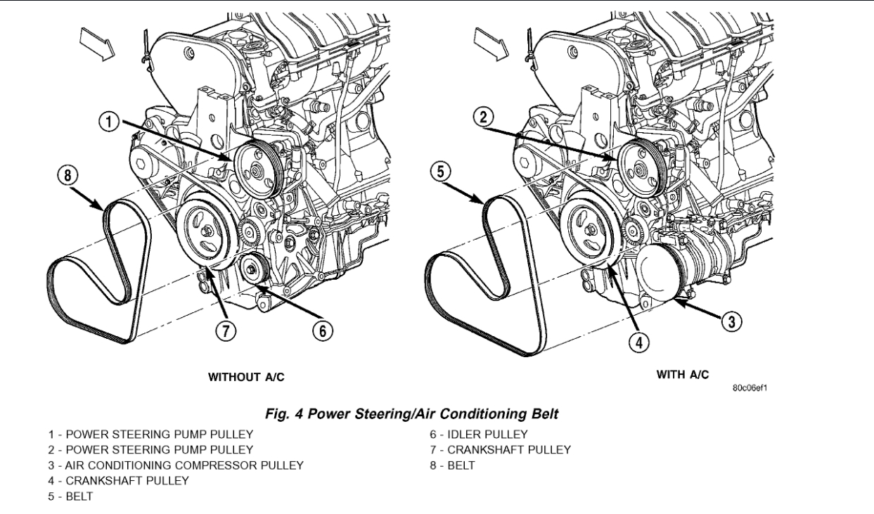

NOTE: When installing drive belt onto pulleys, make sure that belt is properly routed and all V-grooves make proper contact with pulley grooves.
1. Install belt (Fig. 4) over all pulleys except for the power steering pump pulley.
2. Using a wrench, rotate belt tensioner clockwise (Fig. 3) until belt can be installed onto power steering pump pulley. Release spring tension onto belt.
