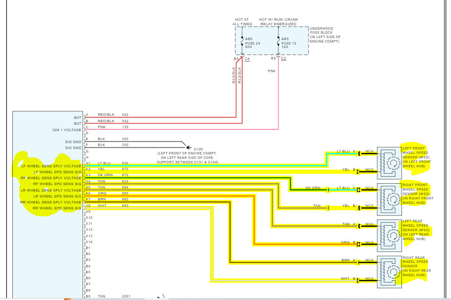

What is the name of the part that I plug in my Front Wheel Speed Sensor Wiring Harness to?
2006 PONTIAC G6
150,000 MILES • 6 CYL • 2WD • AUTOMATIC
SAM CRENSHAW
  • 52 POSTS
What is the name of the part that I plug in my Front Wheel Speed Sensor Wiring Harness to up on the engine side?
Nov 22, 2023 at 4:13 AM
  • 110,244 POSTS

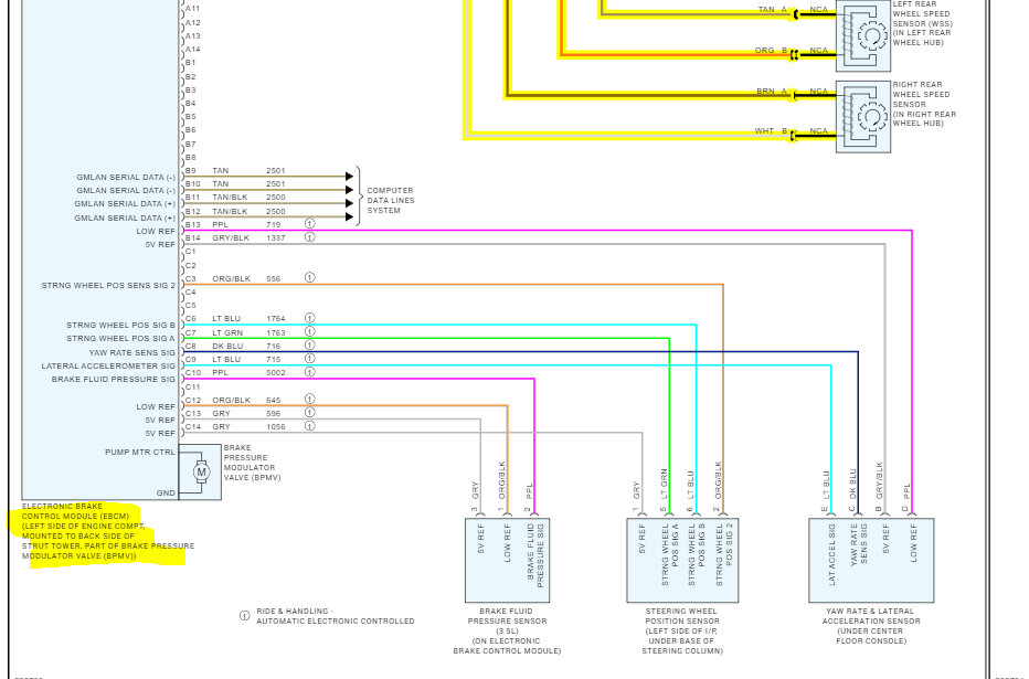

The wheel speed sensors connect to the electronic brake control module (EBCM).
I attached the wiring schematic below and highlighted the wires from the sensors. Take a look at the pics and let me know if that is what you need. Also, note that the EBCM is integral to the brake pressure modulator valve (BPMV).
