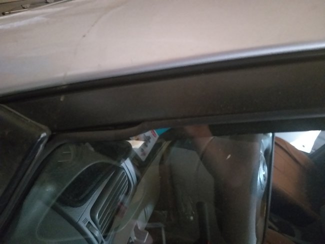

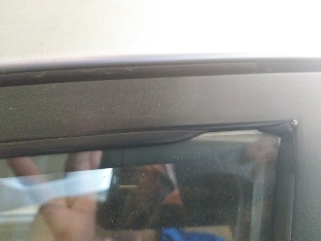

These are pictures of what I am referring to. Sorry for the late reply.

Those are not aftermarket but yet the factory Toyota felt channels that seal the windows when closed. The are usually press fit into the body seam and stay in place. After being deformed or twisted out of shape they may not stay in place. If that happens you can use contact cement to keep it secured contact cement comes with a built in brush not make a mess. This is available at hardware stores, home improvement stores, and auto parts stores. Picture attached below. Just adding my 2 cents. Hope this helps and thanks for using 2CarPros.

You can and we can assist with that but those pictures are really helpful. Before we go through trying to replace them, they fold into the window like that because they get dried out and as the window comes up, it grabs it and folds it in. Try lubricating the felt channels with the attached type of lubricant. I attached a common type but the key is that it is a silicone spray and not a grease. Clearly you can spray this on the felt but try to keep it from getting all over. It will not damage anything but it will be difficult to clean up.

You would use the silicone spray on a rag or cloth to wipe on the outside of the foam and then a light wipe on the edge of the lip where the glass slides past it. Then use a small amount of the cement to glue the seal back into position. Being this is an 04 those seals are likely very hard and stiff and trying to reform them may take some work. One thing that can help would be to use a hair drier or heat gun and warm the material up to make it easier to work with. Just don't hold the heat in one spot for a long time, you could damage the paint. Use the heat with the window down and work the felts like you were trying to form clay or play dough or similar, sort of smoothing it out and removing the folds. If you do that before using the silicone or glue you will have better success getting them to stay in place.
