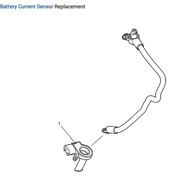

P0697 I'll replace the mass air flow sensor I also replaced all the relays And new air filter install I also did a hard reset by unplugging the battery terminals and letting it sit for over 40 minutes to reset the computer and it's still pops up the same code.
Jun 19, 2024 at 8:15 AM
  • 55,224 POSTS

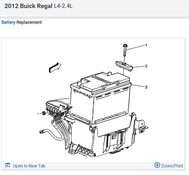

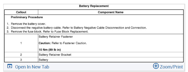

The P0697 code is related to the sensor reference voltage. Specifically, this code indicates a problem with the "Sensor Reference Voltage 'C' Circuit Low."

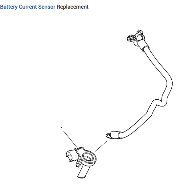

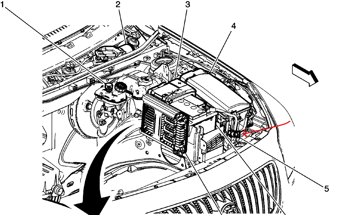

It sounds like the battery is bad or the voltage sensor has gone out, here is a guide to help you load test the battery or you can take it to the auto parts store for testing.
Clear the codes once the repair has been completed. Check out the images (below). Let us know if you need anything else.
Jun 19, 2024 at 12:11 PM
KEITH BEAL
man, it was the voltage sensor this little part. man, it has been ordered and thank you,
