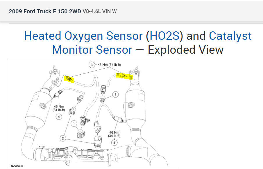

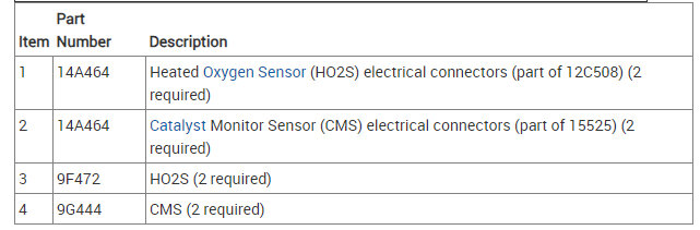

What is the correct o2 sensors to buy?
2009 FORD F-150
141,000 MILES • 4.6L • V8 • 2WD • AUTOMATIC
JC7539
I have a power issue and it’s due to a failed o2 sensor and I’d like to change both on the front, but I don’t want to buy the wrong ones.
Mar 10, 2024 at 3:35 PM
  • 110,194 POSTS

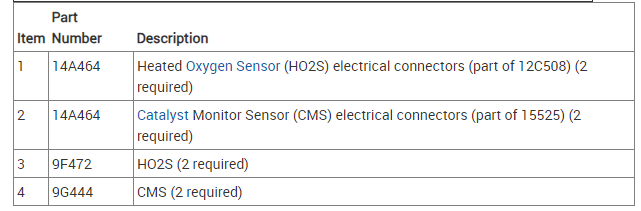

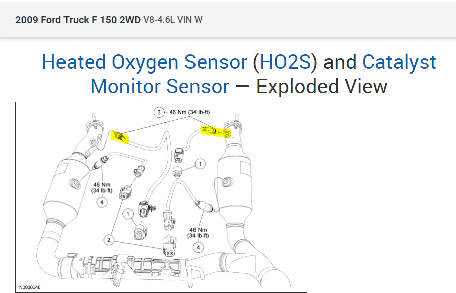

No problem whatsoever. If you look at pics 1 and 2 below, I provided the manufacturer's part numbers for the upper and lower sensors. The cost of an OEM part is much higher than you can get from a parts store. Just make sure to confirm the part numbers cross with each other.
If you do get them from a parts store, confirm the connectors are already attached and don't require you to rewire the connector. That can be a pain. LOL
