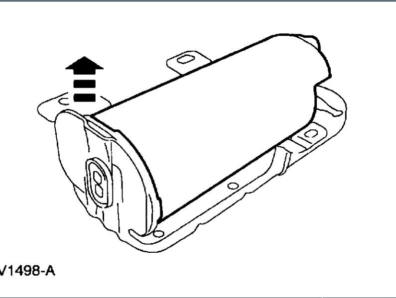

What is the box on top of rear exhaust

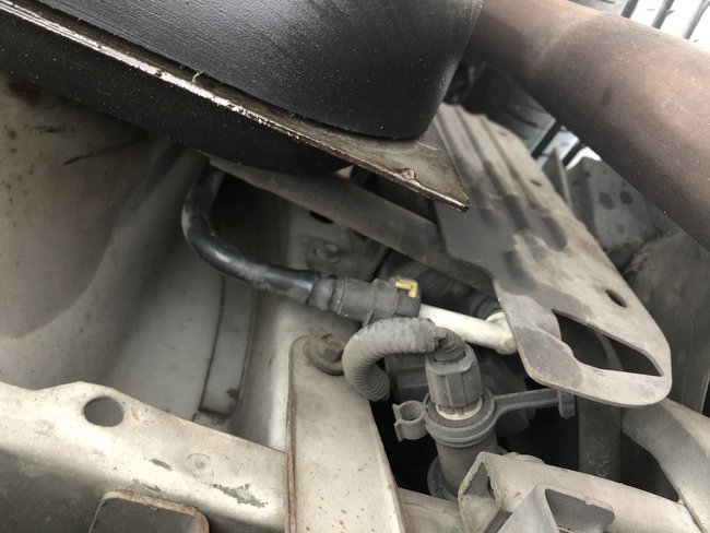

So when I was checking the rear for oil leaks. I found a box right above the rear or the exhaust and it was missing a connection. There is a honeycomb shape (filter?) inside that box and I later found the connector for it. It appears that the connector tube is chipped and that’s why it can’t stay connected. What is that box and can I repair the connector?
Jan 22, 2020 at 3:14 AM
Good afternoon,
Can you post a picture of the box?
It sounds like the evap canister but want to be sure.

It’s the white tube like connector.
Jan 23, 2020 at 8:27 AM
That is the evap line for the canister. The vent will be open as it vents to atmosphere.
Jan 23, 2020 at 8:43 AM
NIEVESFOO
  • 16 POSTS
This one disconnected when it I checked it. The reason because the clip that goes inside the canister is broken so it doesn’t hold that well. So how can I replace that? What was happening throughout the time that was disconnected?
Jan 23, 2020 at 8:46 AM
Is the check engine light on with a code stored? You can have the codes checked at a parts store for free.

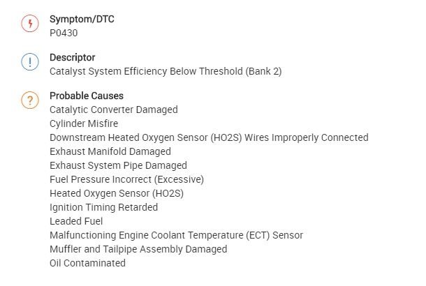

If I recall, the only code that comes up is a P0430 but that’s for something else.

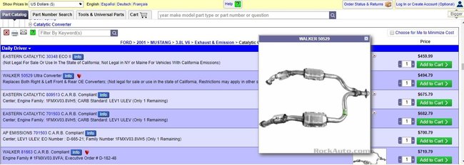

Okay, the 430 is a bad catalytic converter on the driver's side. The catalytic converter is part of the header pipe. It is replaced as an assembly with both catalytic converters.
Jan 23, 2020 at 9:22 AM
NIEVESFOO
  • 16 POSTS
Can’t the P0430 code also have to do with exhaust manifold leaks? About a week ago I used JD weld to cover those leaks but I haven’t reset the code yet. I was hoping it would go away by itself. But if it’s a catalytic converter thing then that’s something I have to replace when I have the funds.
Jan 23, 2020 at 9:26 AM
Try it and see. If it does not work, then yes, replace the catalytic converter.
