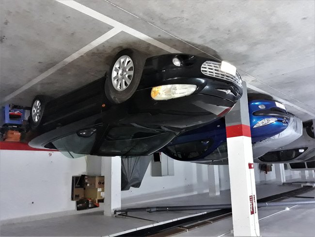

What is the best way to go about replacing both headlight units?
2004 CHRYSLER SEBRING
100,000 MILES • 2.0L • 4 CYL • 2WD • MANUAL
DAVE106
I live in Spain and the car I have listed above ; 2, LHD, European, 2.0L Petrol, Manual, Cabrio.
The headlights are the same as a 2001 model, flat at the bottom, see attached picture.
I have bought 2 aftermarket replacements and I would like to know the recommended way to replace them.
Nov 28, 2020 at 3:40 AM
Here is a guide that will help with a little bit more general procedures on how to replace these. Clearly the instructions from back then were not terribly detailed so this should help.
https://www.2carpros.com/articles/headlight-lens-replacement
Also here is a video that is put out by a parts website that shows step by step on a sedan but they are the same as a convertible which is what it looks like you have.
https://youtu.be/rvdPfAohIRI
