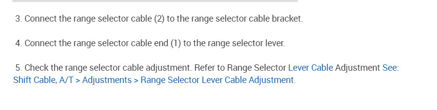

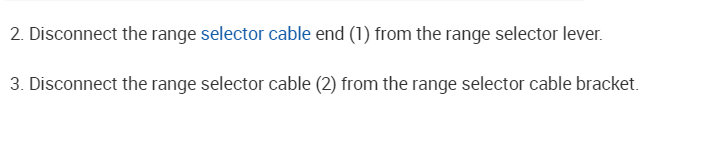

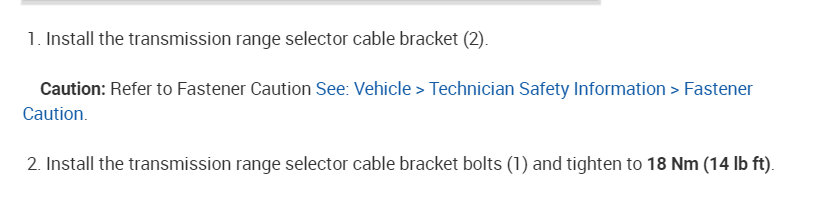

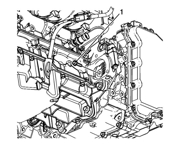

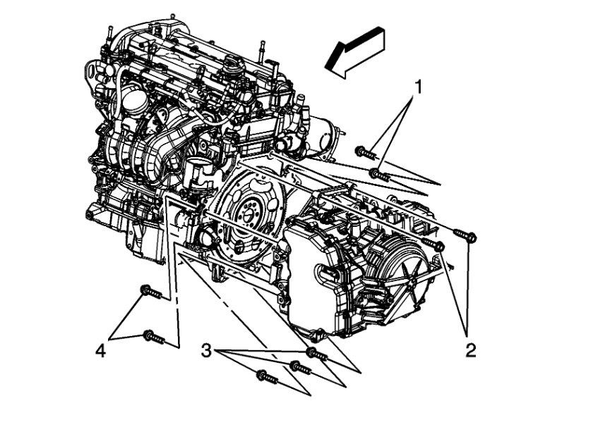

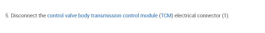

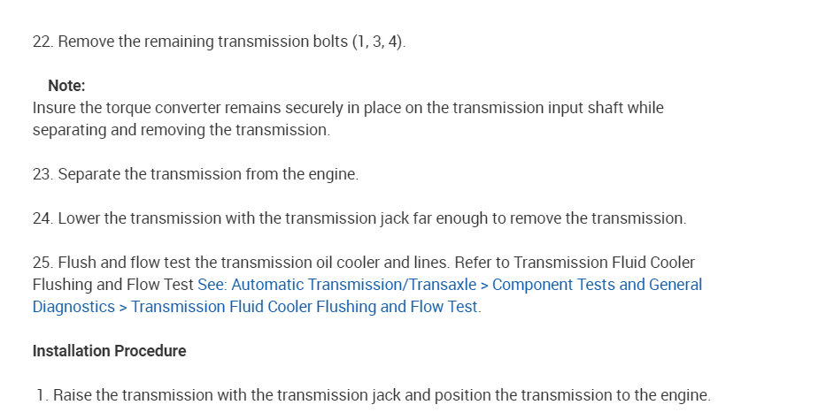

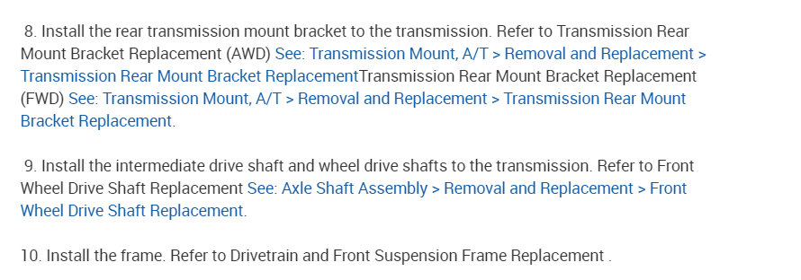

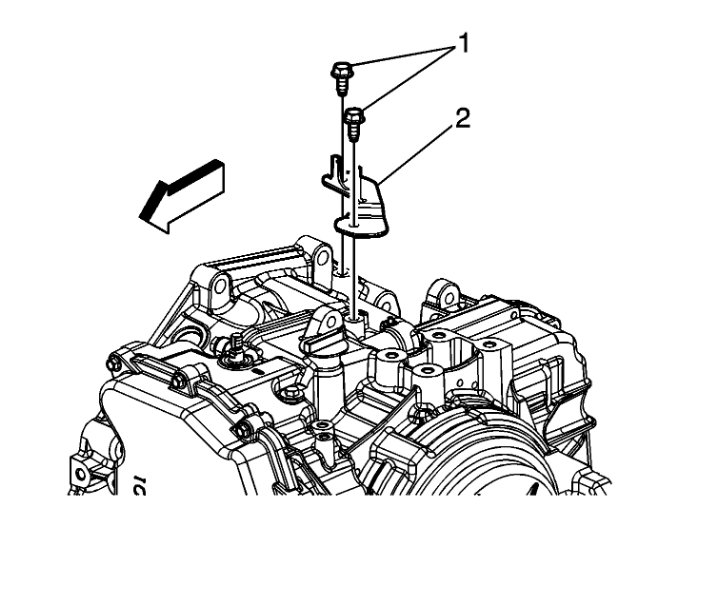

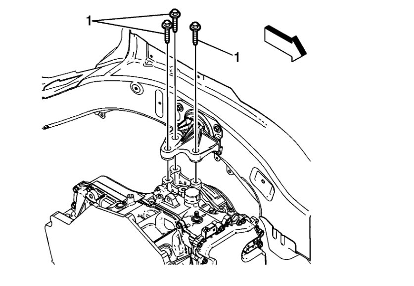

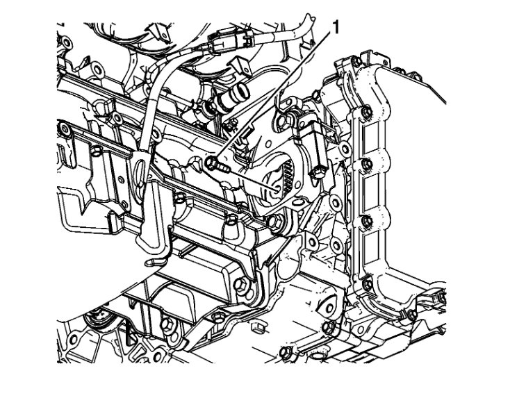

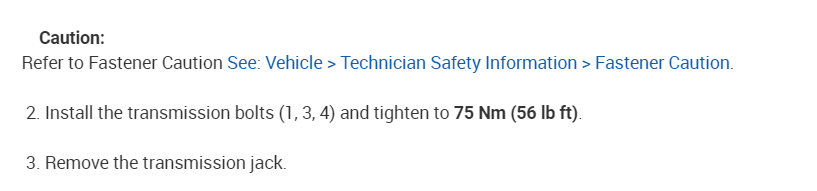

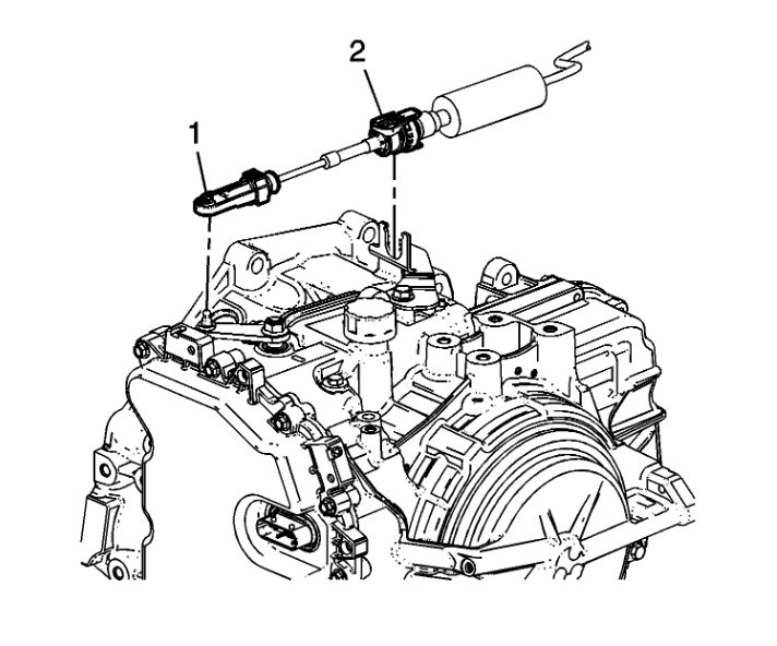

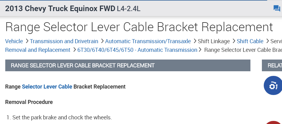

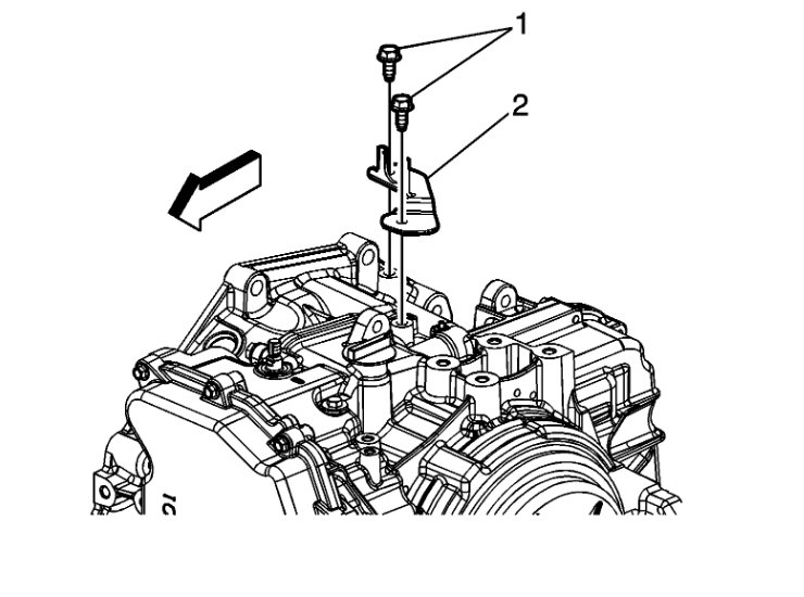

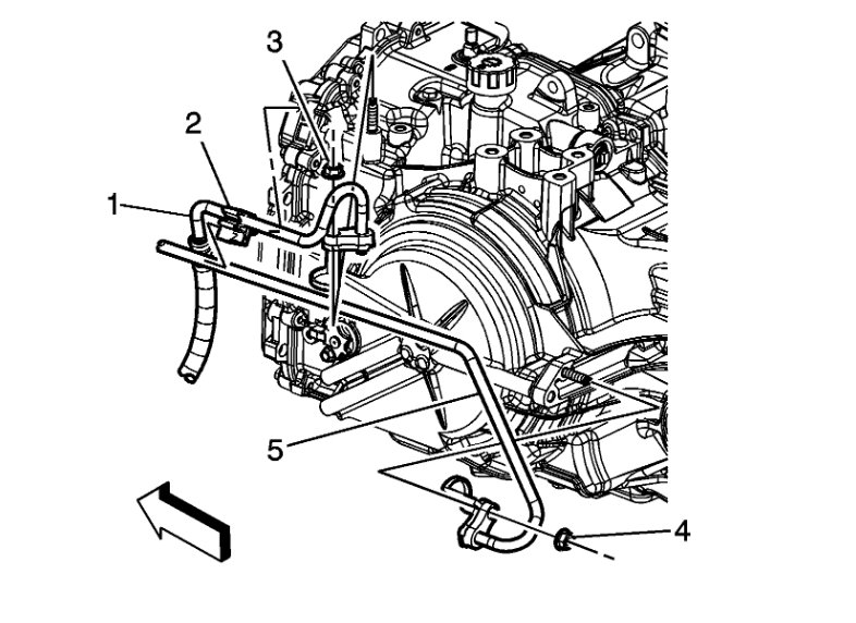

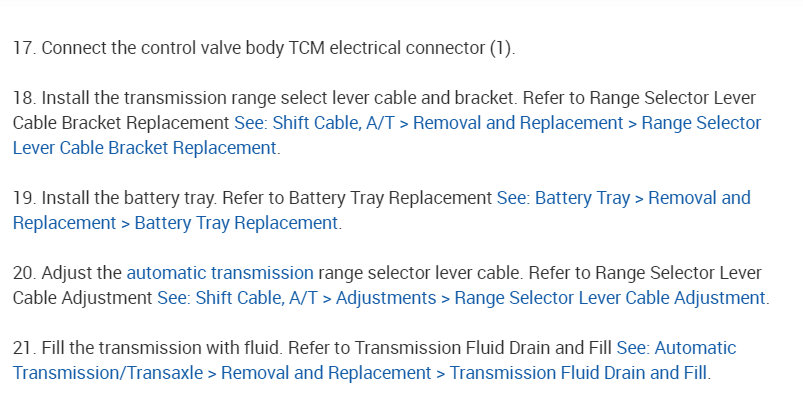

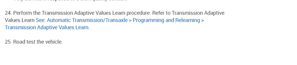

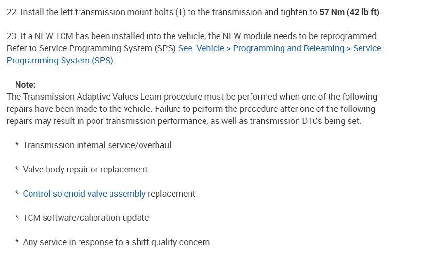

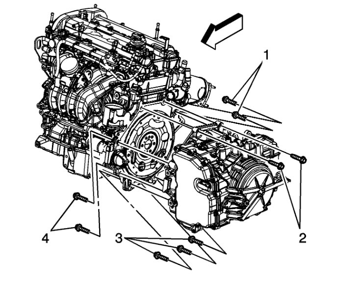

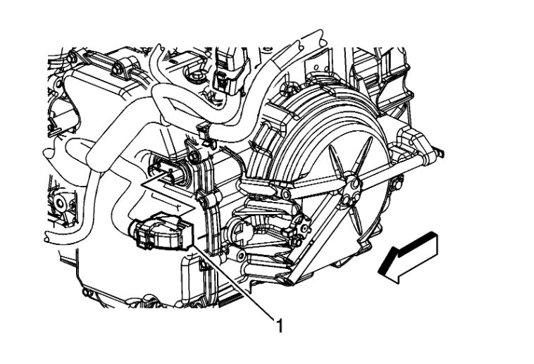

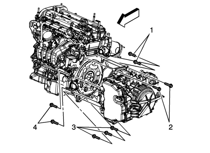

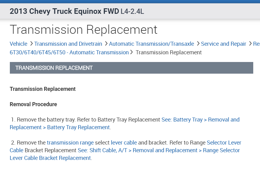

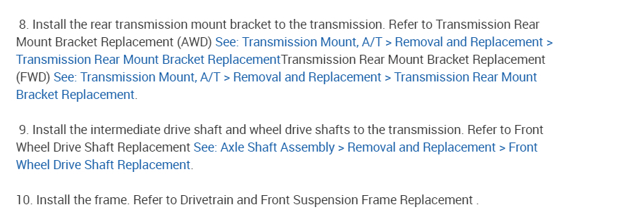

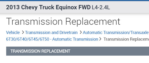

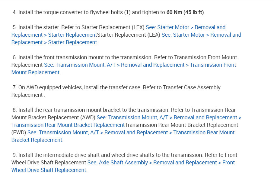

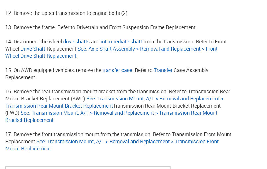

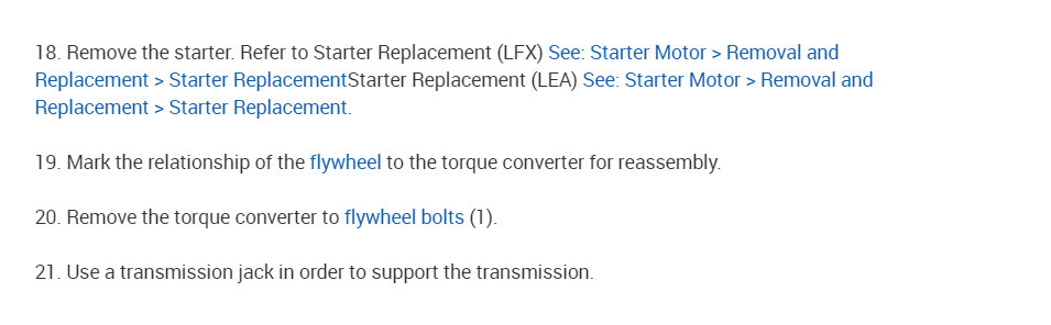

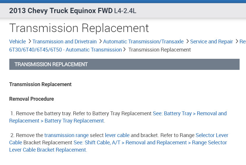

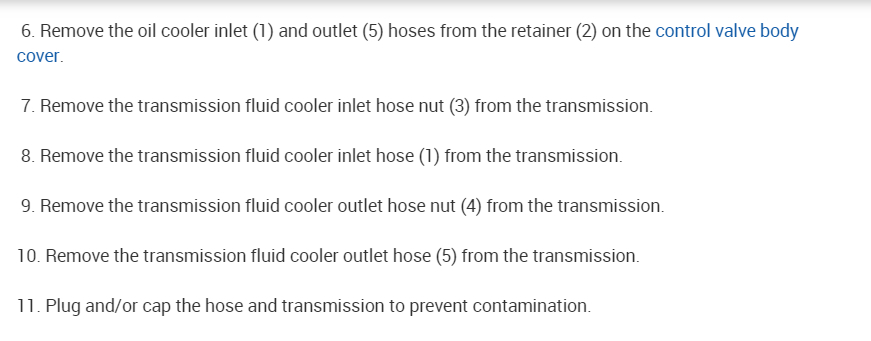

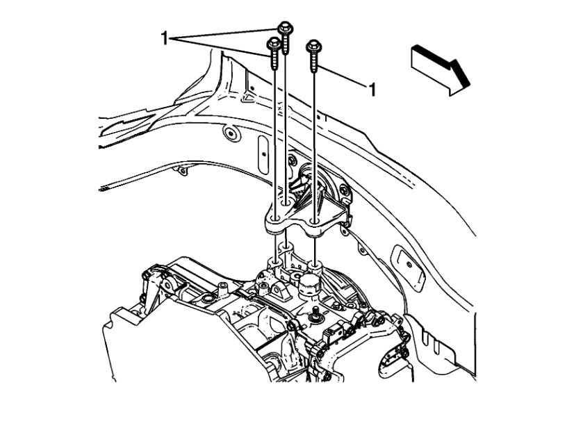

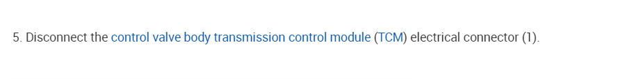

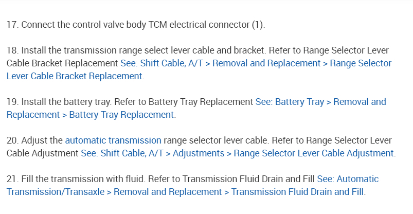

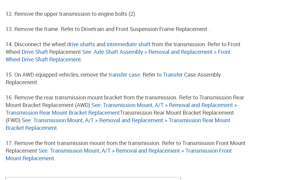

I would like to do transmission change for the vehicle listed above. What is the procedure? Thanks.
Apr 28, 2019 at 4:51 PM
SCGRANTURISMO
  • 4,897 POSTS
I have included the information that you requested in the diagrams down below. Please go through this guide and get back to us with what you are able to do. If you should have any other vehicle related questions, than please feel free to ask. it's what we do and it's why we are here.
Thanks,
Alex

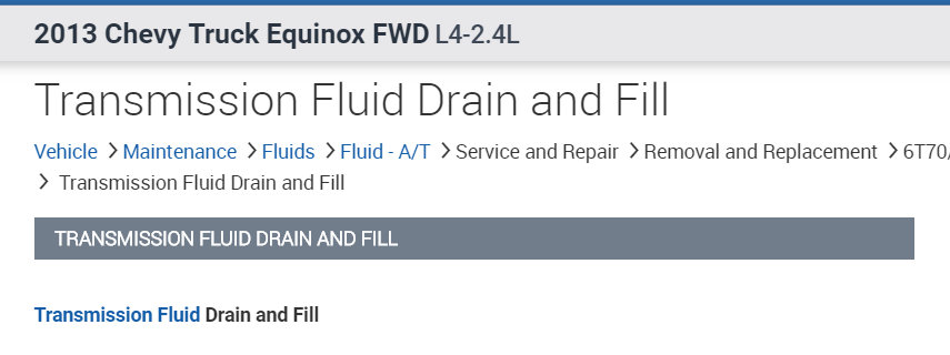

Actually, I missed word title. I meant transmission fluid. Sorry for confusion.

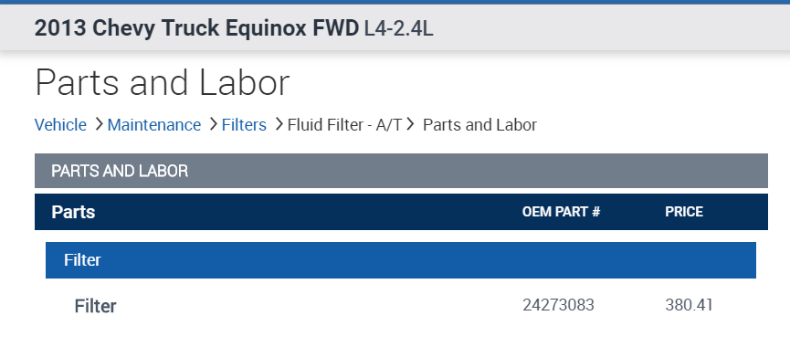

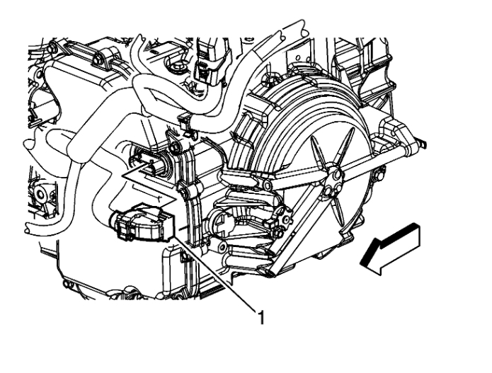

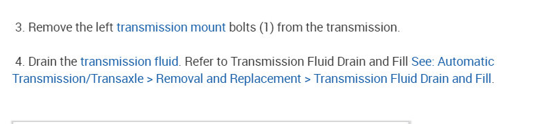

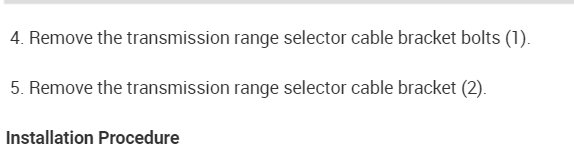

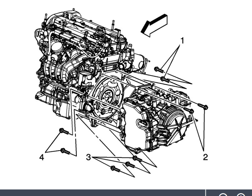

This all I could get from my vin#
2013 Chevrolet Equinox LS 2WD 4 Cylinders K 2.4L DI DOHC
May 3, 2019 at 10:42 AM

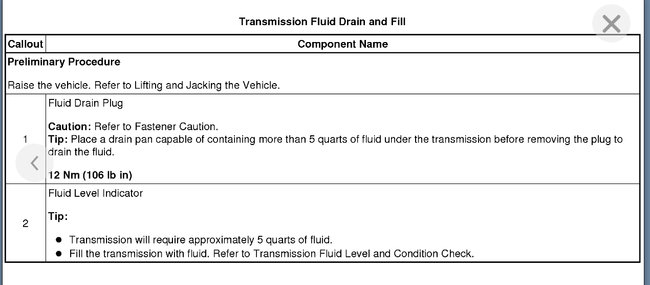

SCGRANTURISMO
  • 4,897 POSTS
Hello again,

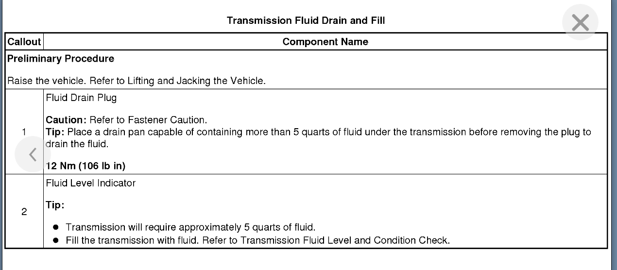

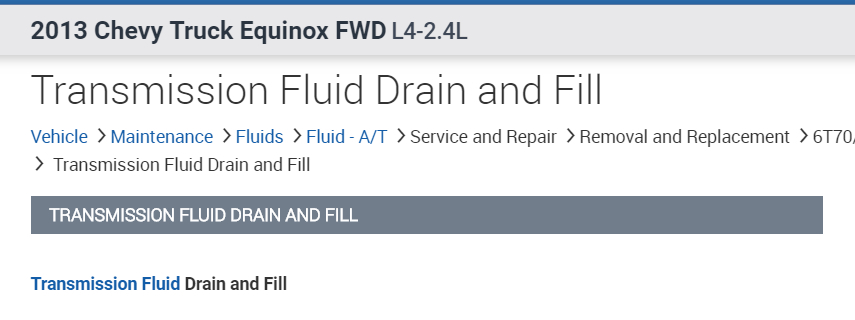

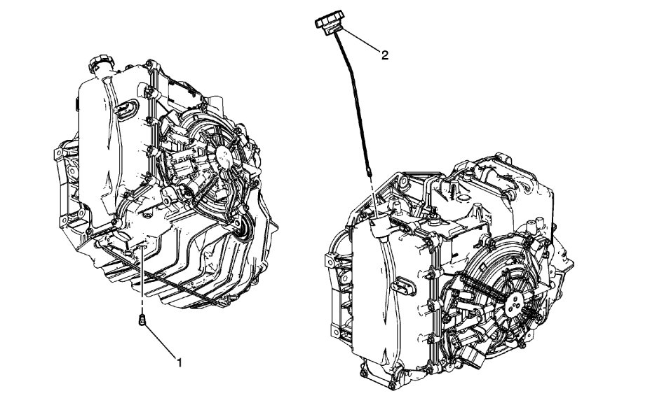

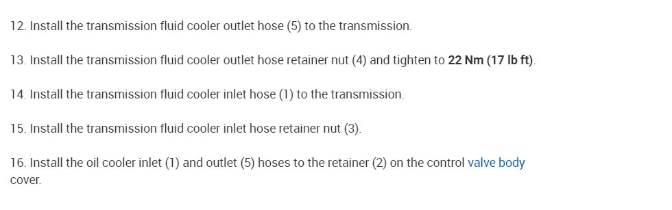

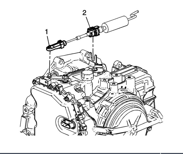

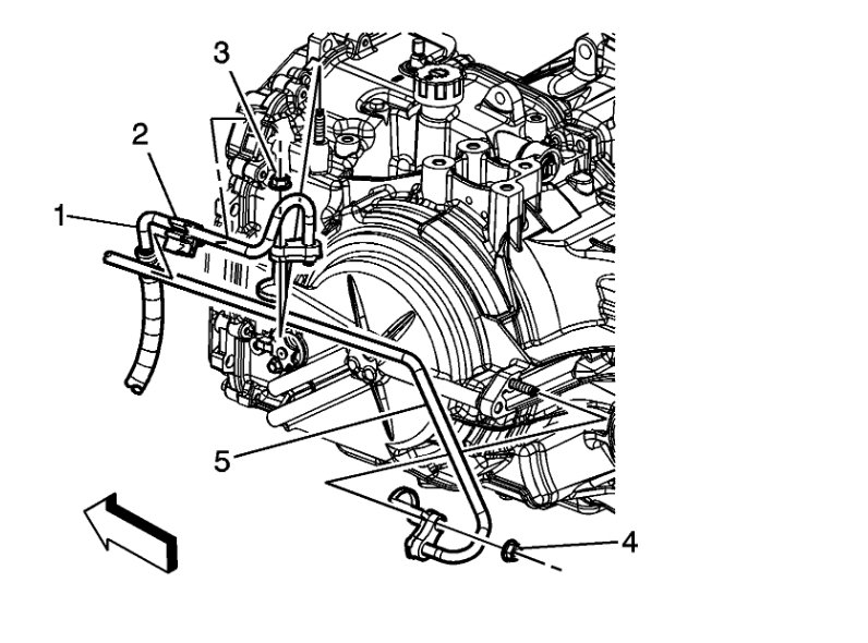

Okay, I think I have the right one here. The information that you requested is in the diagrams down below. Please go through these guides and get back to us with how everything turns out, or if you have any other questions.
Thanks,
Alex
2CarPros
May 3, 2019 at 7:13 PM
ROYCAR71
  • 359 POSTS
wow, is that really it? just drain old fluid and put back in same amount you took out.
May 4, 2019 at 4:03 AM
SCGRANTURISMO
  • 4,897 POSTS
Hello again,
Yes, that's what a service is. It's like an oil change for your engine. Although they have no information on changing the filter. Usually Automatic transmissions/trans-axles have a filter in them as well. Maybe your vehicle has a lifetime filter in it.

Okay, I changed fluid. What scan tool do I need to find transmission temperature to know if I overfilled or under filled? Thanks.
May 4, 2019 at 7:04 PM
SCGRANTURISMO
  • 4,897 POSTS
Hello again,
Go for two separate drives for me. Is your vehicle's Malfunction Indicator Lamp (MIL) or "check engine" light illuminated?
Thanks,
Alex
2CarPros
May 5, 2019 at 2:42 AM
ROYCAR71
  • 359 POSTS
No lights, I went to go fill up today. Going and coming back car shifted smooth with more torque.
May 5, 2019 at 11:05 AM
SCGRANTURISMO
  • 4,897 POSTS
Hello again,
Good job! That's what we like to hear.
