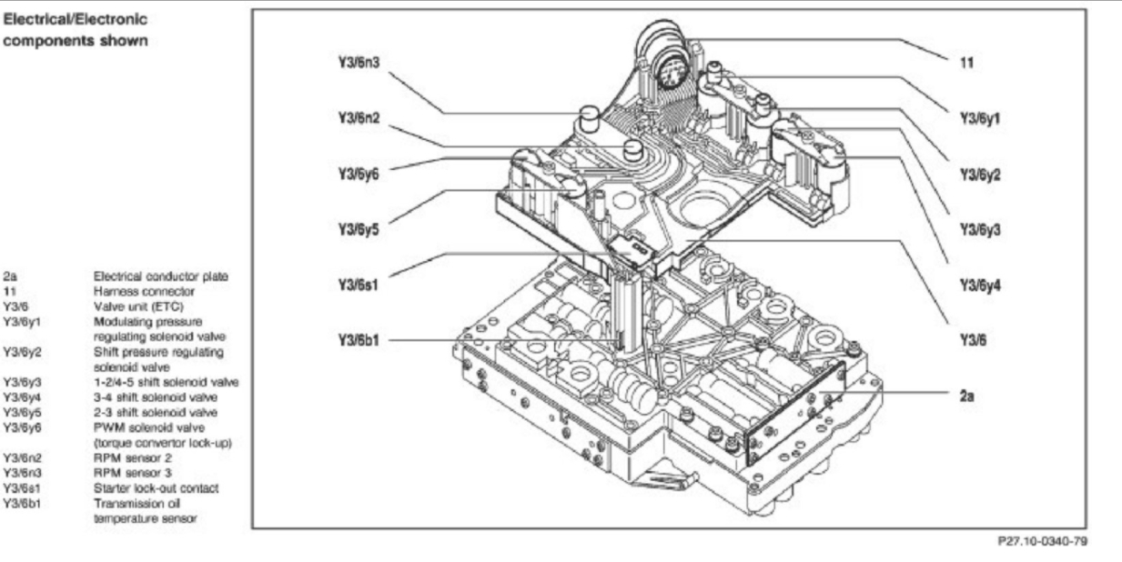

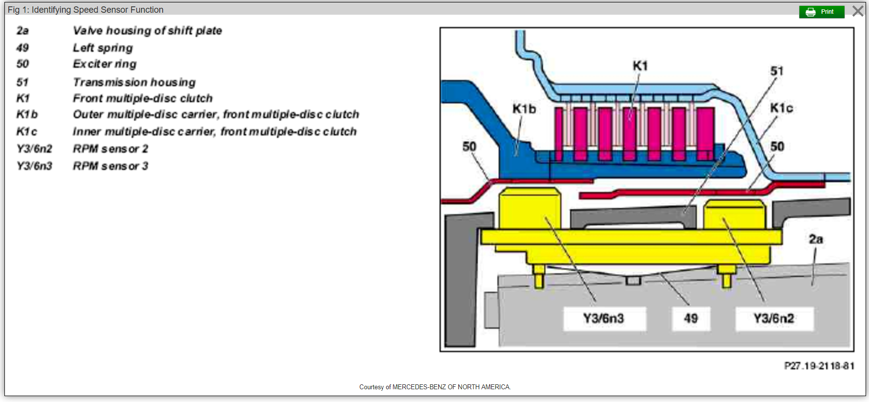

What is po715 code? Where the input speed sensor located at?

It looks like it is inside the transmission on the valve body, here is a guide that will give you an idea of what you must do to get at the sensor.
Here are some diagrams of its location in your car, (below)
They call it an RPM sensor.
