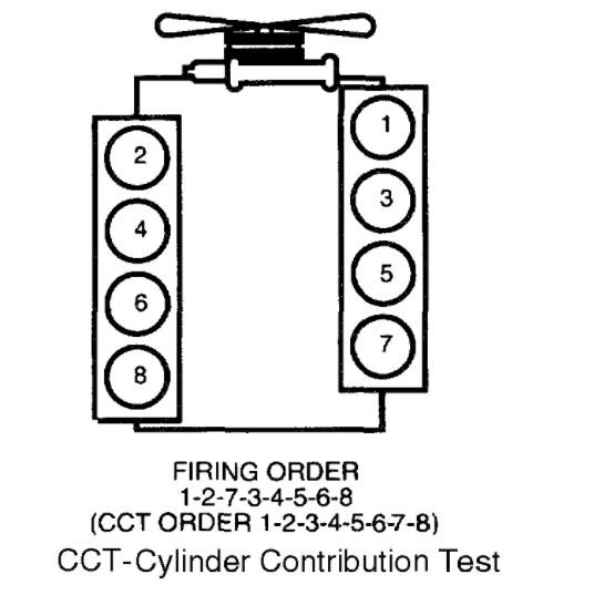

i need to know what my piston order is and this is a diesel.
Feb 21, 2018 at 2:50 AM
Good afternoon.
Attached is the firing order and cylinder location.
Feb 21, 2018 at 3:53 AM
SANDRANARDUCCI
  • 15 POSTS
And just to clarify this is for a diesel engine right?
Feb 21, 2018 at 4:11 AM
Yes, the 7.3 turbo diesel.
