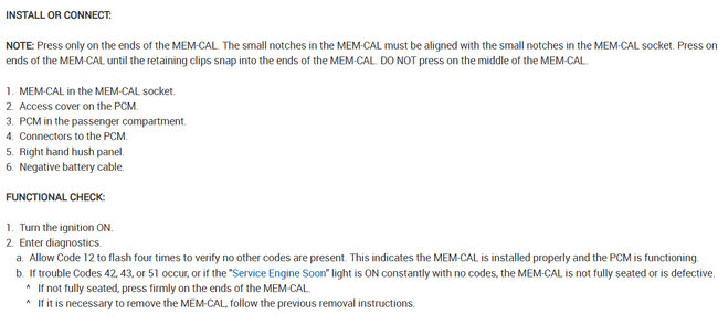

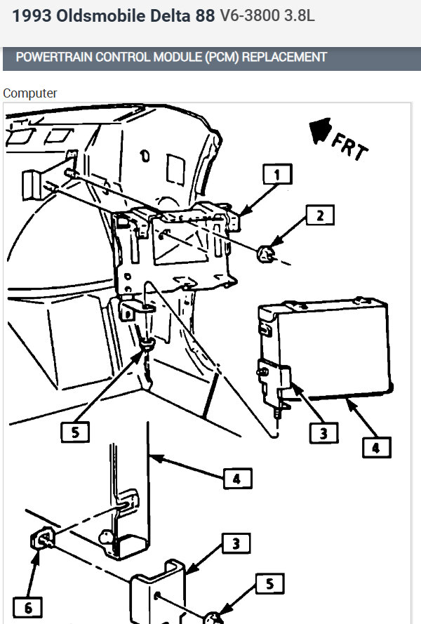

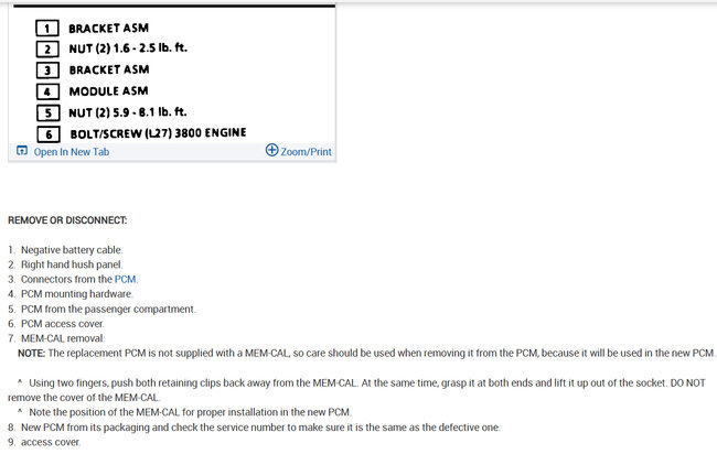

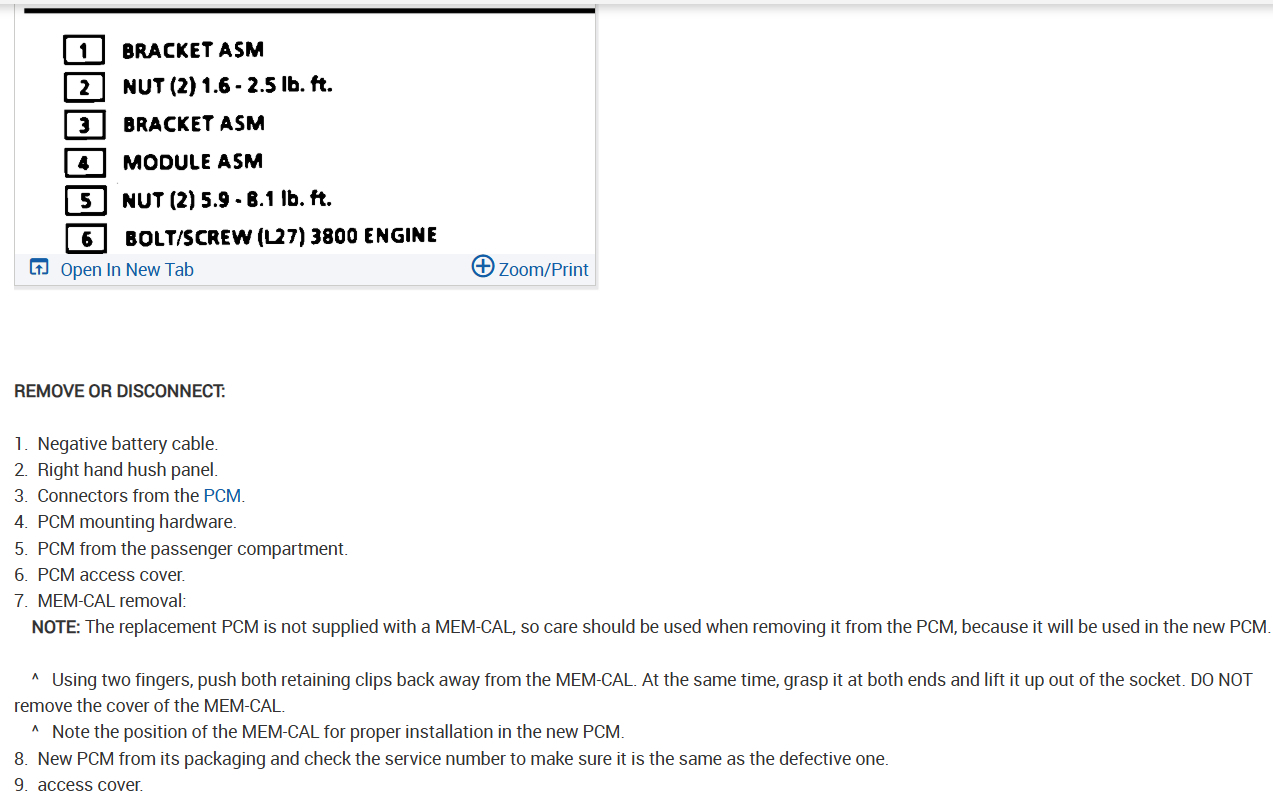

a Code 56 in the OBD-I (On-Board Diagnostics) system generally refers to an issue with the Quad Driver Module (QDM) in the Powertrain Control Module (PCM). So, it looks like the ECM is bad. I would get a rebuilt unit by searching eBay or Google. Here are the instructions on how to do the job. Check out the images (below). Please let us know what happens.
