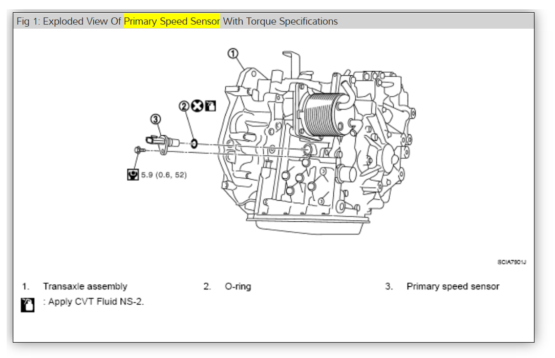

My car when at a complete stop does not want to take off or whenever going uphill, if I am under the speed of 40MPH it acts like it does not want to change gears. i don't know if it is a vacuum seal leak or if it is my transmission.
Jun 29, 2022 at 2:50 AM
  • 55,732 POSTS
This happens when the input shaft speed sensor goes out. To be sure let's run the codes. I have included a guide to help you and the location of the sensor in the diagrams below.
