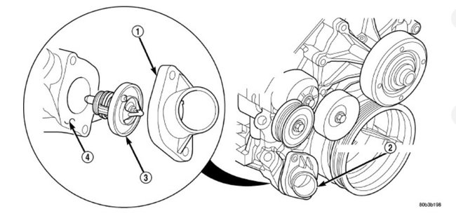

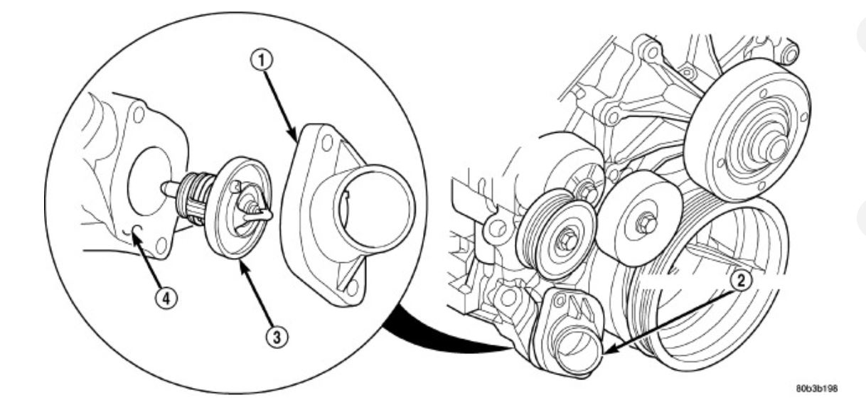

When I sit inside the vehicle and turn it on and turn the heat on you can hear a running water like gurgling noise through the center dashboard air vents. I never heard it before. also on the top of my coolant reservoir near one of the top air hoses I can see the coolant bubbling in there. I’ve looked underneath the car while I’ve had it on and I’m not seeing it leaking from anywhere. does this mean something is the matter with my heater core?
Apr 21, 2019 at 12:33 AM
Good morning,
The noise is the coolant boiling in the heater core from the coolant being too hot.
https://www.2carpros.com/articles/how-an-engine-thermostat-works
I would start with a thermostat replacement as it may not be controlling the temperature of the coolant.
I see no Liberty listed for 1999 so I looked up a 2009 which is the same for all 3.7 engines.
Do not waste reusable coolant. If solution is clean, drain coolant into a clean container for reuse.

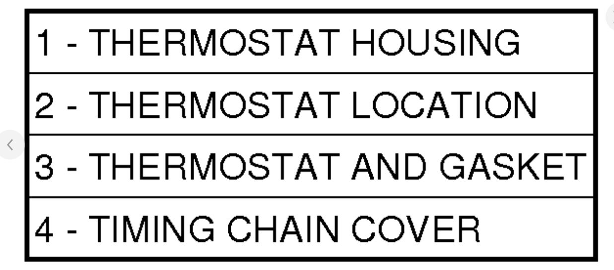

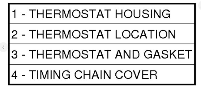

If thermostat (3) is being replaced, be sure that replacement is specified thermostat for vehicle model and engine type.
1. Disconnect negative battery cable at battery.
2. Drain cooling system See: Cooling System > Procedures.
3. Raise vehicle on hoist.
4. Remove splash shield.
5. Remove lower radiator hose clamp and lower radiator hose at thermostat housing.
6. Remove thermostat housing mounting bolts, thermostat housing and thermostat.
