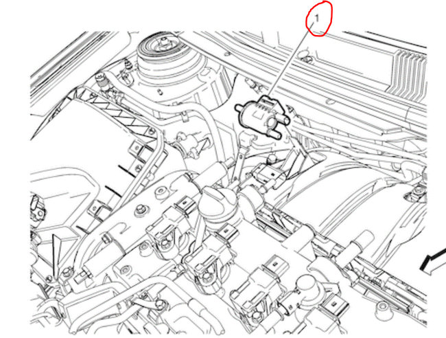

Is that the same thing as a purge solenoid? that's what I think then after I shut my car off I hear clicking and like a little electric motor about 5 minutes later coming like behind the steering column.
Mar 26, 2021 at 1:39 PM
  • 110,251 POSTS
The purge solenoid is different. Although it is also part of the emissions system, it has a totally different job. A purge valve or solenoid allows gas fumes to enter the combustion chamber when the engine is running at specific conditions.
Gas vapors are produced by the fuel in your vehicle. The evaporative emission system (EVAP) is responsible for preventing fumes from entering the atmosphere. The fumes are stored in a charcoal canister. When conditions are right, the purge valve/solenoid opens and allows the fumes to be drawn into the engine and burned.
I hope that makes sense. LOL Let me know. Also, let me know if you have other questions. I attached a pic of the purge valve below.
See pic below.
