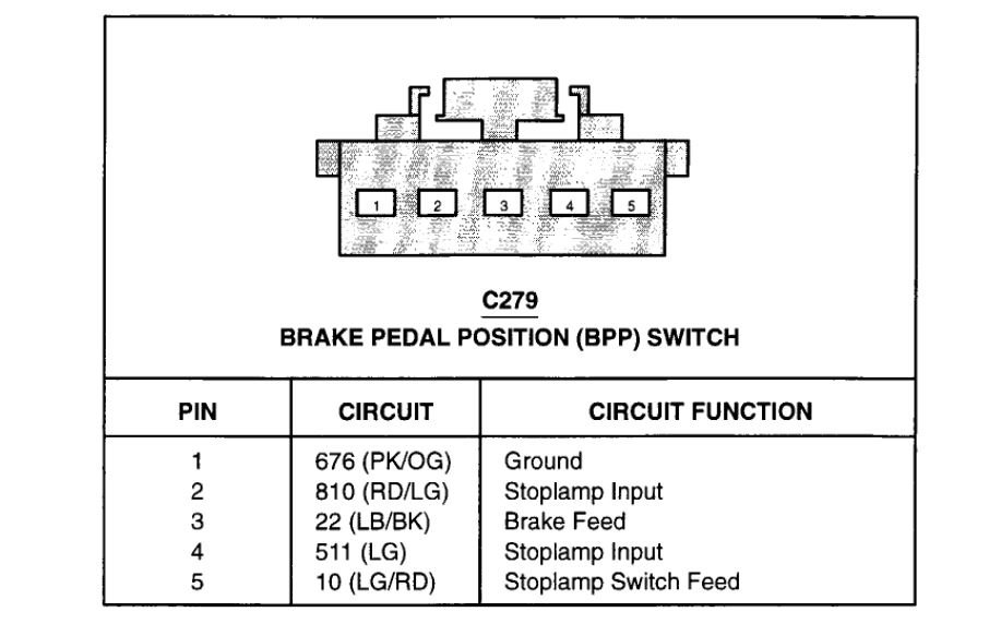

What is twelve volt current flow on the brake switch? I have hot on terminal number five always Terminal number four. Terminals one, two and three I need what they are and where they feed to or from?

Good morning.
Attached is the connector diagram.
the max allowed current flow is six amps under full load.

Thank you for the image. I cannot find my owner's manual and did not know what color wire went with what. I will let you know if I get them working.

Pin #3 should be hot all the time with twelve volts from the fuse #15 in the central junction box, located behind lower left side of dash.
Pin #2 goes to the brake system module and pin #1 is of course ground.
Then the pins for the brake lights are #5 hot with twelve volts all the time from that fuse #13 in the CJB and to the brake lights, etc is pin #4.

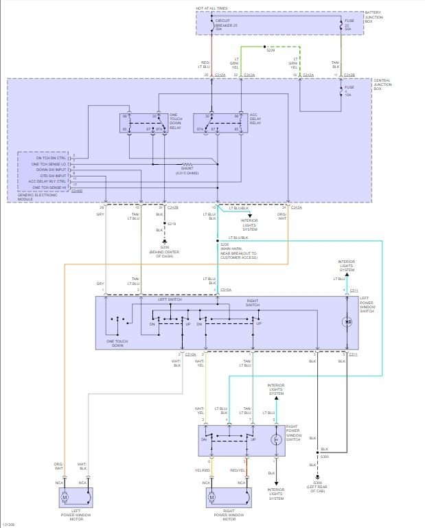

I have no cargo lights on the out side of the cab No lights when I open the doors. Cab inside lights work with the switches at the individual lights Electric windows do not work at all checked relay four and fuse seven both were okay.

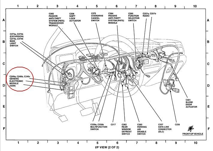

Both of these circuits used to be operated through uncommonly reliable switches, but today, the new breed of engineers do not know how to do that without adding a computer to the systems. These are both run through the "generic electronic module", (GEM). That module is prone to failure due to water leaking onto it through a leak in the windshield. Start by inspecting the connector terminals for signs of corrosion.

No water problem no power at number 7 fuse where is feed wire feeding from. Fuse number 7 is for? Power windows/lock switch illumination 5 amps If not correct which one is. Problem is door windows do not work What is color of feed wire to d

The power windows have 2 fuses and a circuit breaker, the fuses are #22 in the battery junction box and #4 in the central junction box, then a circuit breaker #25 in the battery junction box.
There are also 2 relays in the central junction box, a one touch down and an acc delay relay.

I do see that #7 fuse is for the window switch light bulbs but that fuse does not power the window motors.

Power windows fuses numbers 22 and 4 are ok Circuit breaker 25 is ok relays in central junction box have been replaced Still no power at window Which wire feeds the switch and where it feeds from do need to check for continuity on wires

what are you going to use to test continuity? If a multimeter, then why didn't you use it to check those fuses for voltage?
Anyhow, the wire is the light blue/black. Didn't you look at that wiring diagram?
I know the diagram is little confusing, but it all depends on where the buttons are at for which wire you want to test.
