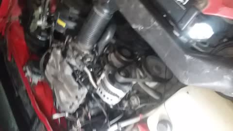

Mr. Roy, I have done that nothing. The book said something about that wire to unplug disconnect negative on battery. I guess so ECM will reset or something but plugging wire back in and hooking the battery back up I don't know how that will reset set the ECM. I don't know if I need to try and crank it first and then plug the wire up. I have no idea.

Well got it running better than I did before because of the new distributor but still same thing. I am loading a video. I don't know what to do now. Any ideas?
Saturday, February 16th, 2019 AT 5:50 PM
  • 52,797 POSTS
Okay, upload the video and let me hear what it sounds like.

I uploaded it. Did you get it?
Sunday, February 17th, 2019 AT 12:06 PM
  • 52,797 POSTS
Okay, so it shuts off driving?
Does it start back up?
Does the check engine light come on?
