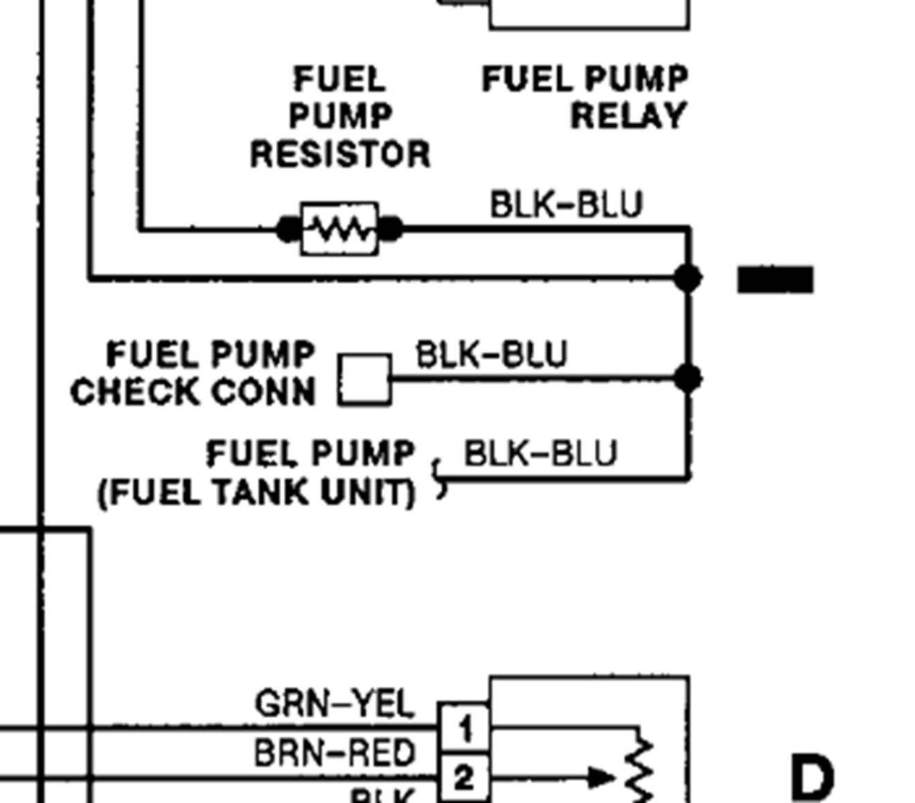

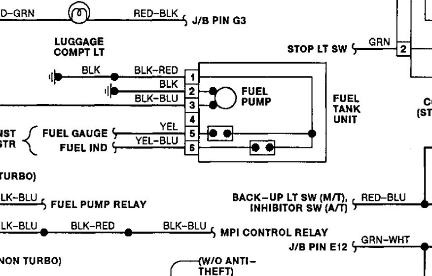

My car is has a five speed transmission with a twin turbo engine. My in tank fuel pump went down and I pulled out the sending unit,I replaced the fuel pump, but I am not sure what wires connect to what. I have a black wire connected to the sending unit,and a blue wire connected to the sending unit. Could you tell me where the wires connect to? This is out of my comfort zone. Also there are three rubber hoses that go to the fuel tank, can you tell me where they go? I know where the pressure hose connects to, but not sure where the other hoses go. I do not want to mix them up since we are dealing with gas. So far you people have been a great help to me and I appreciate all the help you have given me.

see pictures for wiring the fuel tank. we have no pictures of that however. one line should go for fuel, another for return which should be smaller and third line may go to evap canister or it may be vacuum to go to canister.
