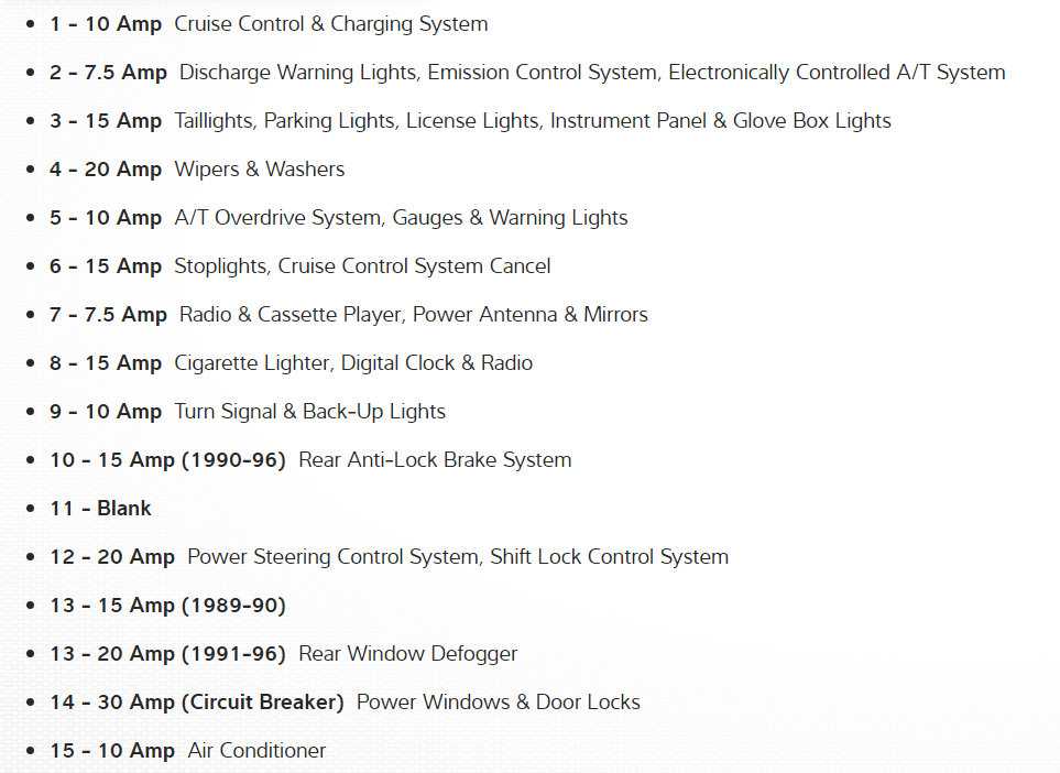

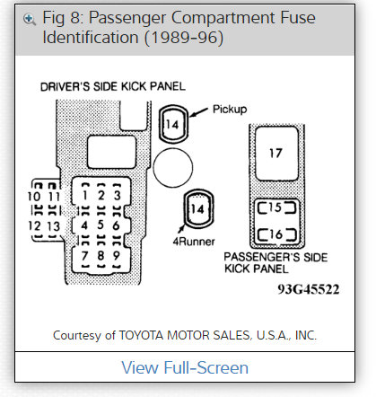

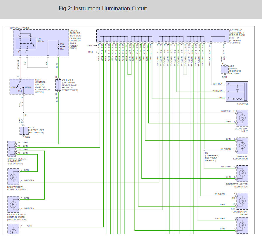

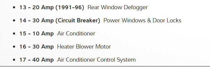

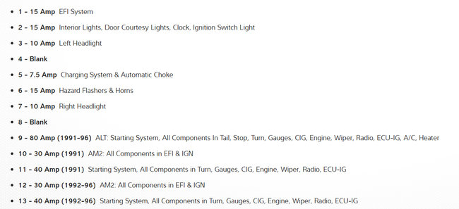

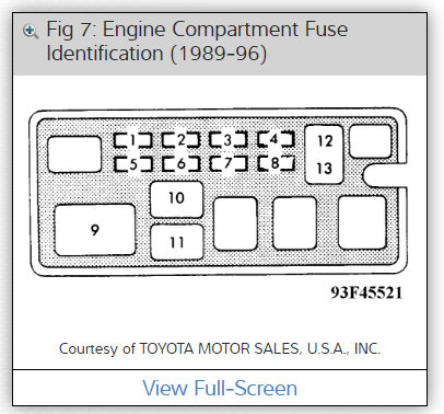

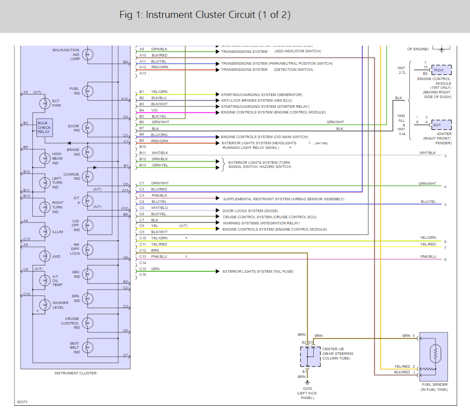

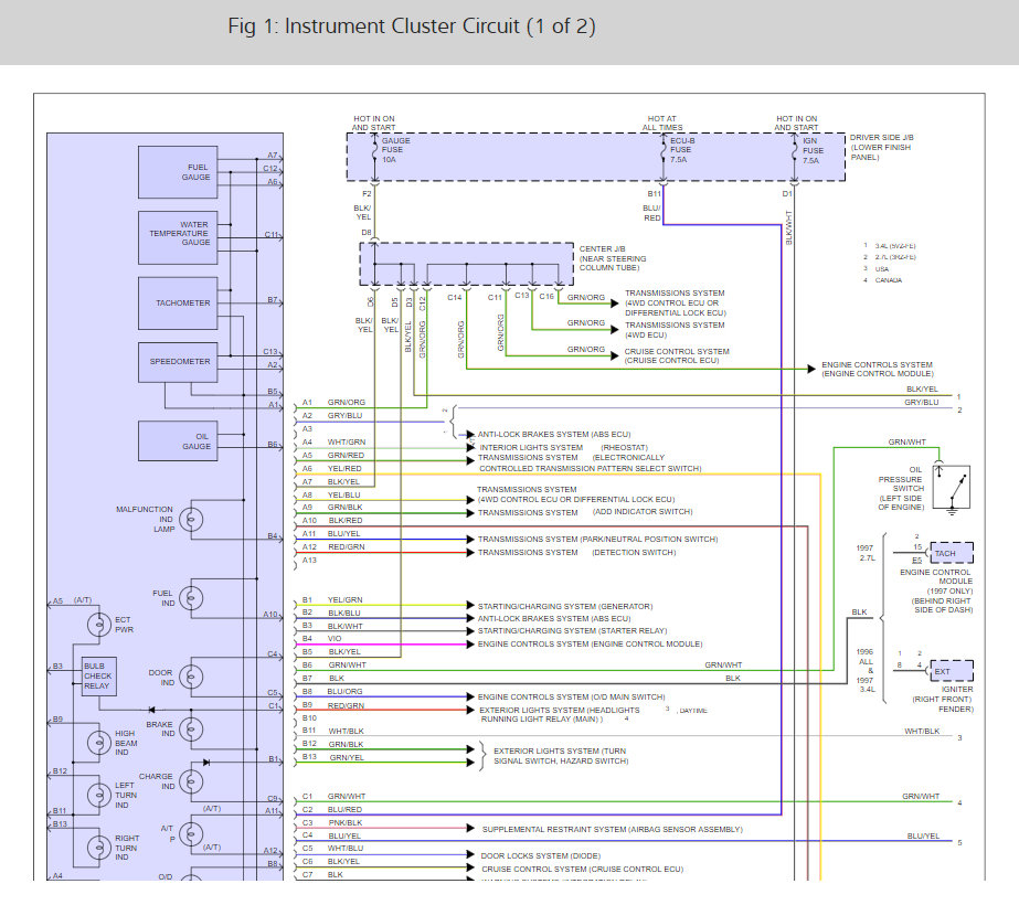

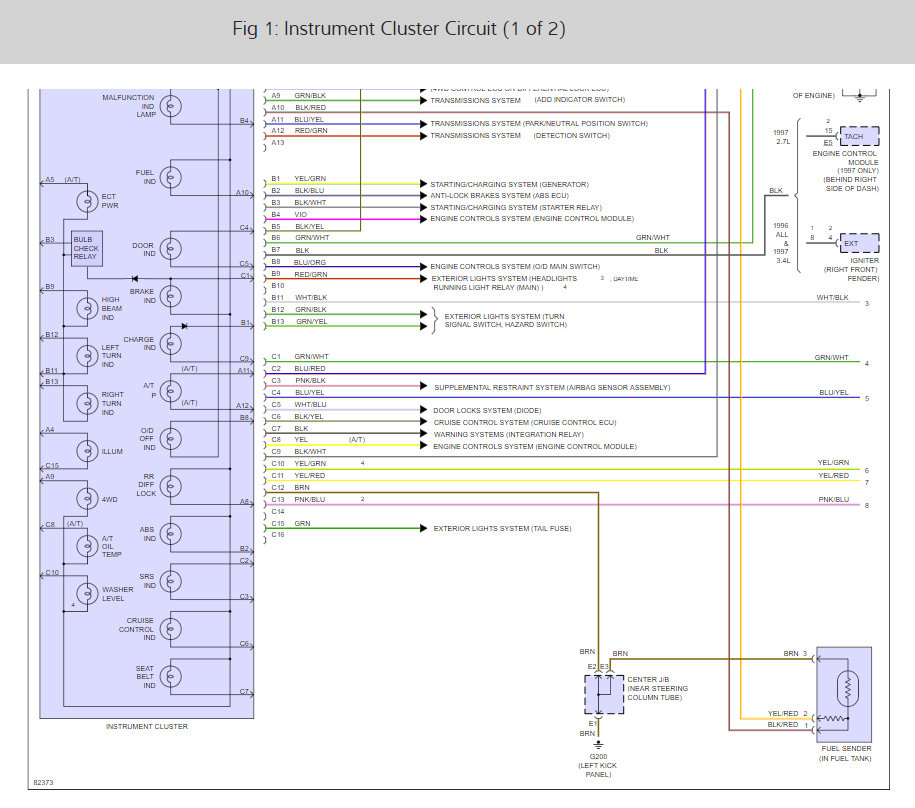

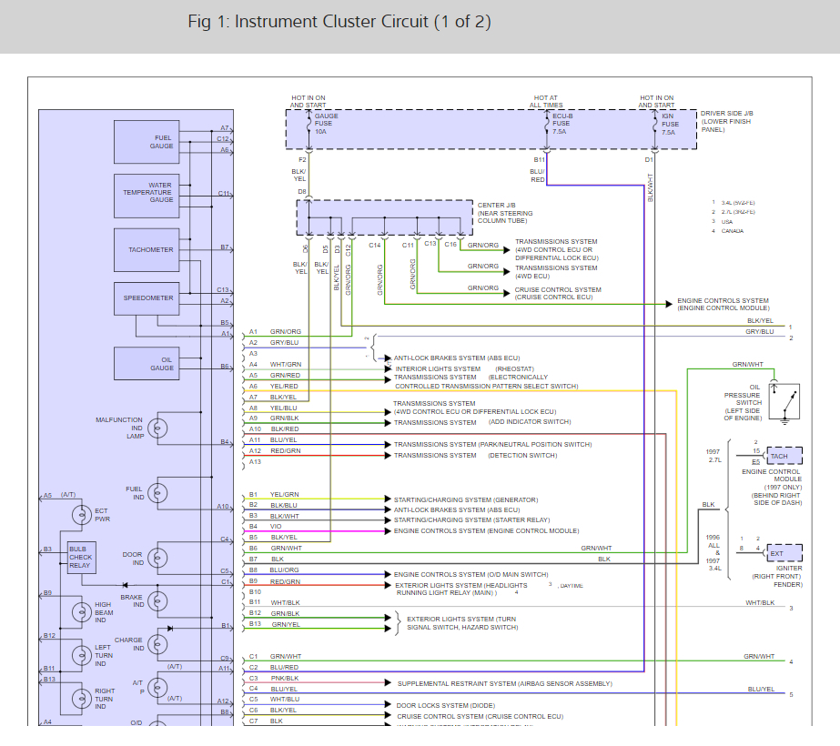

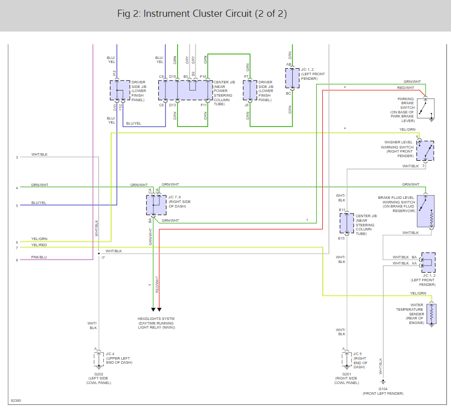

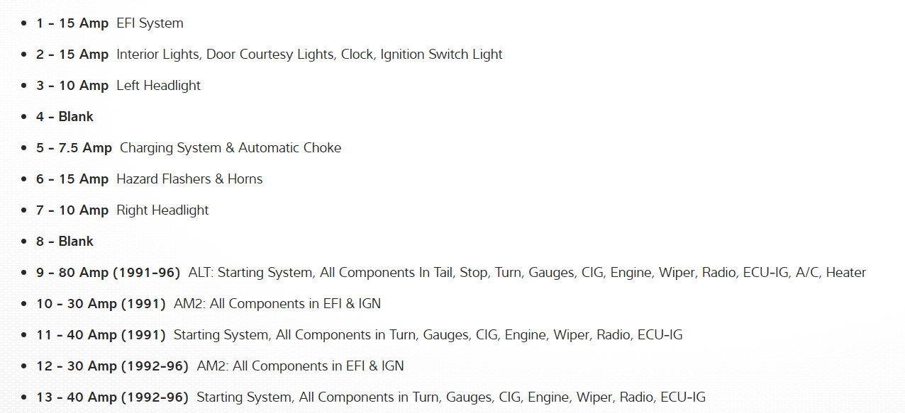

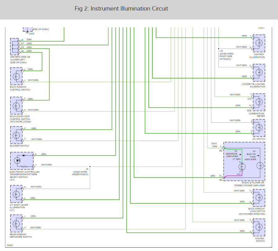

What fuse controls the dash board?
Jul 14, 2018 at 1:40 AM
Experienced Mechanic
55,561 POSTS

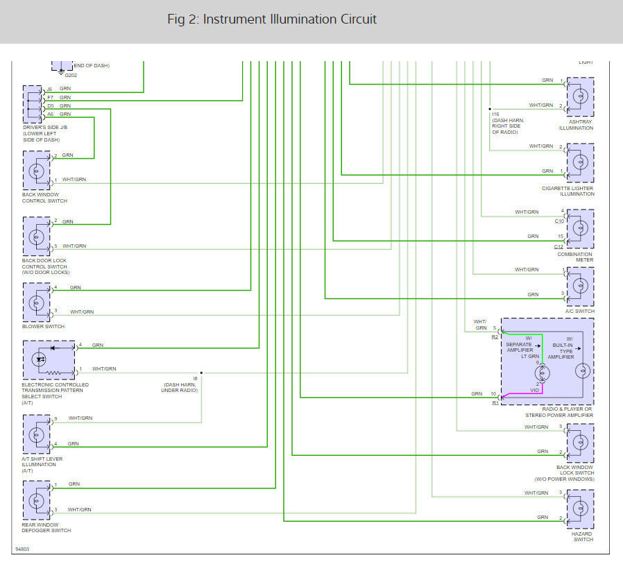

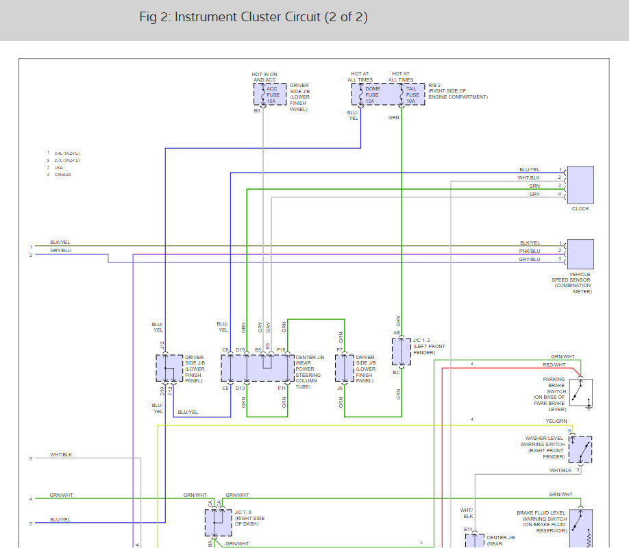

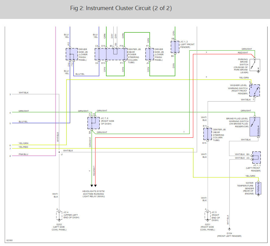

Hello, there are three fuses that control the dashboard. Here are the wiring diagrams so you can see which fuses they are and to check for power at the fuse as well using this guide:
Images (Click to enlarge)
