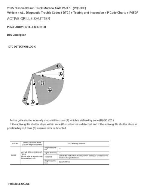

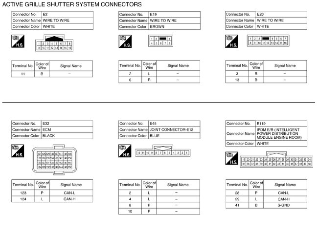

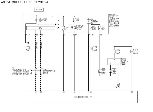

code P059F indicates that the active grille air shutter "A" had a performance problem or was stuck OFF for a predetermined period of time. The shutter does not move to the touch and no damage to the shutter. I'm guessing the fuse had an overload.
Oct 14, 2025 at 11:50 PM
KRAKENAUTO
  • 108 POSTS

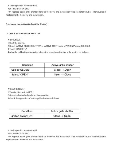

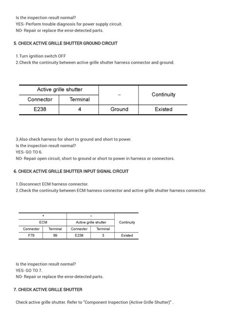

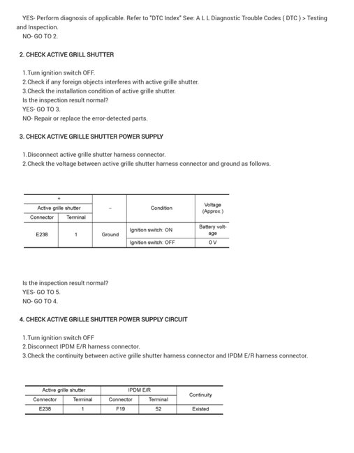

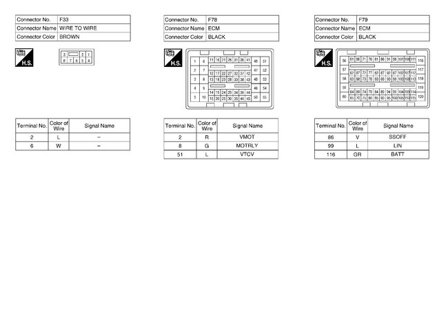

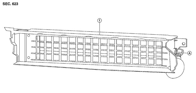

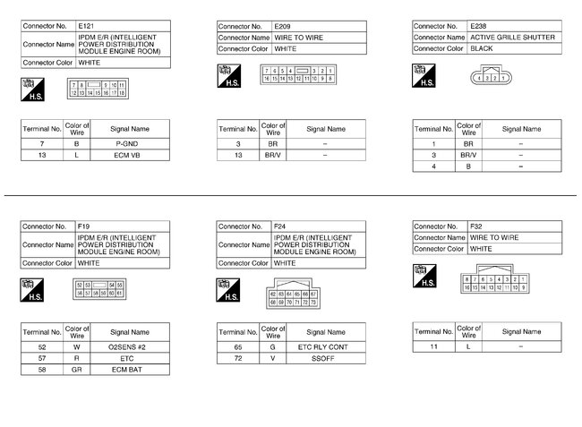

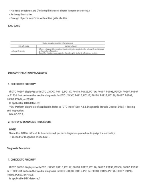

I have attached the diagnostic process as well as a couple wiring diagrams and such to assist.
POSSIBLE CAUSE
- Harness or connectors (Active grille shutter circuit is open or shorted.)
- Active grille shutter
- Foreign objects interferes with active grille shutter
Oct 15, 2025 at 8:08 PM
