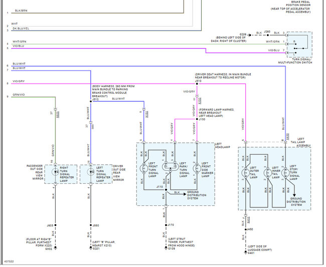

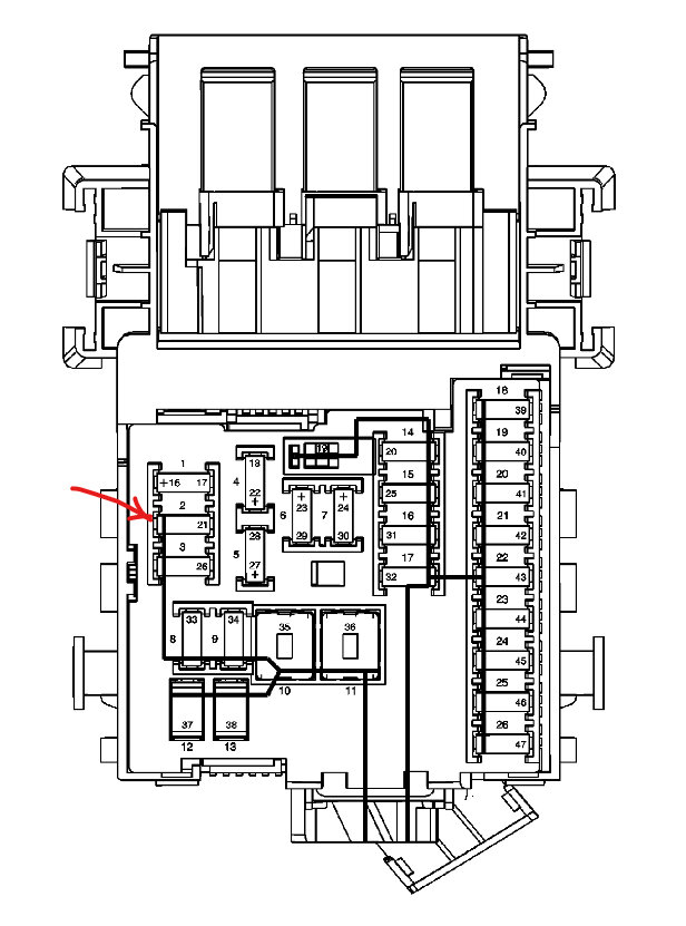

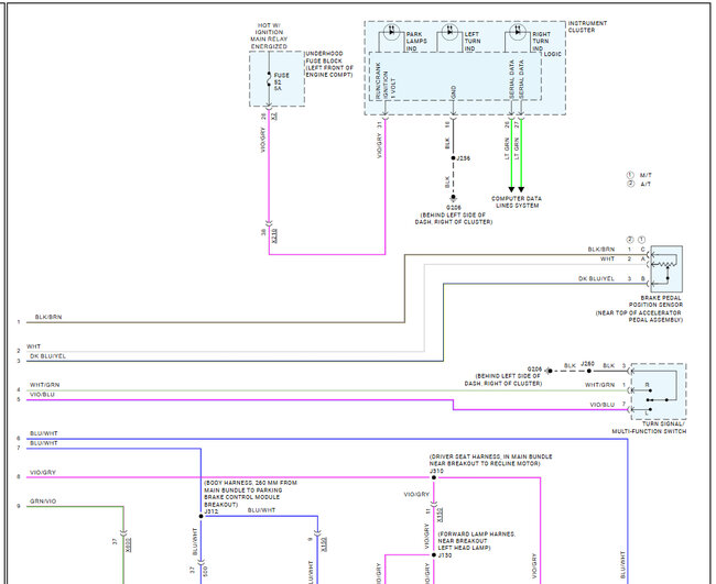

What fuse and location for rear turning signal?
196,664 MILES • TURBO • AUTOMATIC
CINDY CARPENTER
My turning signal is out?
Oct 26, 2024 at 1:02 AM
  • 55,649 POSTS

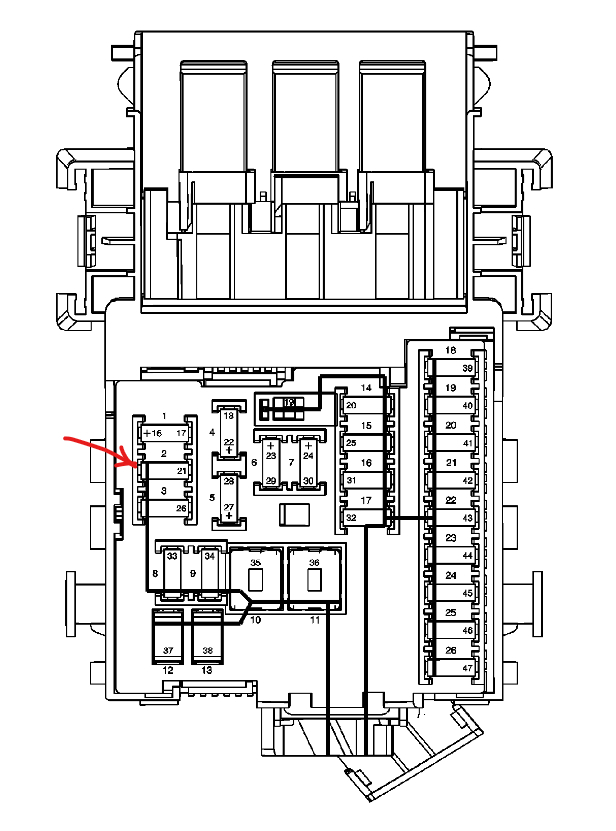

Sure it is fuse #2 in the fuse panel on the left lower side of the dash which I have included the location for in the images below.
Here are the turn signal wiring diagrams so you can see that the BCM handles the lighting distribution for the car which might be bad. Can I ask if any of the turn signals are working or lighting up at all? Please test the fuse with the ignition system on. Check out the images (below). Let us know what you find.
