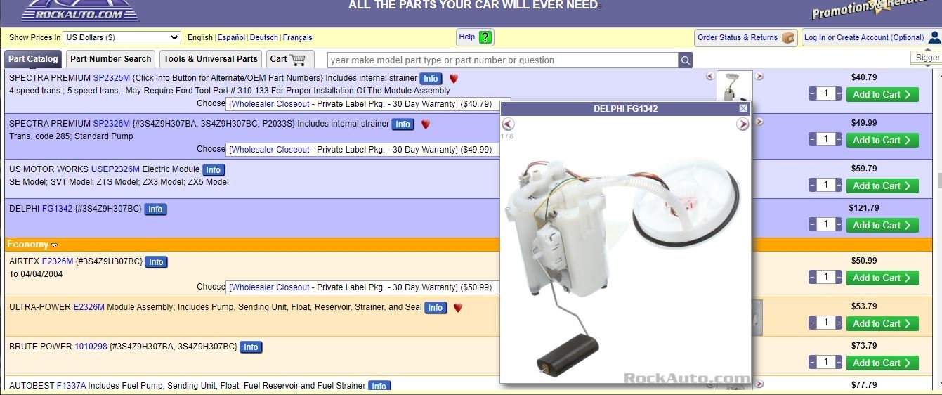

What fuel pump do I need to purchase to replace mine?
Jun 11, 2020 at 12:53 AM
  • CAR REPAIR CONTRIBUTOR

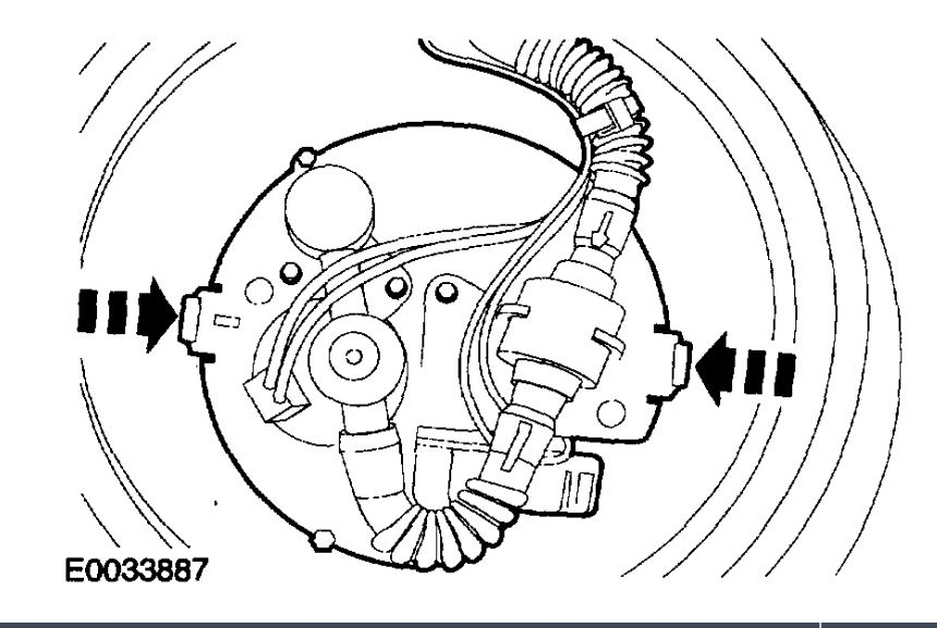

Good morning,
I attached the fuel pump you need for your car.
I also attached the procedure for you as well.

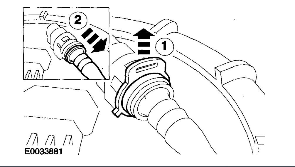

2. Disconnect the fuel supply tube from the fuel pump module.
1. Pull the red fuel line clip fully towards the fuel pump module.
2. While holding the red fuel line clip against the fuel pump module, firmly pull the fuel supply tube to disconnect it from the fuel pump module.

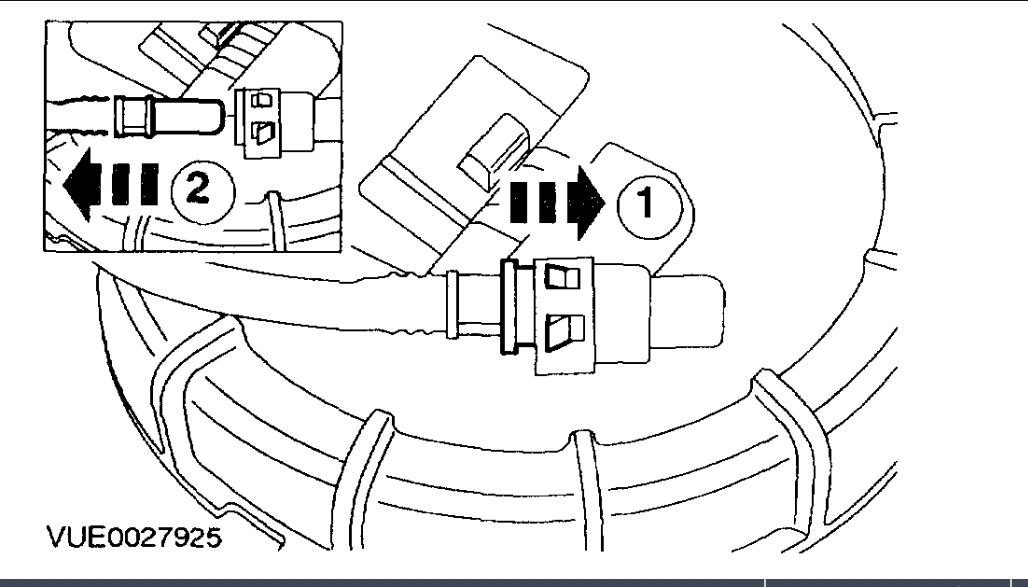

Vehicles built 08/2002 onward
3. Disconnect the fuel supply tube from the fuel pump module.
1 Remove the red fuel tube retaining clip from the fuel pump module.
2 While holding the red fuel tube clip against the fuel pump module, firmly pull the fuel supply tube to disconnect it from the fuel pump module.

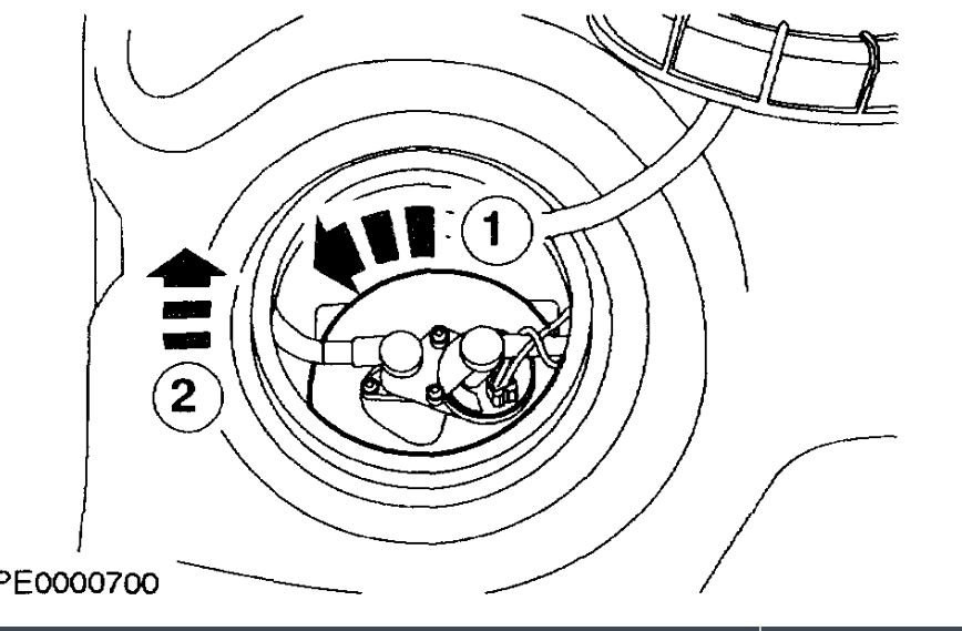

4. Using the special tool, remove the locking ring.
Vehicles built up to 08/2002
5. CAUTION: Make sure that the float or arm are not damaged while removing the fuel pump module.
Remove the fuel pump module.
1. Rotate the module counterclockwise.
2. Lift the module from the fuel tank.

6. CAUTION: Make sure that the float or arm are not damaged while removing the fuel pump module.
Release the fuel pump module locking tangs.
