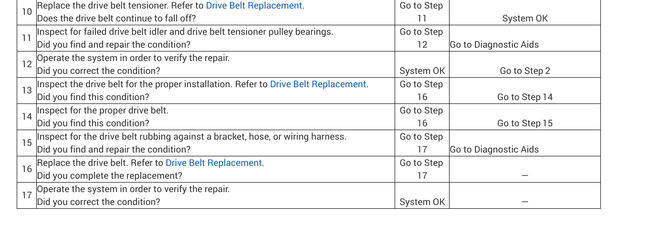

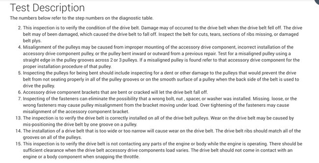

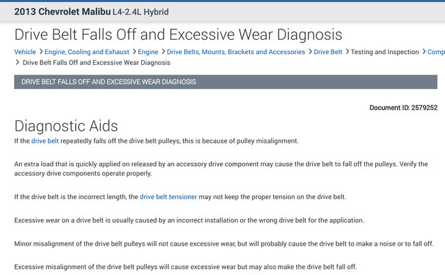

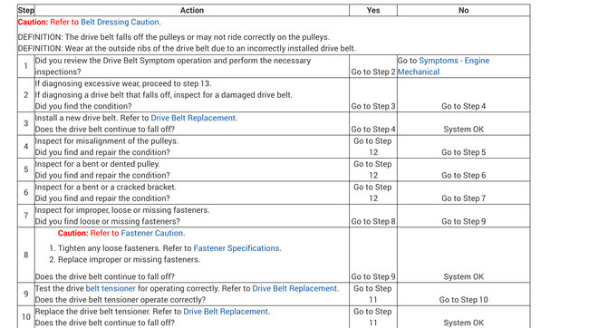

This could be a problem with the tensioner failing and causing the serpentine belt to slip off. To be sure that the tensioner is the problem, though, I have included in the diagrams down below a simple diagnostic troubleshooting guide for excessive drive belt slipping off the pulleys. This is from the vehicle manufacturer and should help you pin down the exact reason for this. Please go through this guide and get back to us with what you find out.

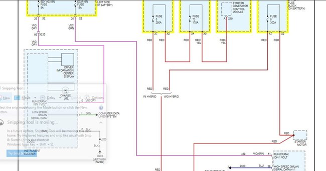

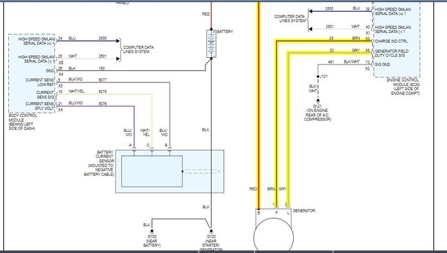

Good morning,
Can you check the voltage at the battery with the engine running?
What lights are still on?
Do you have a code reader to give me the codes?
