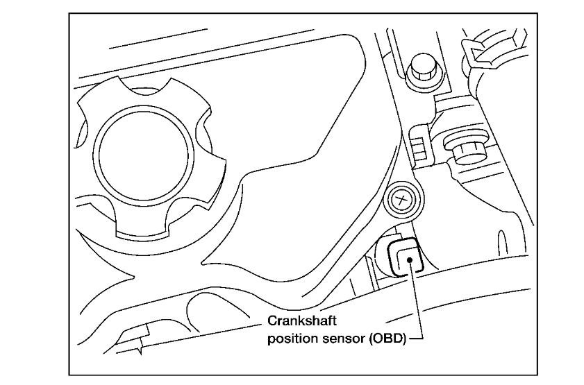

Have to replace the crankshaft sensor but the engine is not the original, so I am having issues locating it.
Mar 27, 2019 at 6:23 AM
Good morning,
The 3.3 is the only engine listed for your van.
Are you having trouble locating the new part or finding the crank sensor location?

We don’t see it as described in diagrams. I have the part. The people that have looked at it have also been unable to locate it. Plus the person I bought it from mysteriously is unable to get calls.
Mar 27, 2019 at 8:21 AM
Got it.
Again, there is not another engine listed for this van. It is the only location for the 3.3 engine for two years up and down as well.
It has to be there.

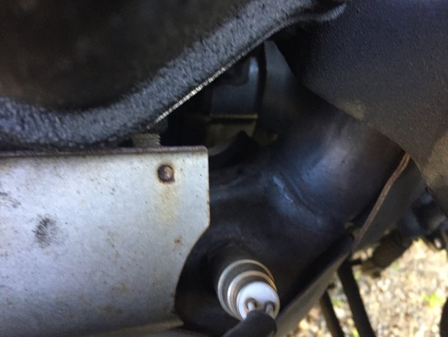

Can I take pictures and show you please?
Mar 27, 2019 at 8:30 AM
Sure. Make sure you take them of the back of the block at the bell housing,
Mar 27, 2019 at 8:33 AM
CLMARTIN47
  • 9 POSTS
I see the area but it appears to have tape over it could that be it?
Mar 27, 2019 at 8:36 AM
I need the pictures.

You may have to come up from the bottom to see it.

I added the picture where the tape is.
Mar 28, 2019 at 2:07 PM
What picture?
None showed up.
Mar 28, 2019 at 2:54 PM
CLMARTIN47
  • 9 POSTS
Is it showing up now? Sorry
Mar 28, 2019 at 3:18 PM
It looks like it may be under the tape.
Mar 28, 2019 at 3:23 PM
CLMARTIN47
  • 9 POSTS
Awesome! Was nervous to remove it. You Rock!
