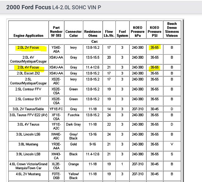

A lean fuel mixture is usually a result of an engine vacuum leak. If you are sure there aren't any, by any chance do you have an exhaust leak before oxygen sensors? For example, is there a leak at the exhaust manifold?
I ask because an exhaust leak can indicate a lean fuel mixture. Also, it could be related to low fuel pressure. Have you checked the pressure to make sure it is within the manufacturer's fuel pressure specifications? If you haven't. I recommend doing it.
Here is a link that explains how to check pressure:
You will need a fuel pressure gauge. However, most parts stores will lend one to you. I attached the manufacturer's fuel pressure specifications for you below.

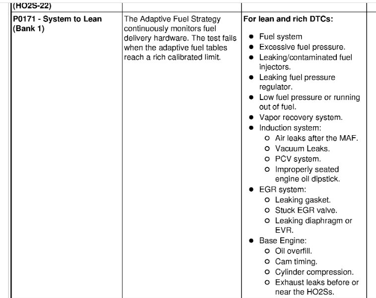

Let me know. Also, I attached a pic below showing the possible causes related to the P0171.
Take care and let me know what you find.
