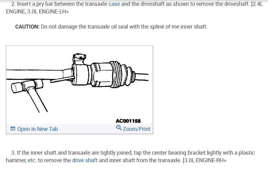

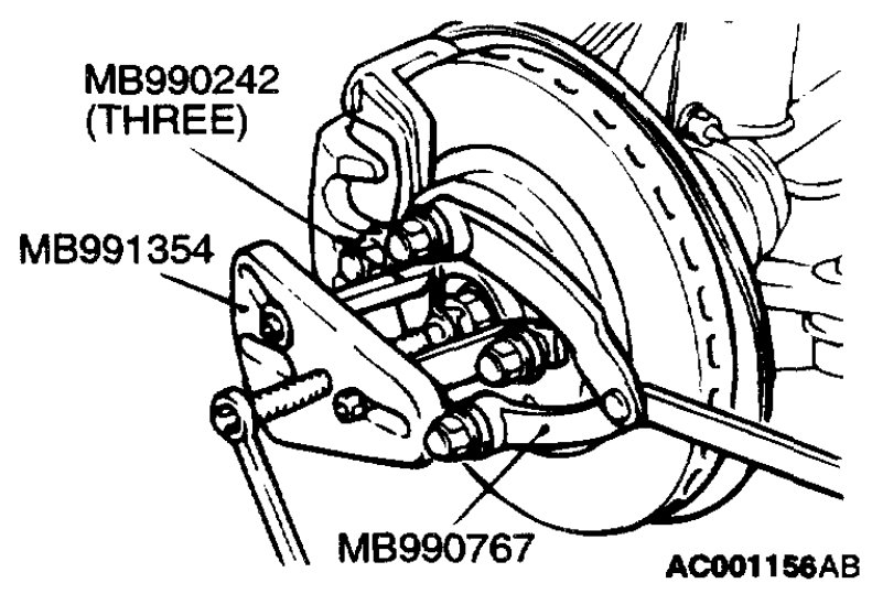

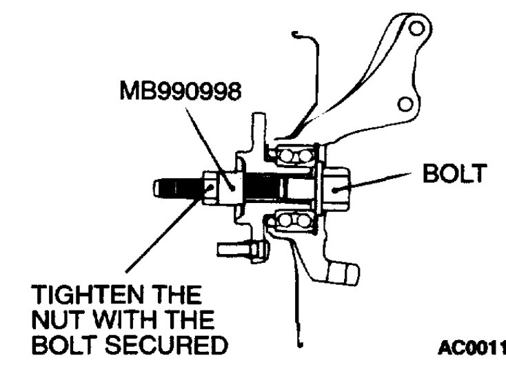

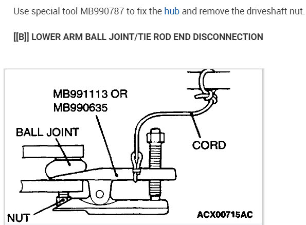

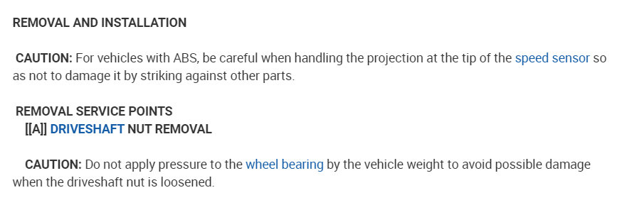

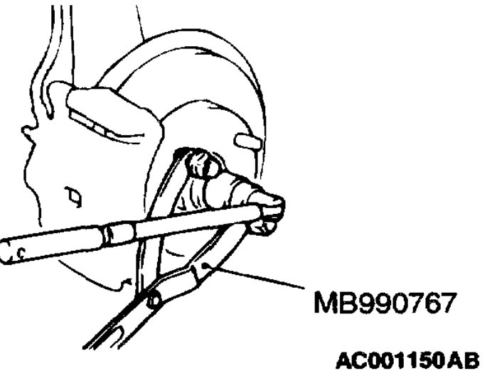

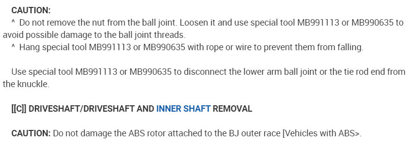

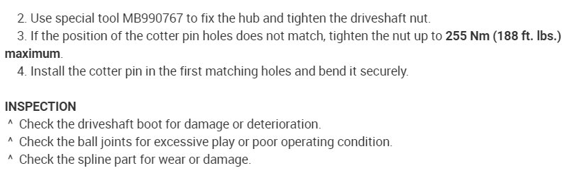

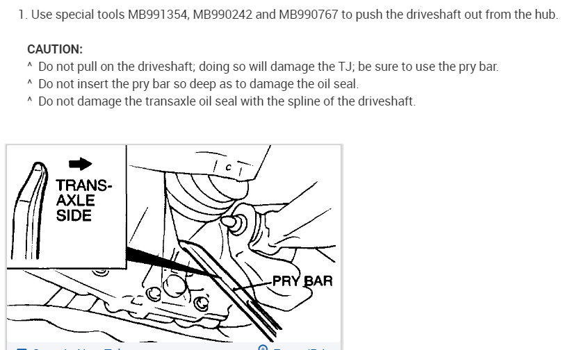

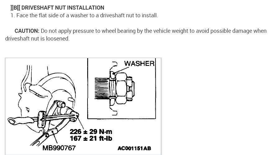

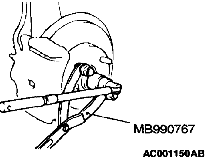

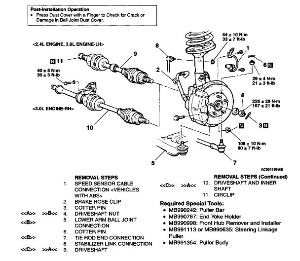

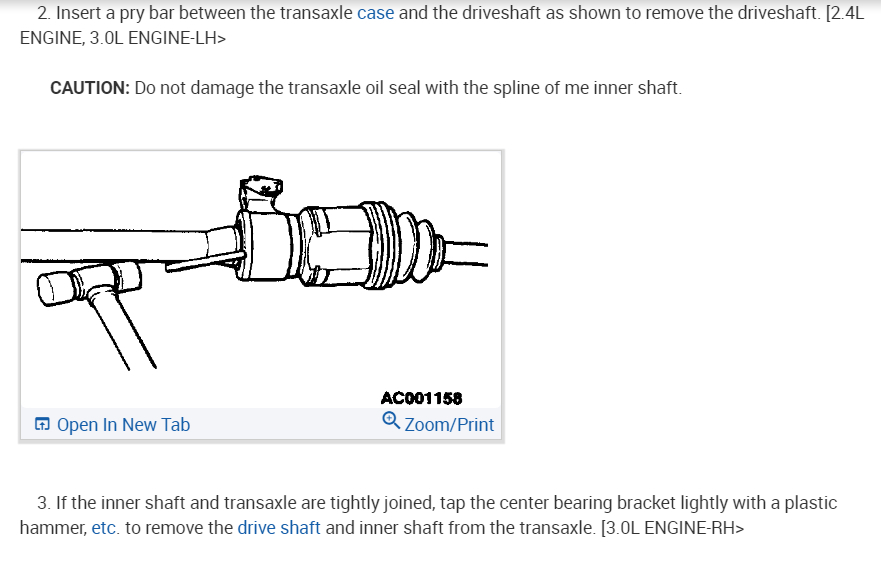

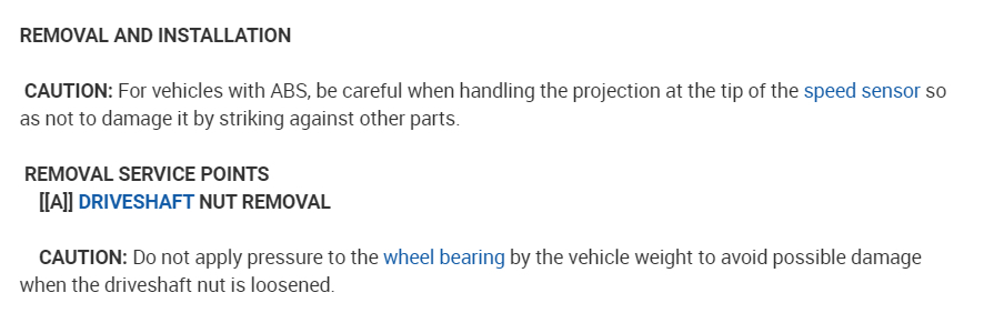

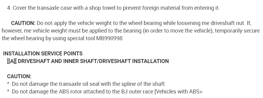

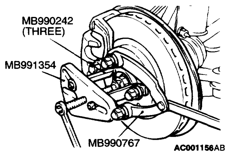

Here are the answers to the questions you asked.The only time you need to do a power steering flush is when the system is contaminated.Contamination can also be caused by having a leak and different or the wrong type power steering fluid.If fluid looks good then no reason to flush.Sounds like you have changed most of the important steering and suspension components so yes, It would be wise to hold off on an alignment until after you replace the CV axles.Here is a tutorial showing what is involved for replacement of CV axles:
https://www.2carpros.com/articles/replace-cv-axle
I've attached step by step picture instructions below for the CV axle replacement for your Eclipse below.Hope this helps and thanks for using 2CarPros.

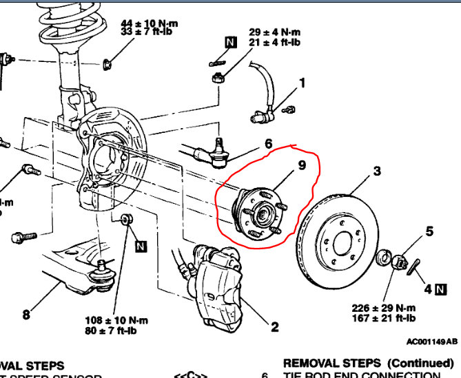

Great explanation. When do I know to replace the wheel bearings? On my right front wheel I had slid into a curb on an icy hill very hard at 30 mph or so. This manifested in the strut breaking loose and eventually needing to replace the tie rods and lower control arm, the wheel was real loose and wobbly for quite some time before tie rods and control arm were replaced. I've also had to replace the actual rims themselves on the right front and right back, the spokes were actually breaking off and the rims were collapsing. I'm replacing all brake hardware and CV's so I want to do anything else that's down there at the same time.

Your front suspension incorporates a whole wheel hub assembly that is the bearings. You will already be removing it to change the CV axle so if you feel it is worn or defective you might want to consider installing a new one when reassembling. Here is a tutorial showing how to replace a hub assembly. The step instructions were included in my prior response.
https://www.2carpros.com/articles/bearing-hub-replacement
I've attached a picture from my prior response and circled the hub assembly in red.Hope this helps and thanks again for using 2CarPros.
