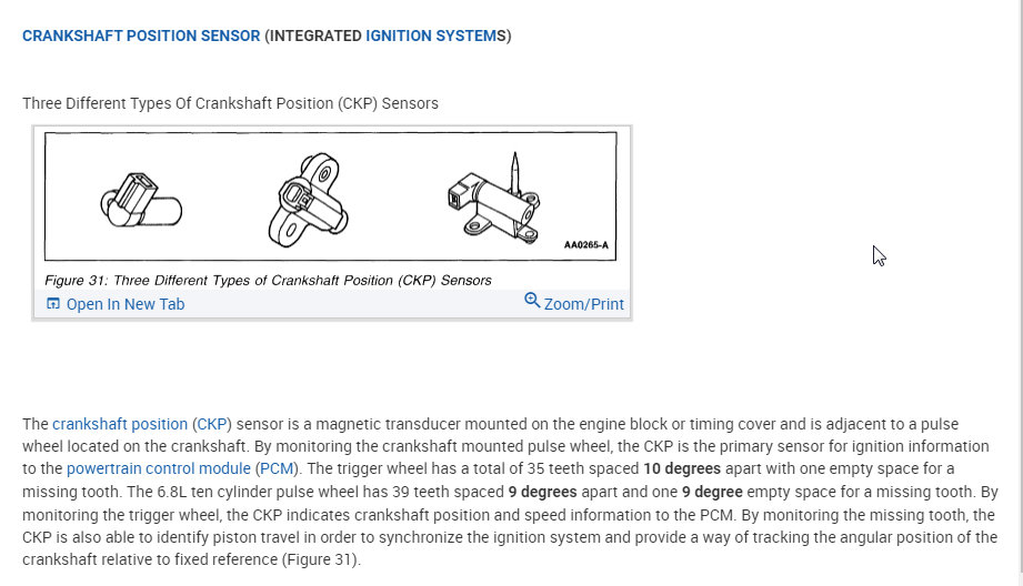

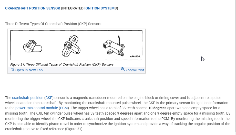

Okay. Couple things first. You said it did crank and then you said it would not do anything. After you put the PCM and keys does it crank and not start? Meaning the engine spins over when starting it but it doesn't start.
Next thing is we need to find out if we still have codes. The fact that we don't have spark or fuel sounds like a crank sensor issue. We can get into that when we find out what codes we have and clarify what it is doing now.
