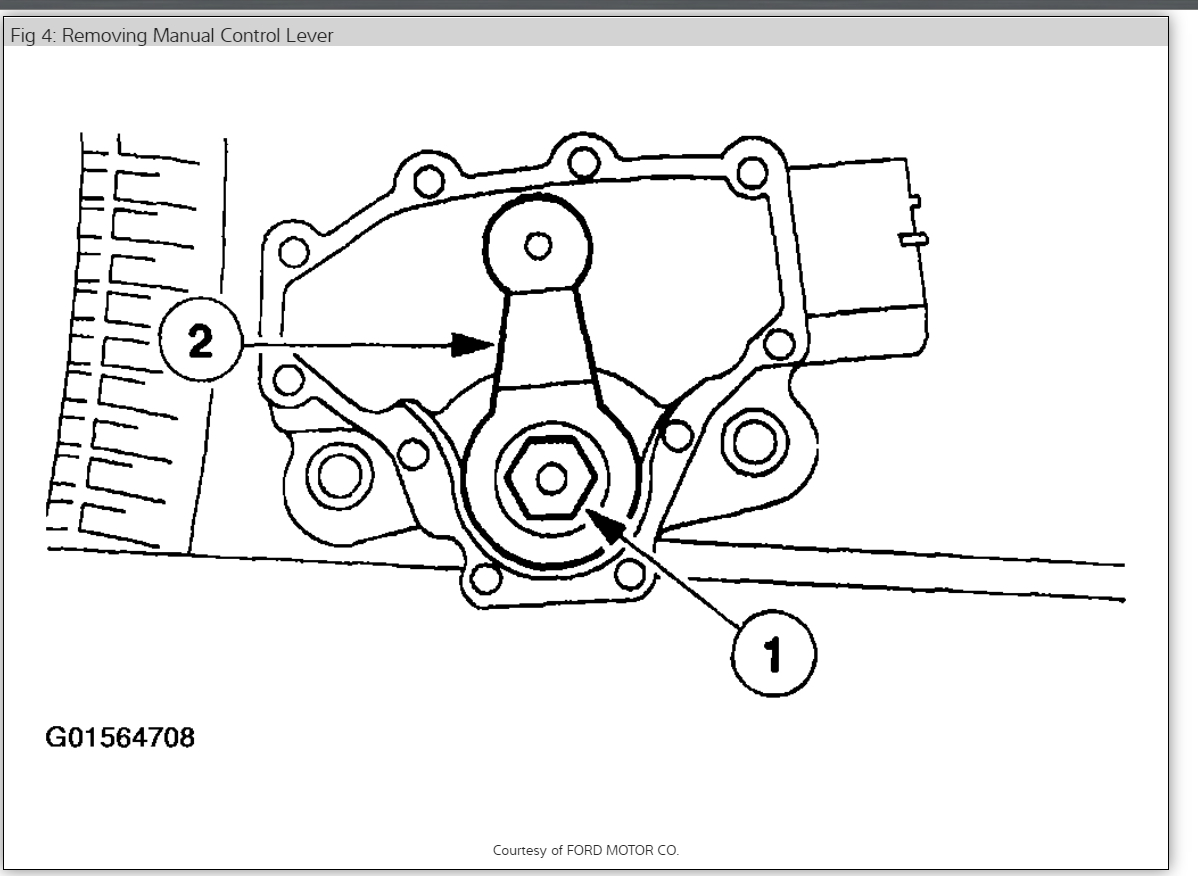

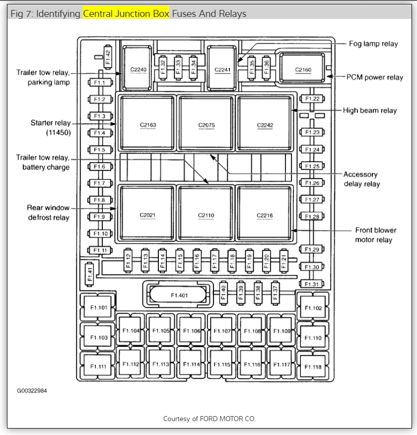

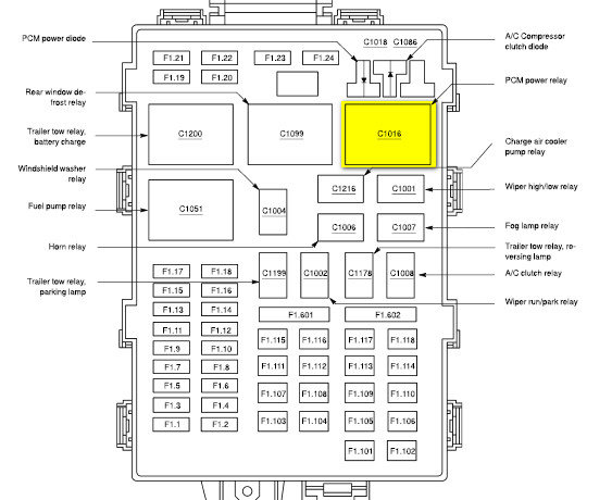

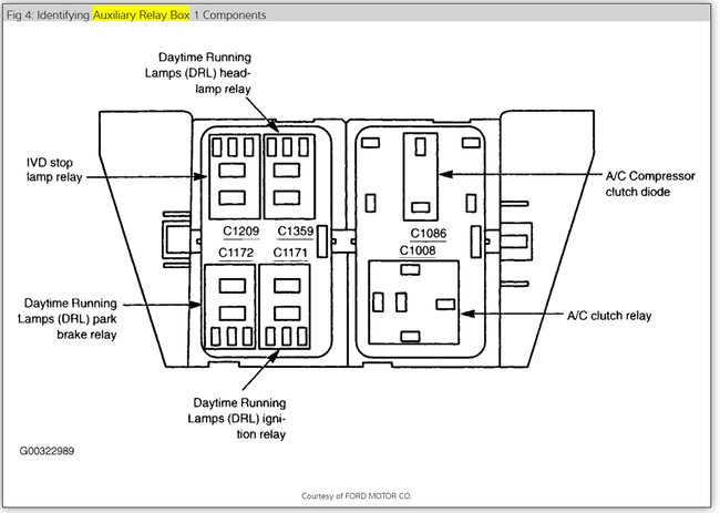

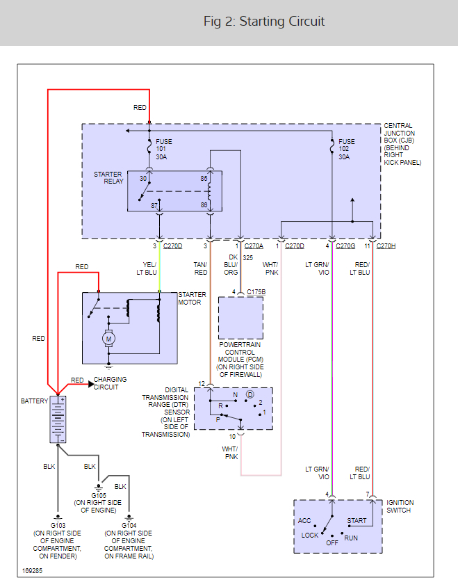

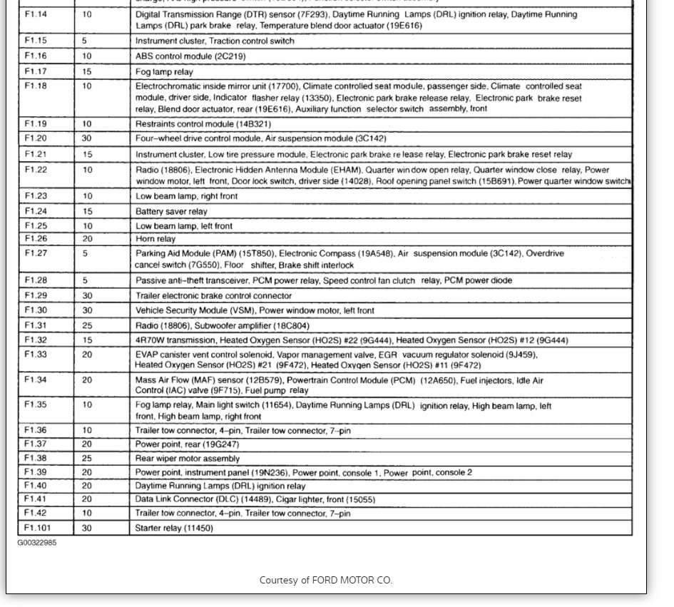

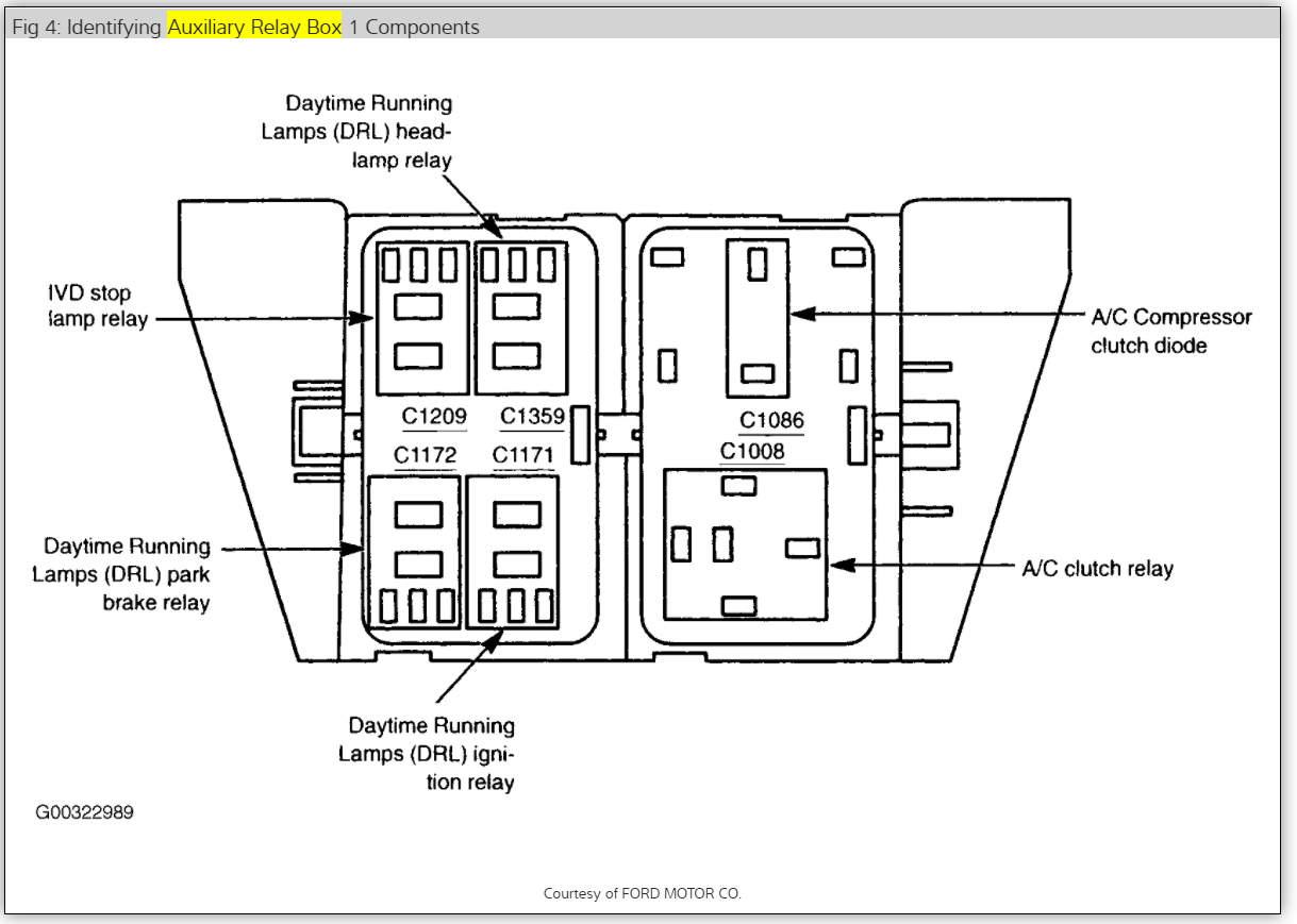

Sounds to me like a inoperative transmission range indicator you should check the wiring harnesses for the transmission. Also I have seen where the PCM relay cause this problem.
Here is a wiring diagram and a guide to help you check the problem out.
Here are the fuse and relay locations (below)

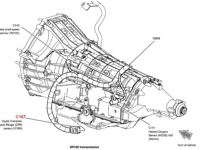

Would the transmission range indicator be toward the front or back, left or right side. I see a small package with four wires but that's about it. Would I get to it from underneath?

That one has a lot of wires in it. I am going to get the colors and post. See the attached picture for the fuse panel location where it is plugged into.

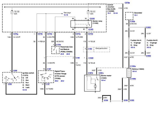

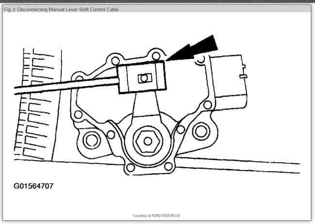

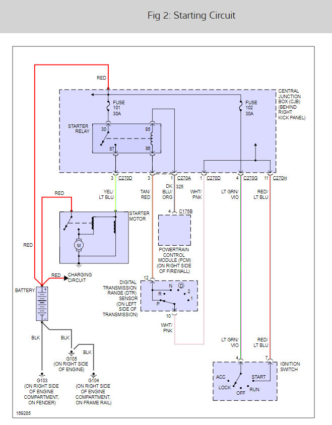

Here is a starter wiring diagram and a guide to help you test it.

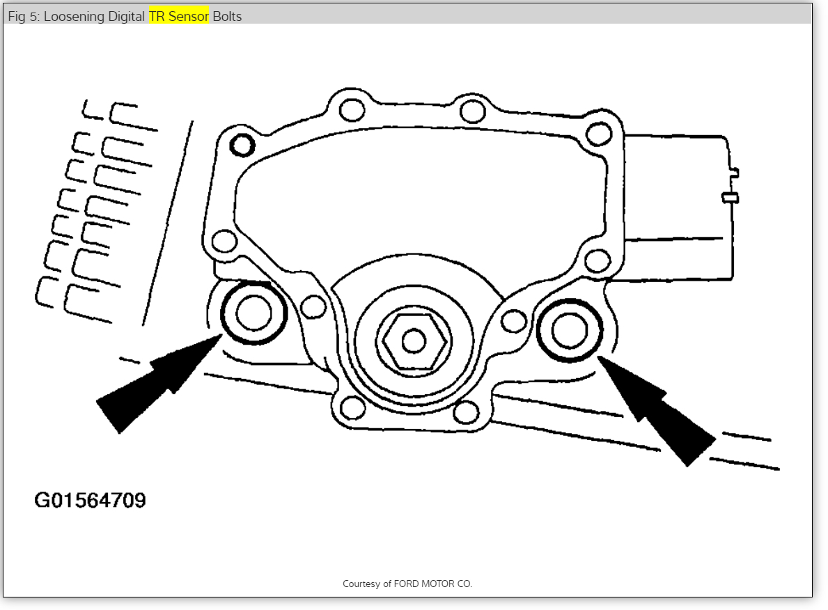

The PRNDL switch are range sensor switch is located on the transmission at the gear selector lever. Driver side.
Here is a guide that can help you do some testing

After doing some test, I think the DTR sensor and wiring are fine. If I remove the connector I told you about above and attempt to start the car in anything other than park/neutral, it will not crank. If it is in park/neutral, it cranks fine. I think we have eliminated the ignition switch and DTR. What about the PCM? If I use the wiring diagram up above and check the coli voltage between 85/86 of the starter relay, I get six volts.
If I remove the fuse for the PCM, I get a full twelve volts and the car cranks.
With the fuse in, I am still getting the PRNDL error on the car's "message center".
Any ideas?

I have this one solved finally. I ended up renting a OBDII diagnostics scanner. The scanner would not read any data, so I checked all PCM fuses and relays. One of the relays was bad, so once I replaced it, all was good. This would have been much easier if it would not have been for the PRNDL error that was displayed.

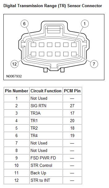

Digital transmission range (TR) sensor.
The digital transmission range (TR) sensor is located on the outside of the transmission at the manual lever. The sensor completes the start circuit in park and neutral, the back-up lamp circuit in reverse and a neutral sense circuit for GEM control of 4x4 low engagement. The sensor also opens/closes a set of four switches that are monitored by the power-train control module (PCM) to determine the position of the manual lever (P, R, N, (D), 2, 1).
Check for codes.
