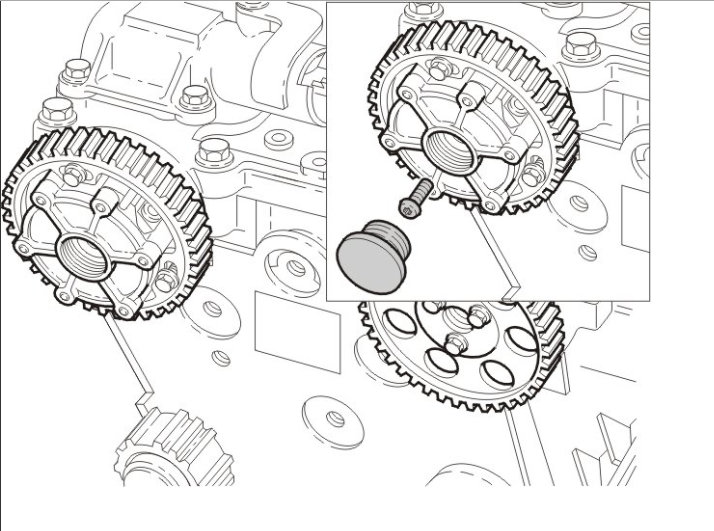

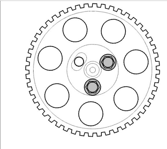

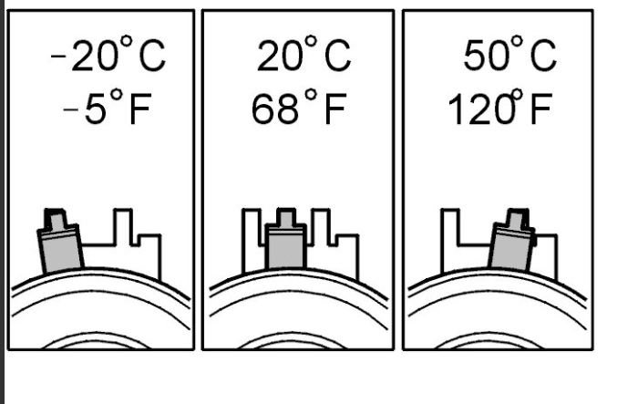

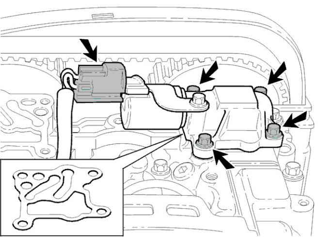

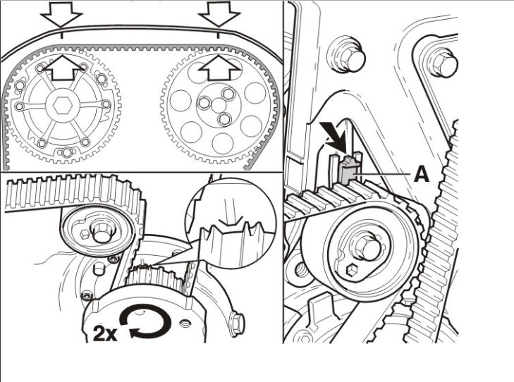

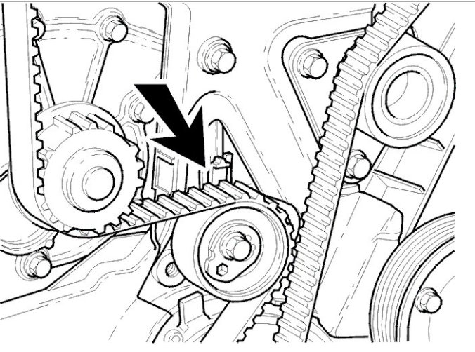

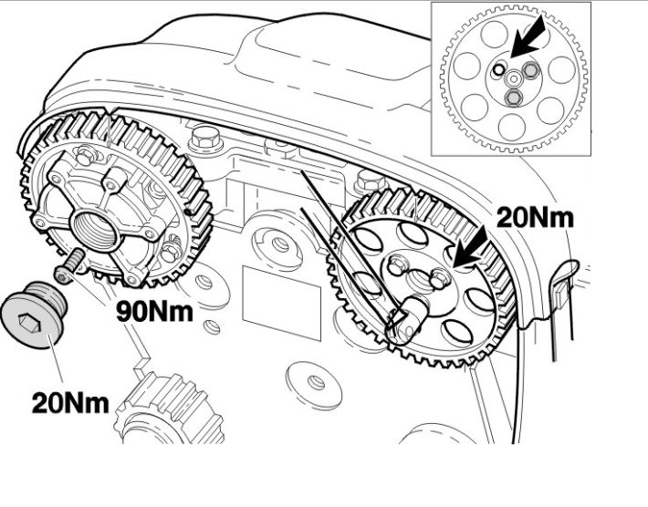

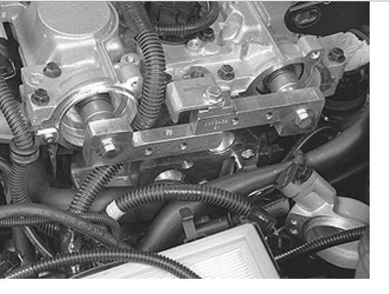

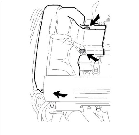

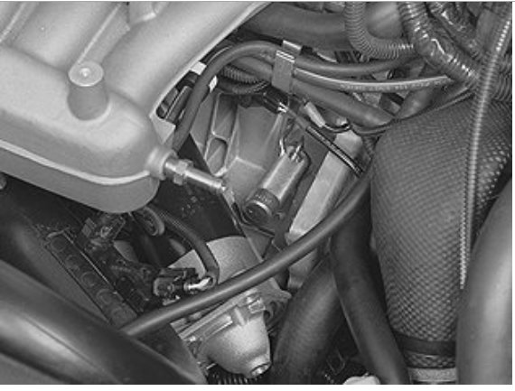

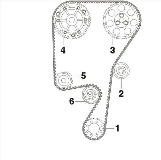

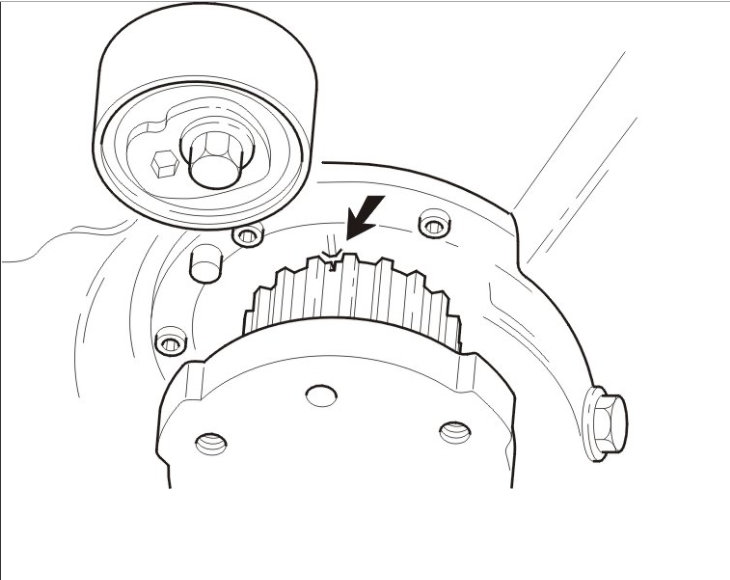

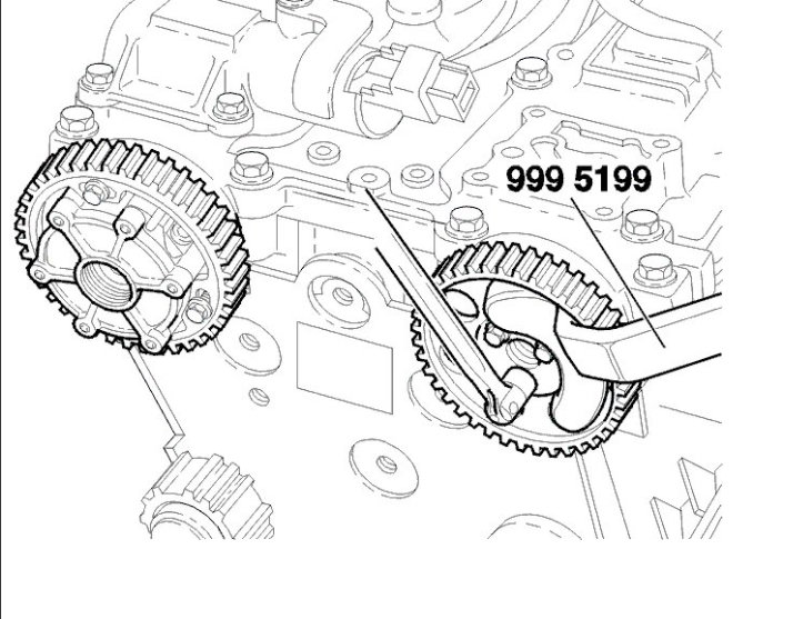

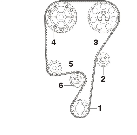

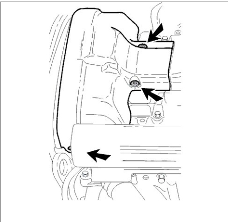

This codes is thrown when the camshaft actuator (phaser) is not working correctly usually due to one of two things. The most popular is a failing camshaft actuator but I have also seen the oil control valve become clogged up due to lack of maintenance.
Here is a guide to show you how the system works:
https://www.2carpros.com/articles/how-camshaft-variable-valve-timing-works
Below are some guides to show you what you are in for when fixing this problem.
