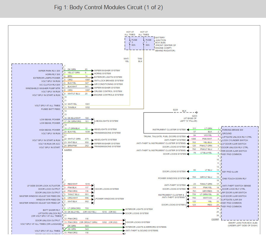

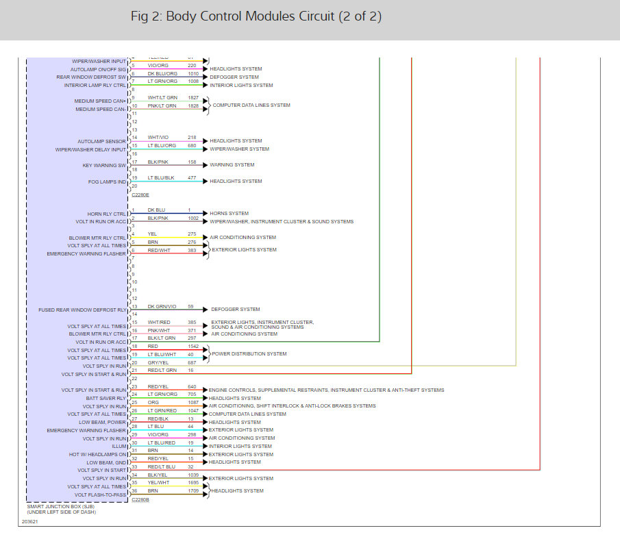

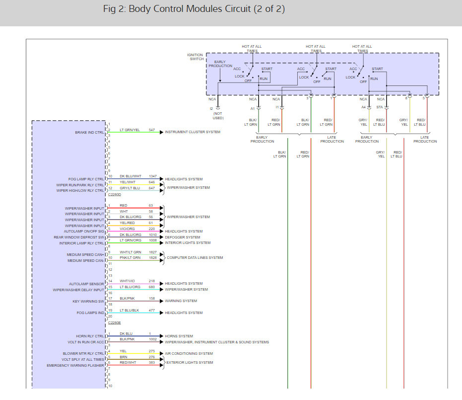

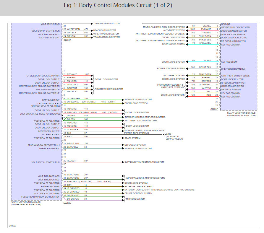

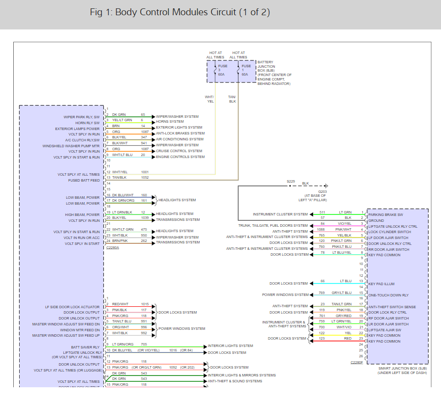

Almost all lights on dash are lighting up. Battery being drained to no power. My vehicle is the SE wagon.

Here are the BCM wiring diagrams so you can see how the system works and what it controls. Check out the diagrams (below). Please let us know if you need anything else to get the problem fixed.
