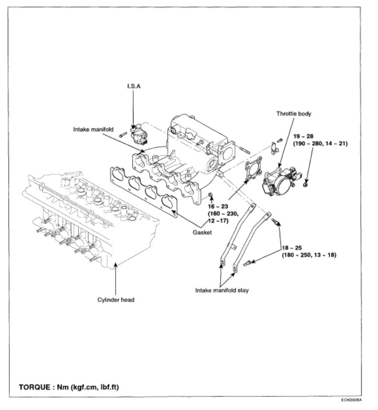

What does it mean when I have to pump gas pedal to start car?
2007 HYUNDAI TUCSON
126,760 MILES
ALICEA SWENKA
I have had my starter, alternator and battery checked and they are all good. But it still has a hard time trying to start?
May 3, 2022 at 1:21 PM
  • 54,840 POSTS

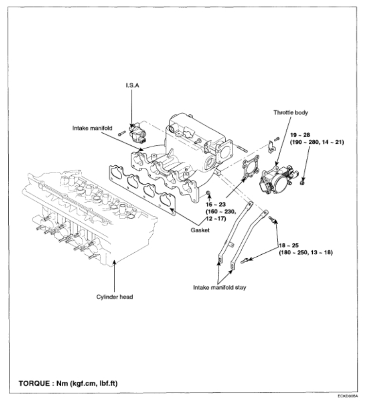

This sounds like you have a throttle body and idle air control valve that is dirty and needs to be serviced which is normal for the miles, what happens is the gunk or choking as they call it inhibits the operation of the throttle body and IAC. Here are two guides with diagrams below to show you how:
and
https://www.2carpros.com/articles/idle-air-control-valve-service
