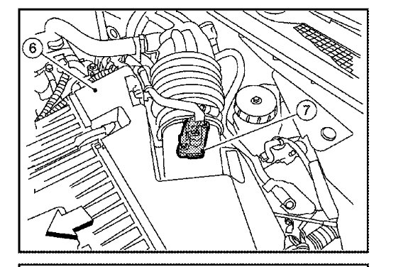

A solid service engine light just came on. About 10 months ago, I replaced the spark plugs and the o2 sensor I front of the catalytic converter. I had the big, more central, catalytic replaced 2 years ago. Could the oxygen sensor have gone bad? I also replaced the thermostat and coolant got everywhere because I’m an idiot..so maybe that ruined the new o2 sensor, but I don’t think it’d take 8 months to show. Help!

You are okay, how does the engine seem to run? Also do you have any exhaust leaks? I don't think the oxygen sensor is bad. I have seen the MAF sensor cause this problem, you can try cleaning it but if that doesn't work replacement is required. This guide can help:
https://www.2carpros.com/articles/mass-air-flow-service

My car is driving find. No idling issues at all. I replaced the upstream o2 sensor and soaring plugs about 10 months ago. I replaced the rear catalytic converter, the one connected directly to the exhaust, 2 years ago. I ordered a new MAF sensor that I’ll put in this weekend. I’m also waiting for my gas tank to empty to put some Cataclean it, but so far, no issues, just the solid service engine light and the multiples places I went all showed the P2423 code.
