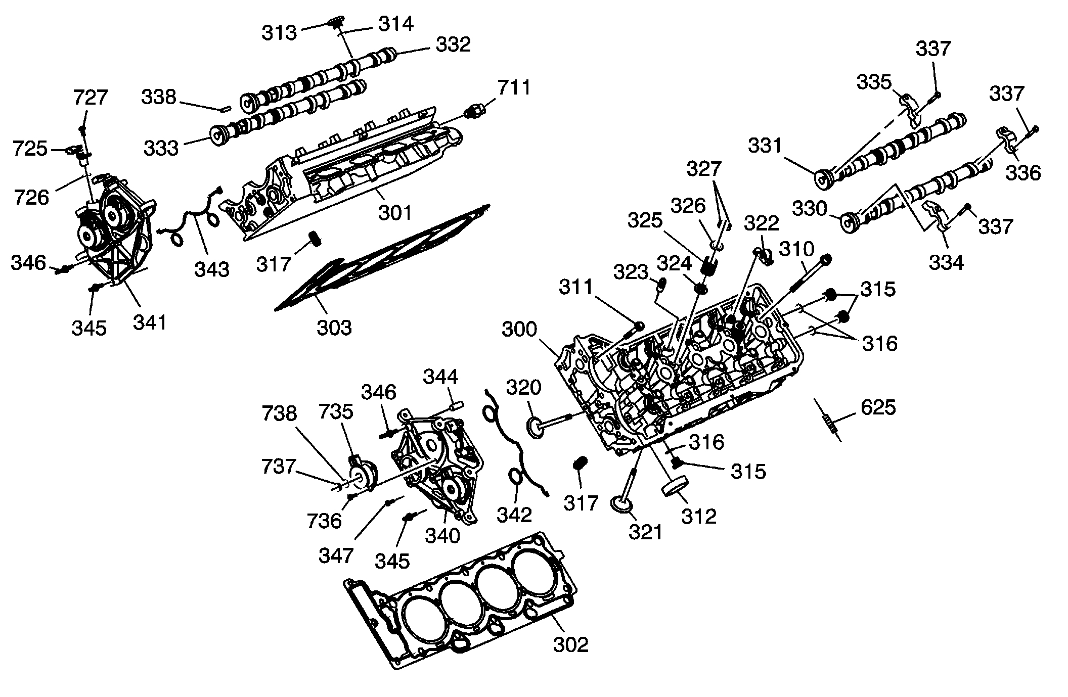

It sounds like there is an issue with the valve seal in the cylinder. The engine valves are in the cylinder head above the cylinder. Often times, the seals will deteriorate allowing oil to bypass them and enter the cylinder through the valve. Additionally, there could be an issue with the valve guide itself. The result is blue smoke on start up and often times heavy acceleration. When driving at a normal pace, you will not see the oil being burned. I attached an exploded view of the cylinder head. Locate item number 324. That is the seal I am referring to. Here is the legend for all the parts listed in the picture:
300 - Left Cylinder Head
301 - Right Cylinder Head
302 - Left Cylinder Head Gasket
303 - Right Cylinder Head Gasket
310 - Cylinder Head Bolt - M11
311 - Cylinder Head Front Bolt - M6
312 - Cylinder Head Coolant Hole Expansion Plug
313 - Cylinder Head Coolant Hole Plug
314 - Cylinder Head Coolant Hole Plug Seal Ring
315 - Cylinder Head Oil Gallery Plug
316 - Cylinder Head Oil Gallery Plug Ring
317 - Engine Oil Gallery Restrictor
320 - Exhaust Valve
321 - Intake Valve
322 - Valve Rocker Arm Assembly
323 - Hydraulic Valve Lash Adjuster Assembly
324 - Valve Stem Oil Seal
325 - Valve Spring
326 - Valve Spring Cap
327 - Valve Stem Key
330 - Left Exhaust Camshaft
331 - Left Intake Camshaft
332 - Right Intake Camshaft
333 - Right Exhaust Camshaft
334 - Cylinder Head Front Camshaft Cap
335 - Cylinder Head Front Camshaft Cap
336 - Cylinder Head Camshaft Cap
337 - Cylinder Head Camshaft Cap Bolt
338 - Camshaft Sprocket Locating Pin
340 - Left Camshaft Position Actuator Housing
341 - Right Camshaft Position Actuator Housing
342 - Left Camshaft Position Actuator Housing Gasket
343 - Right Camshaft Position Actuator Housing Gasket
344 - Camshaft Position Actuator Housing Pin
345 - Camshaft Position Actuator Housing Stud - Short
346 - Camshaft Position Actuator Housing Stud - Long
347 - Camshaft Position Actuator Housing Bolt
625 - Cylinder Head Exhaust Manifold Stud
711 - Engine Coolant Temperature Sensor
725 - Camshaft Position Sensor
726 - Camshaft Position Sensor O-Ring
727 - Camshaft Position Sensor Bolt
735 - Camshaft Position Actuator Magnet
736 - Camshaft Position Actuator Magnet Bolt
737 - Camshaft Position Actuator Magnet Plug
738 - Camshaft Position Actuator Magnet Plug O-Ring

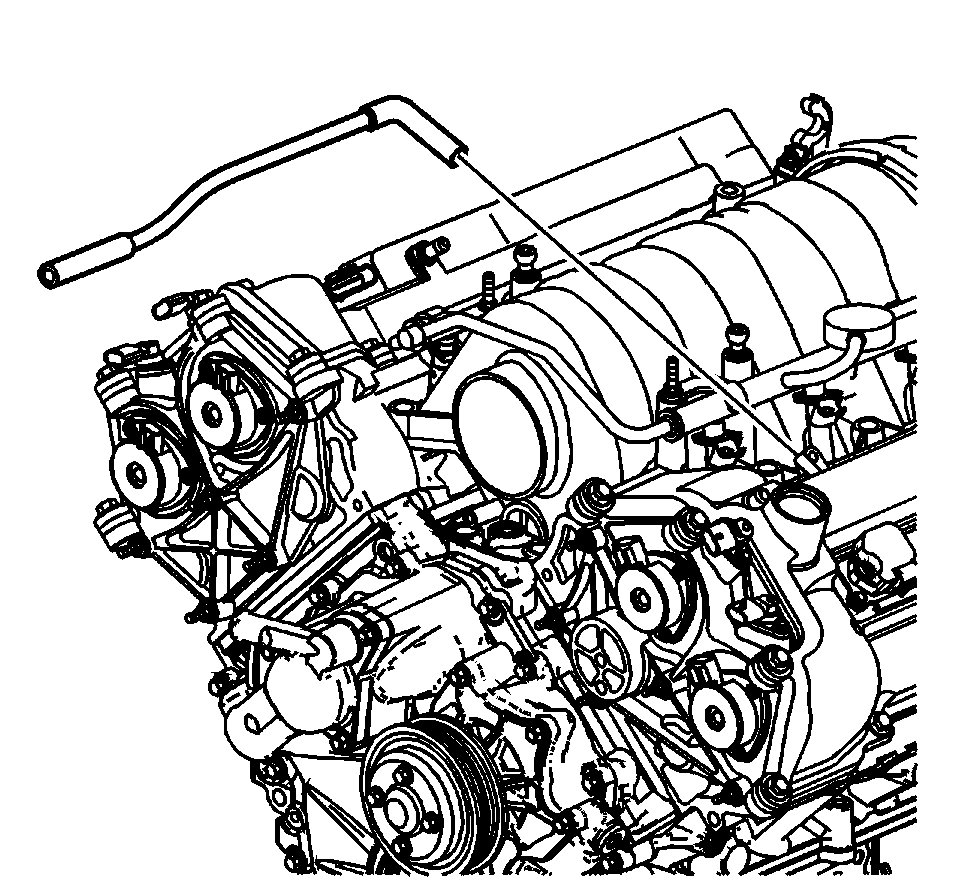

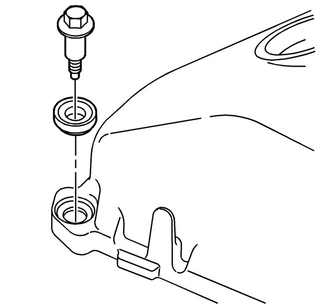

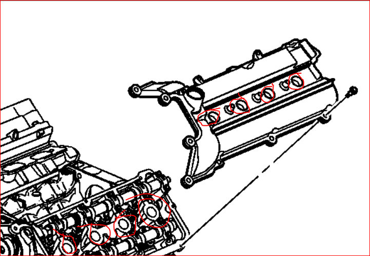

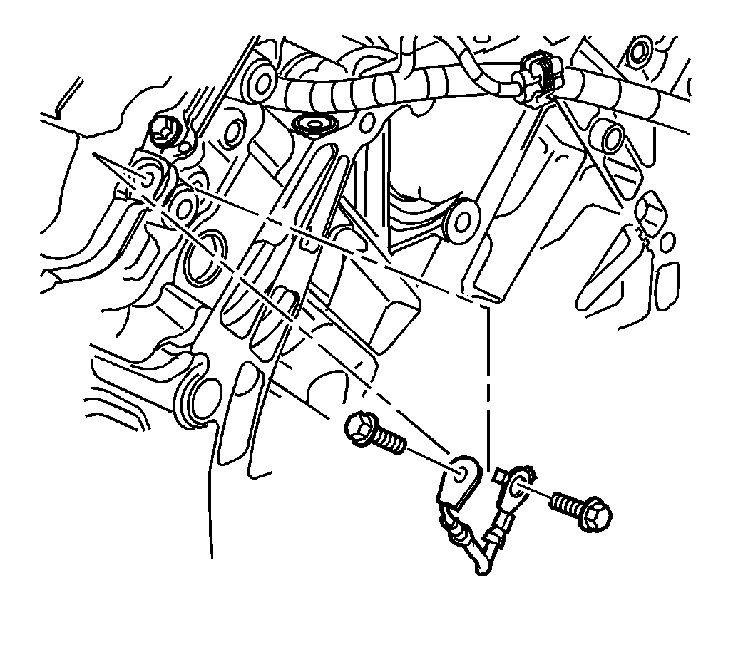

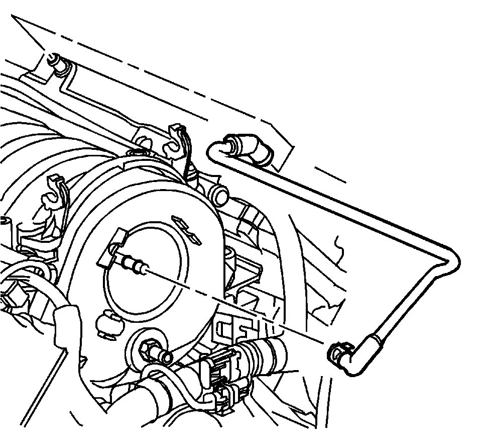

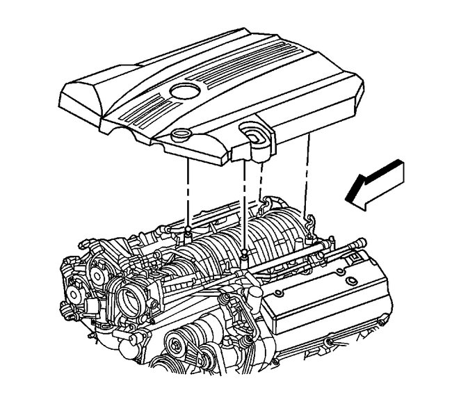

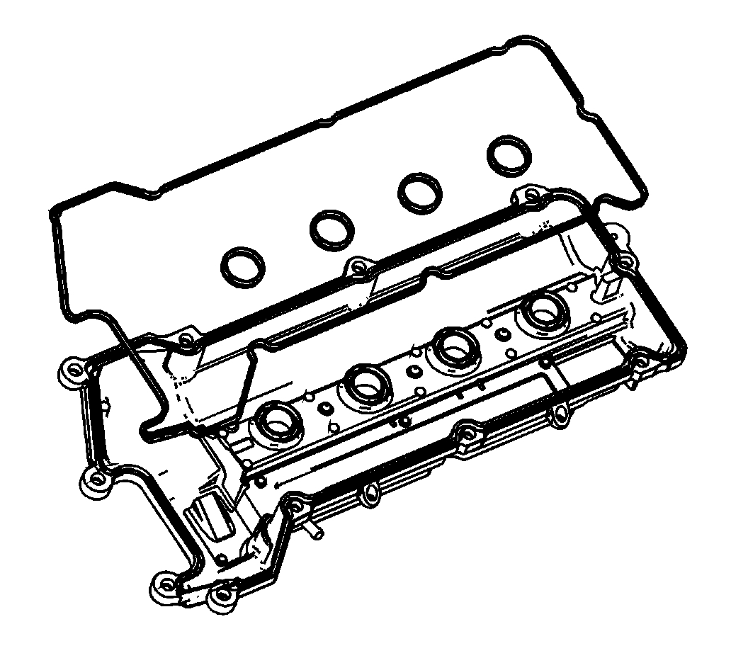

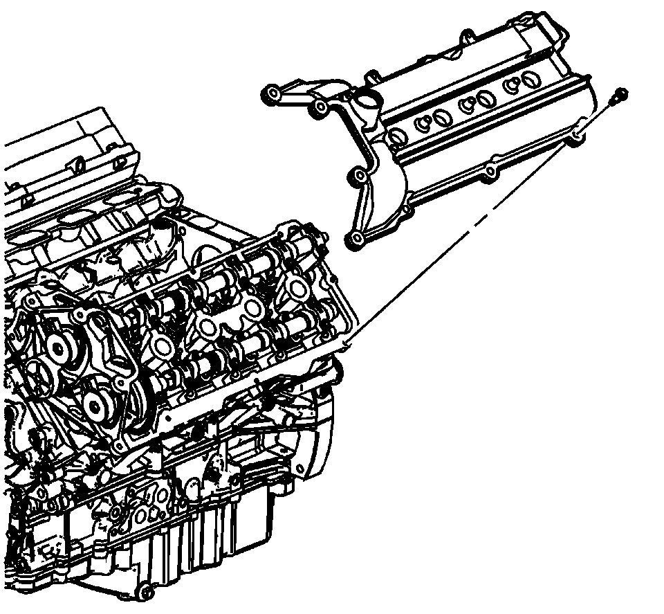

Regardless, here are the directions for replacing the valve cover gaskets. There are three separate sets of directions. The first and second show how the valve cover and gaskets are removed. (left and right sides are separate) The third show how to take apart the valve cover and replace the spark plug port seal.
_________________________________

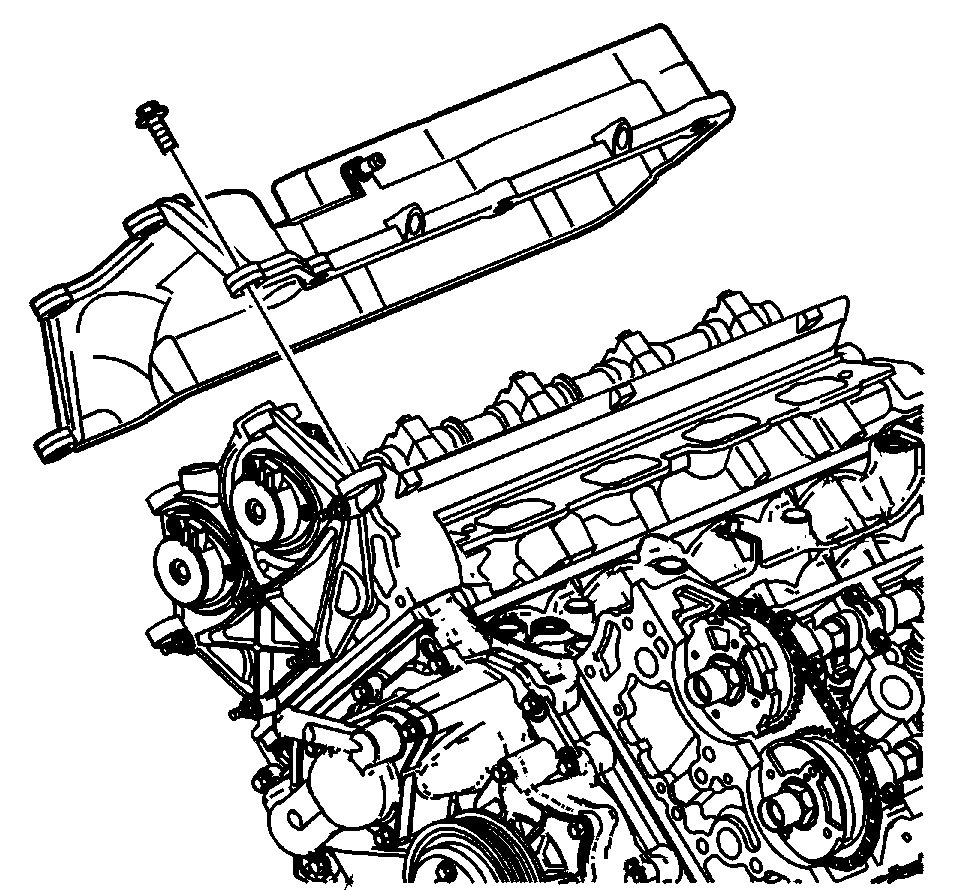

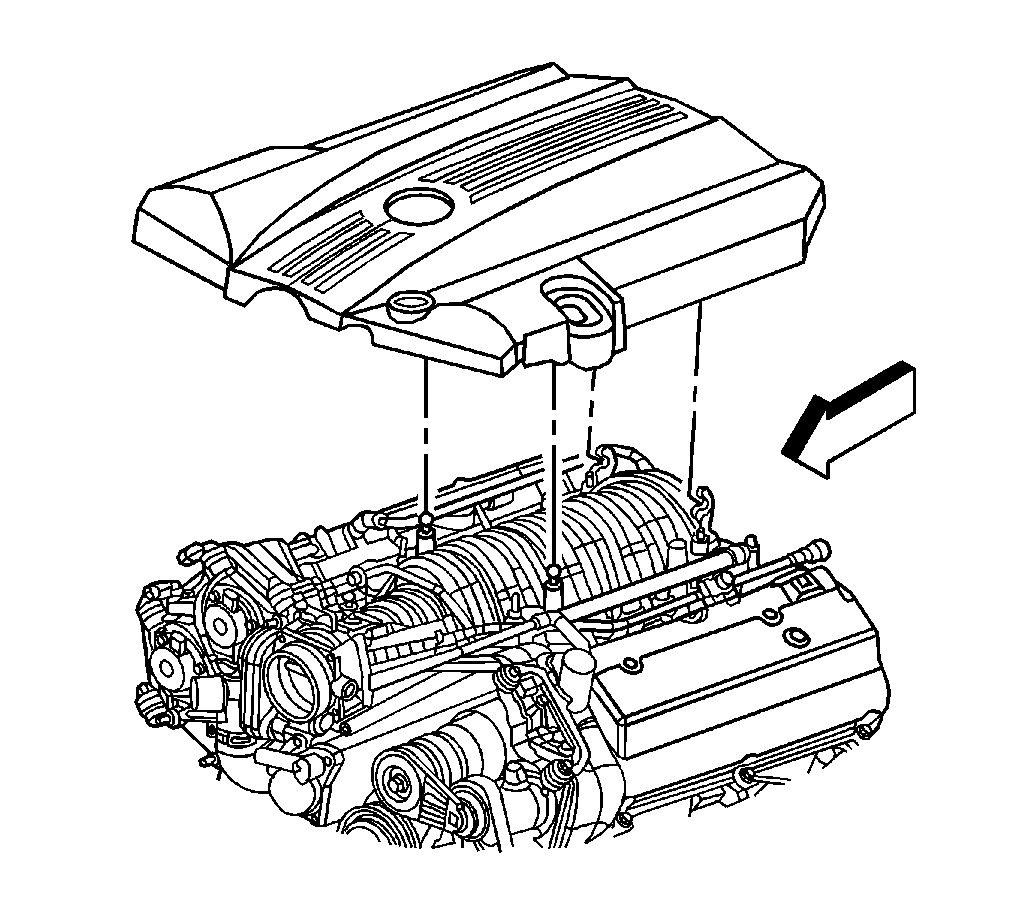

Camshaft Cover Replacement - Left Side The first 7 pictures correlate to these directions.
Removal Procedure
1. Remove the fuel injector sight shield. Refer to Fuel Injector Sight Shield Replacement (See: Fuel Injector > Removal and Replacement) .
2. Disconnect the positive crankcase ventilation (PCV) fresh air tube from the left camshaft cover.
3. Remove the bank 2 ignition coils. Refer to Ignition Coil Replacement - Bank 2 (See: Ignition Coil > Removal and Replacement) .
4. Remove the bolt connecting the ground strap to the left camshaft cover.
5. Remove the bolt securing the oil level indicator tube to the left cylinder head and reposition the tube away from the camshaft cover.
6. Remove the camshaft cover bolts.
7. Lift the camshaft drive end of the camshaft cover up.
8. Remove the camshaft cover.
9. Discard the camshaft cover gasket and spark plug port seals if there is any evidence of damage or if the seal comes out of the groove in the cover during removal.
10. Clean the gasket mating surface on the cylinder head.
11. Clean and inspect the camshaft cover.

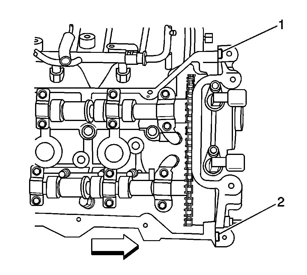

Installation Procedure

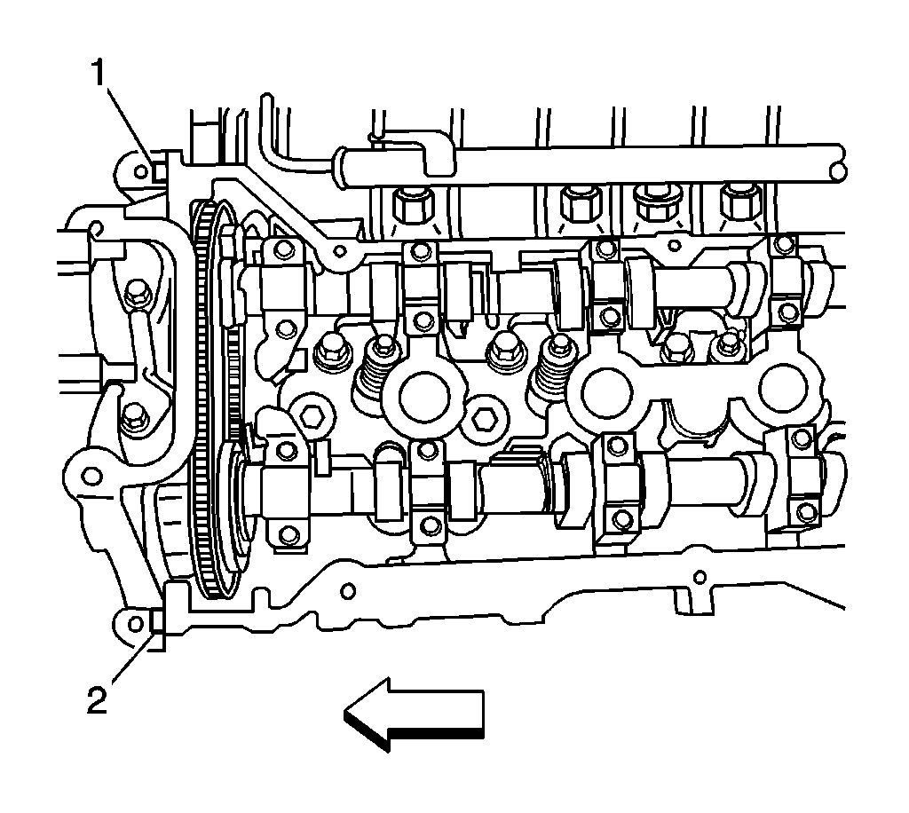

1. Install a new camshaft cover gasket to the camshaft cover if necessary.

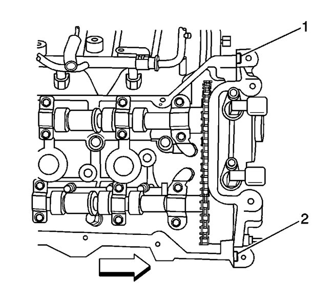

2. Place a small amount of sealant at the split line (1, 2) of the left cylinder head and the left camshaft position actuator housing. Refer to Adhesives, Fluids, Lubricants, and Sealers (See: Engine > Mechanical) .
Important: Be careful to prevent the exposed section of the camshaft cover gasket from being damaged by the edge of the cylinder head casting.
3. Work the camshaft cover into position by pivoting the cover down and aligning the bolt holes.
Notice: Refer to Fastener Notice (See: Vehicle > Vehicle Damage Warnings > Fastener Notice) .
4. Install the camshaft cover bolts.
Tighten the bolts to 10 N.m (89 lb in).
5. Install the bolt connecting the left camshaft cover ground strap to the left camshaft cover.
Tighten the bolt to 10 N.m (89 lb in).
6. Rotate the oil level indicator tube back into its original position and install the bolt securing the tube to the cylinder head.
7. Install the bank 2 ignition coils. Refer to Ignition Coil Replacement - Bank 2 (See: Ignition Coil > Removal and Replacement) .
8. Connect the PCV fresh air tube to the left camshaft cover.
9. Install the fuel injector sight shield. Refer to Fuel Injector Sight Shield Replacement

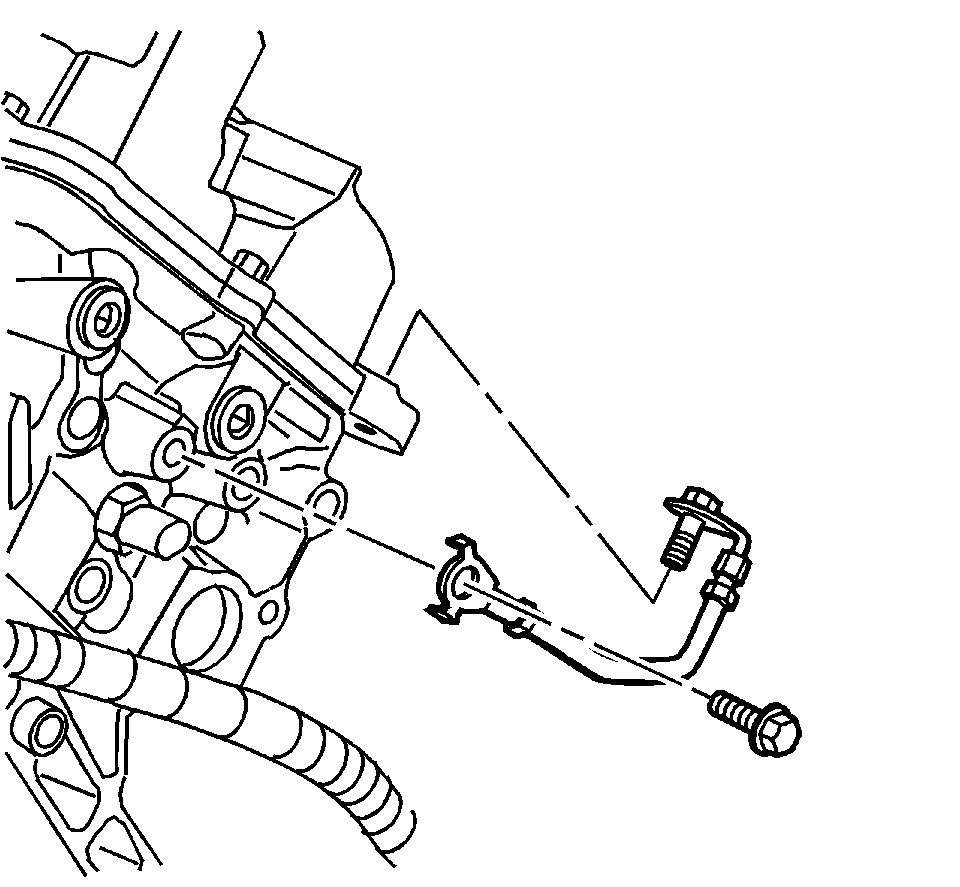

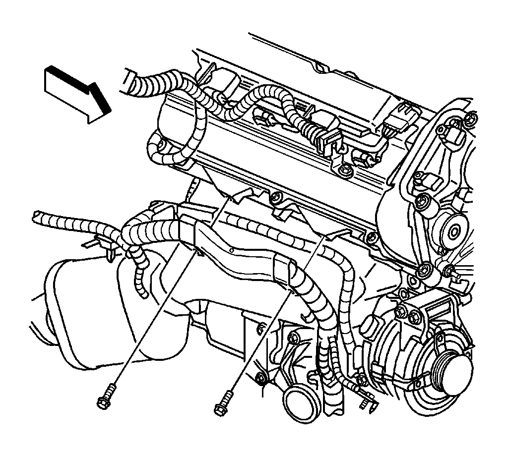

Right side (pictures 8 to 23 correlate with these directions)
Camshaft Cover Replacement - Right Side
Removal Procedure
2. Disconnect the positive crankcase ventilation (PCV) dirty air tube from the camshaft cover.

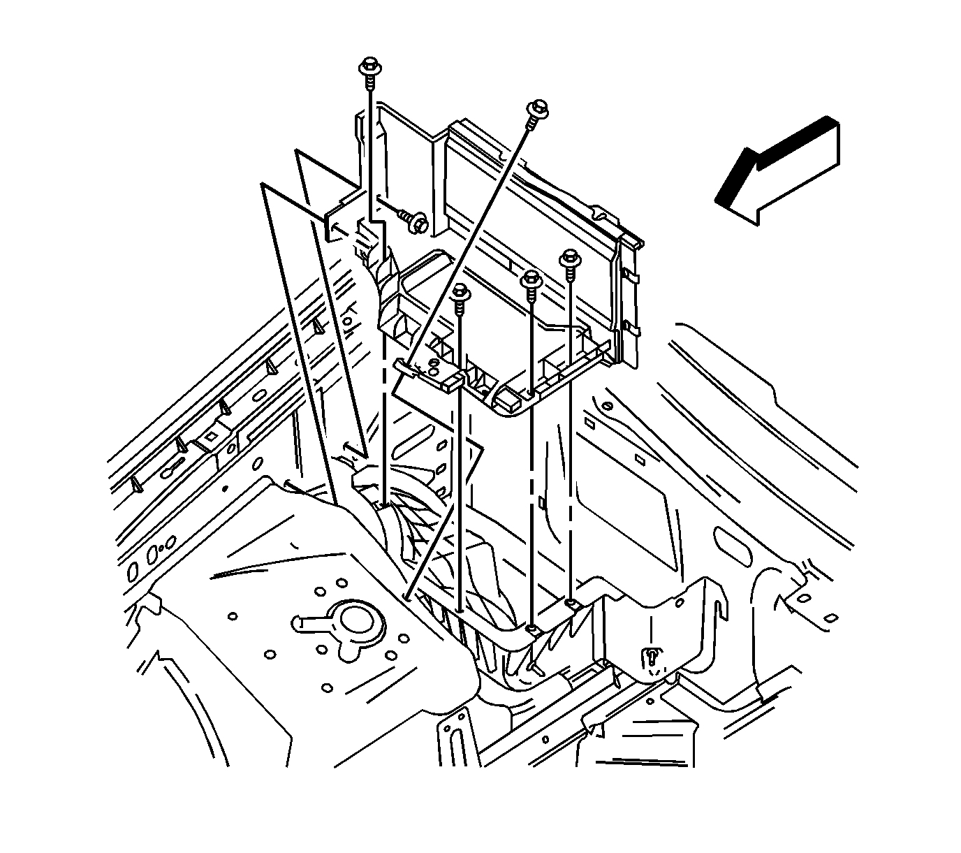

3. Remove the front air inlet housing panel. Refer to Air Inlet Housing Front Panel Replacement (See: Air Duct > Removal and Replacement > Air Inlet Housing Front Panel Replacement) .
4. Remove the battery tray. Refer to Battery Tray Replacement (See: Battery Tray > Removal and Replacement > Battery Tray Replacement) .
5. Raise the vehicle. Refer to Lifting and Jacking the Vehicle (See: Maintenance > Service Intervals) .
6. Remove the front air deflector. Refer to Front Air Deflector Replacement (See: Air Dam > Removal and Replacement > Front Air Deflector Replacement) .
7. Remove the bolts securing the wire harness bracket to the cylinder head.
8. Lower the vehicle.
9. Remove the bank 1 ignition coils. Refer to Ignition Coil Replacement - Bank 1 (See: Ignition Coil > Removal and Replacement) .
10. Disconnect the cable harness clips at the front of the camshaft cover and position the cable harness aside.
11. Remove the bolt connecting the ground strap to the right camshaft cover.
12. Remove the camshaft cover bolts.
13. Remove the camshaft cover.
14. Discard the camshaft cover gasket and spark plug port seals if there is any evidence of damage or if the seal comes out of the groove in the cover during removal.
15. Clean and inspect the camshaft cover. Refer to Camshaft Cover Cleaning and Inspection () .
Important: Be careful to prevent the exposed section of the camshaft cover seal from being damaged by the edge of the cylinder head casting.
1. Install the camshaft cover gasket as required.
2. Place a small amount of sealant at the split line (1, 2) of the right cylinder head and the right camshaft position actuator housing. Refer to Adhesives, Fluids, Lubricants, and Sealers (See: Engine > Mechanical) .
3. Install the camshaft cover.
4. Install the camshaft cover bolts installing the ground strap to the camshaft cover.
5. Install the bank 1 ignition coils . Refer to Ignition Coil Replacement - Bank 1 (See: Ignition Coil > Removal and Replacement) .
6. Connect the cable harness clips to the front of the camshaft cover.
7. Raise the vehicle. Refer to Lifting and Jacking the Vehicle (See: Maintenance > Service Intervals) .
8. Install the bolts securing the wire harness bracket to the cylinder head.
Tighten the bolts to 45 N.m (33 lb ft).
9. Install the front air deflector. Refer to Front Air Deflector Replacement (See: Air Dam > Removal and Replacement > Front Air Deflector Replacement) .
10. Lower the vehicle.
11. Install the battery tray. Refer to Battery Tray Replacement (See: Battery Tray > Removal and Replacement > Battery Tray Replacement) .
12. Install the front air inlet housing panel. Refer to Air Inlet Housing Front Panel Replacement (See: Air Duct > Removal and Replacement > Air Inlet Housing Front Panel 13. Connect the PCV dirty air tube to the camshaft cover.
14. Install the fuel injector sight shield. Refer to Fuel Injector Sight Shield Replacement (See: Fuel Injector > Removal and Replacement) .

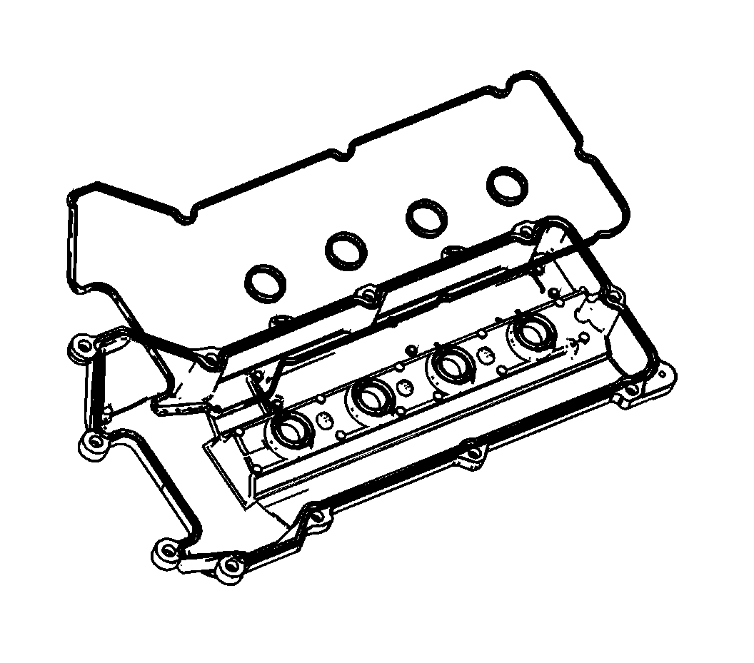

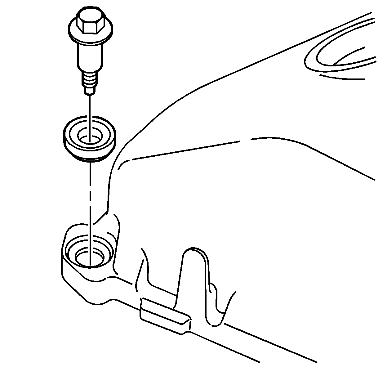

Valve cover disassembly ( the last three pictures correlate with these directions)
84. CAMSHAFT COVER DISASSEMBLE
Camshaft Cover Disassemble
1. Remove the left camshaft cover gasket and discard.
2. Remove the left spark plug port seals and discard.
3. Remove the right camshaft cover gasket and discard.
5. Remove the camshaft cover bolts.
6. Remove the camshaft cover bolt grommets.
_____________________________________________________________________________________
