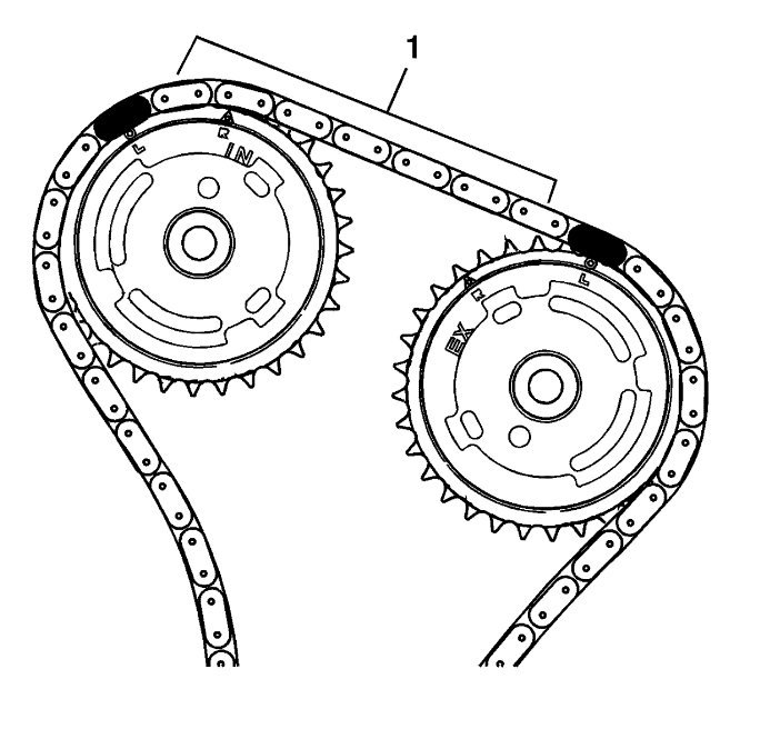

I just did a timing chain on on my car, changed water pump, oil pump, thermostat, new belts, chains, tensioners, sprockets. I put it all back together and it cranks slow n a noise as if a chain is loose plus when is cracking sounds like a low backfire. I aligned all timing marks on the chains but not sure on crankshaft n one side of both side chains felt really loose! Help how to set timing now that is really out of timing?
Mar 4, 2017 at 6:40 AM
  • 55,849 POSTS
Hey JUANCA,

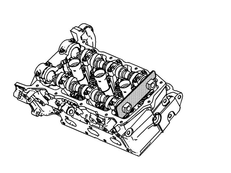

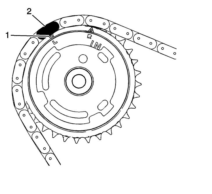

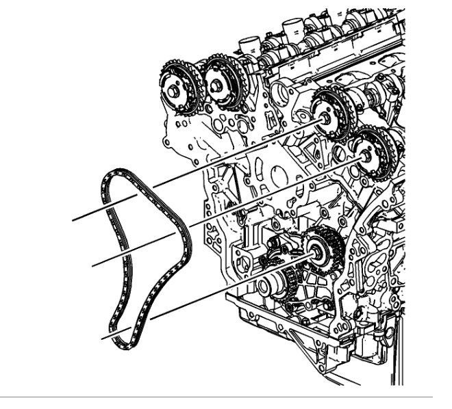

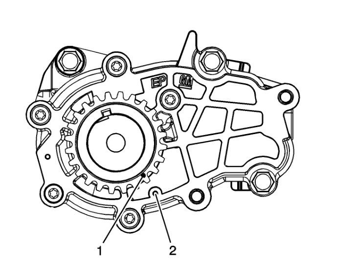

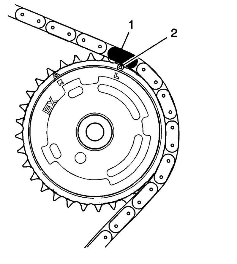

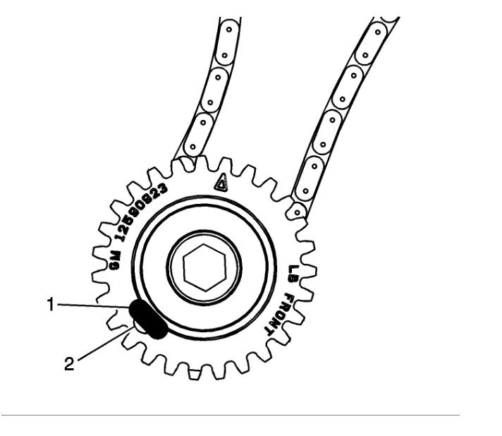

It sounds like you got the chains out of time. This is a vary involved job here are some diagrams to help you put you will need a special tool to hold the camshafts in place.
http://www.alldatapro.com or http://www1.prodemand.com has instructions on how to do the job.
Best, Ken
