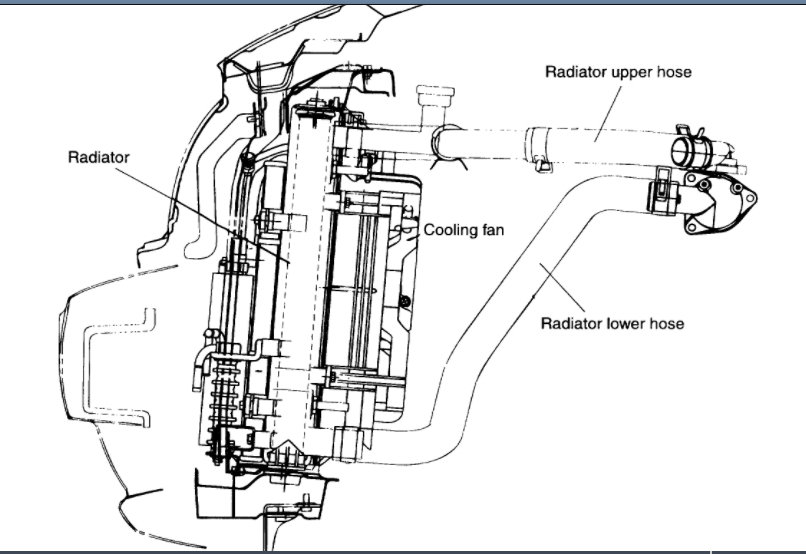

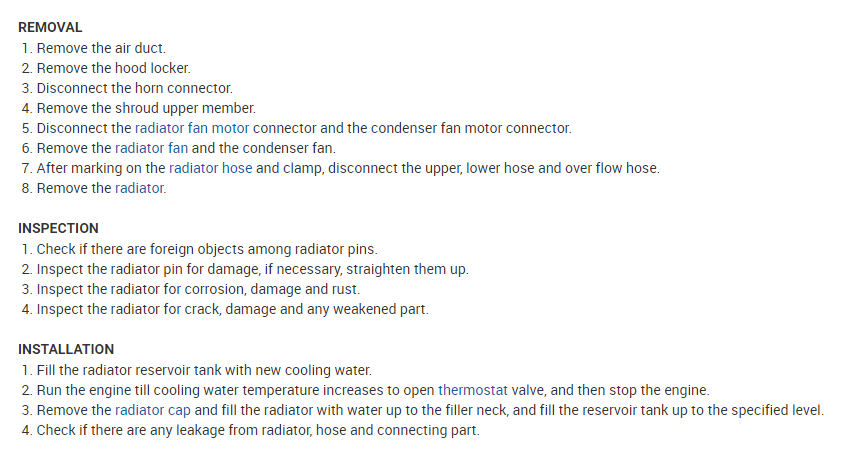

Trying to figure out what the part is called that the upper and lower radiator hoses hook to?
Jul 9, 2021 at 7:22 PM
DANNY L
  • 5,648 POSTS
Hello, I'm Danny.
Here is the information you requested. Here is a tutorial showing how to replace radiator hoses:
https://www.2carpros.com/articles/replace-radiator-hoses
I've attached a diagram below showing the radiator hose locations and replacement steps for your Kia. Hope this helps and thanks for using 2CarPros.

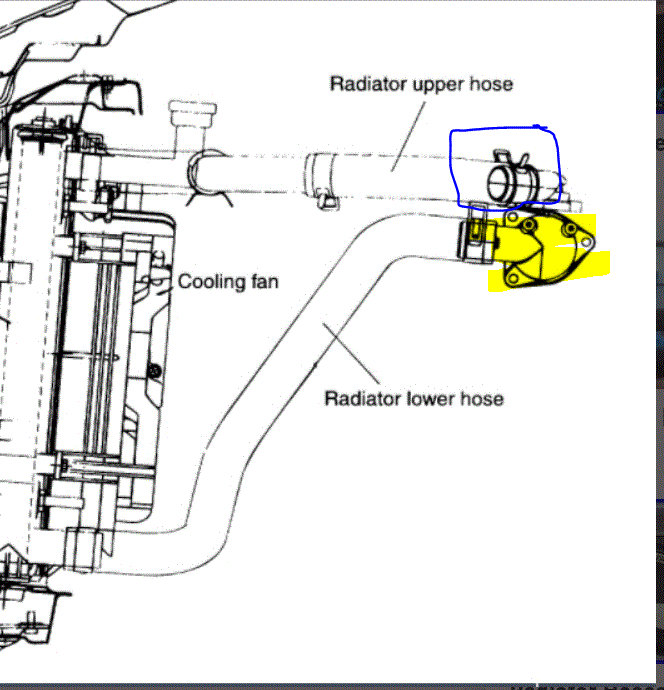

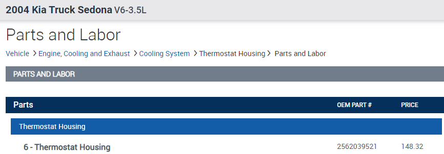

That is good, however I'm looking for name of part that the housings hook to.

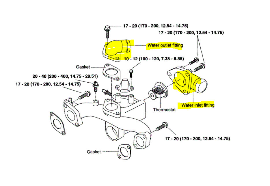

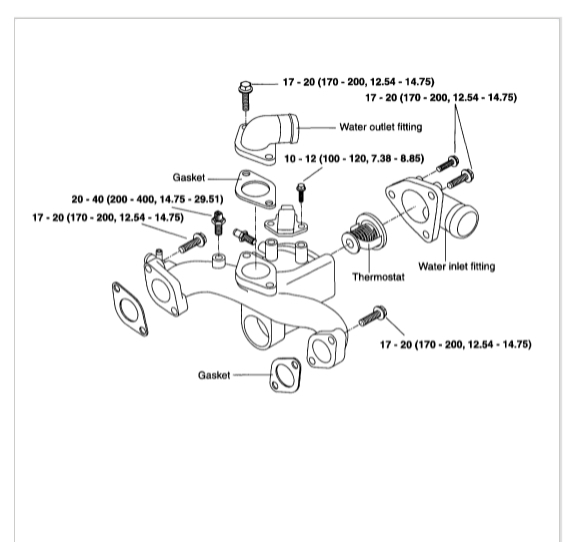

I'm not sure if you made progress on this. it has been a couple of days since we heard from you. Regardless, the housings you referred to are the thermostat housing and the water outlet housing.
I attached two pics below to help you identify them.
I hope this helps. Let me know if you have other questions or if there is something I can do to help.

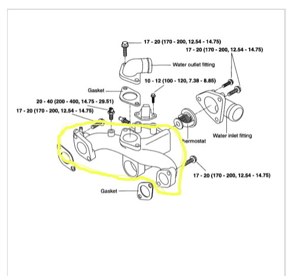

Maybe I am not being clear, I am looking to find out the name of this part.
Jul 13, 2021 at 8:24 AM
  • 110,194 POSTS

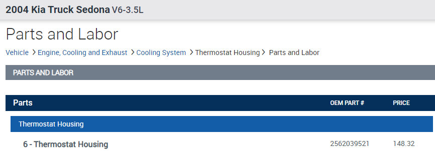

That entire assembly is called the thermostat housing. I call it a crossover pipe, but Kia calls it a thermostat housing. The OEM part number is 25620-39521.
Look up "Kia part number 25620-39521" and you'll find it. That is the exact part number for the vehicle listed above.
Let me know if that helps.
Jul 13, 2021 at 9:26 PM
DANNY L
  • 5,648 POSTS
Hello again.
That is called the thermostat housing. The thermostat and water outlet attach to the assembly. I've attached the factory Kia part number and price below. Hope this helps and let us know if you have any further questions about this. Thanks again for using 2CarPros.
