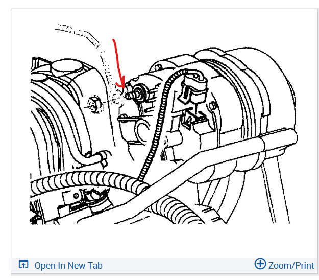

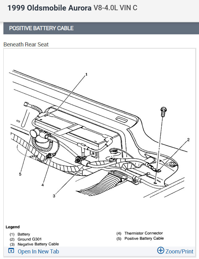

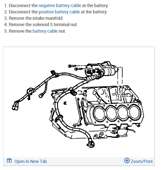

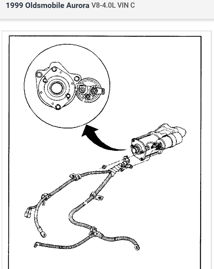

Can you please shoot a quick video with your phone so I can hear the noise? That way I can tell for sure what's going on. You can upload it here with your response. It sounds like the starter motor is bad and/or the positive battery cable needs to be replaced. Also, make sure the battery connection are clean and tight.
Here is a guide to help:
Here is the starter location and how to change the positive battery cable out as well. Unfortunately, the starter is under the intake manifold. :/ disconnect the battery before you begin. Check out the images (below). Please let us know what happens.
